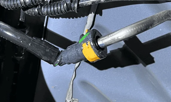

Your pics are good, but we have no idea where the fuel line damage is, it is not apparent in the photos
They are the photos sent by the mechanic. So it is fortunate I don’t need a diagnosis at this point. I would like my truck back, though.

A competent mechanic/dealership would order the replacement parts and do a temporary repair of the fuel leak with flexible fuel injection hose and send you on your way. They would note on your invoice that it is a temporary but safe fix and that you would need to return for the OEM repair when the parts arrive. This would save them them cost of rental reimbursement and save you hassle of being without a car and having to chase down reimbursement.
It would be win-win for both parties, but there is probably some corporate legal liability BS that prevents them from doing it, or at least that's what they will likely tell you.
Its worth a shot to ask though.
This is what I would do. Fuel lines are nothing new. It used to be that a mechanic would make a new one if needed, but we don't have those anymore due to progress. Instead we park the vehicle for a few months until someone in Mexico can bend and flare some tubing.

OK here's what I would do - I have listed a few salvage yards that have wrecked Hybrid Mavericks. Call and get the line - much cheaper and faster -

The mechanic clearly isnt a mechanic, they are nothing more than a parts changer. I deal with this every day in my line of work. Its a simple fix for someone with the proper tooling. You can see the fuel leaking from either the fitting or line. One is repairable and the other is replaceable. Hour fix tops.
100% correct - there are plenty of fuel line repair kits that splice in. Sadly the truck is at a Stealership and not a real repair shop.
Dorman Fuel Line Repair Kit From Advanced Auto

Direct injection engines run higher fuel pressure. How much pressure is in this line?

After market skid plates will be popular once someone starts selling them. They really don't need to be very heavy-duty to stop something like this.
I know the fabric covers are 100% recycled material and that is why Ford uses them but I think we would be better off with the traditional plastic covers.
My brother added skid plates to his Toyota, big heavy steel ones. Now I don't want to give up my MPG or lower the payload much like his skid plates that weigh hundreds of pounds will. But there has to be something in between no protection and turning your vehicle into an armored rock crawler truck.
I have had luck in the past with getting parts from salvage yards to fix vehicles. Always with older vehicles out of warranty but there seems to be few options right now.
