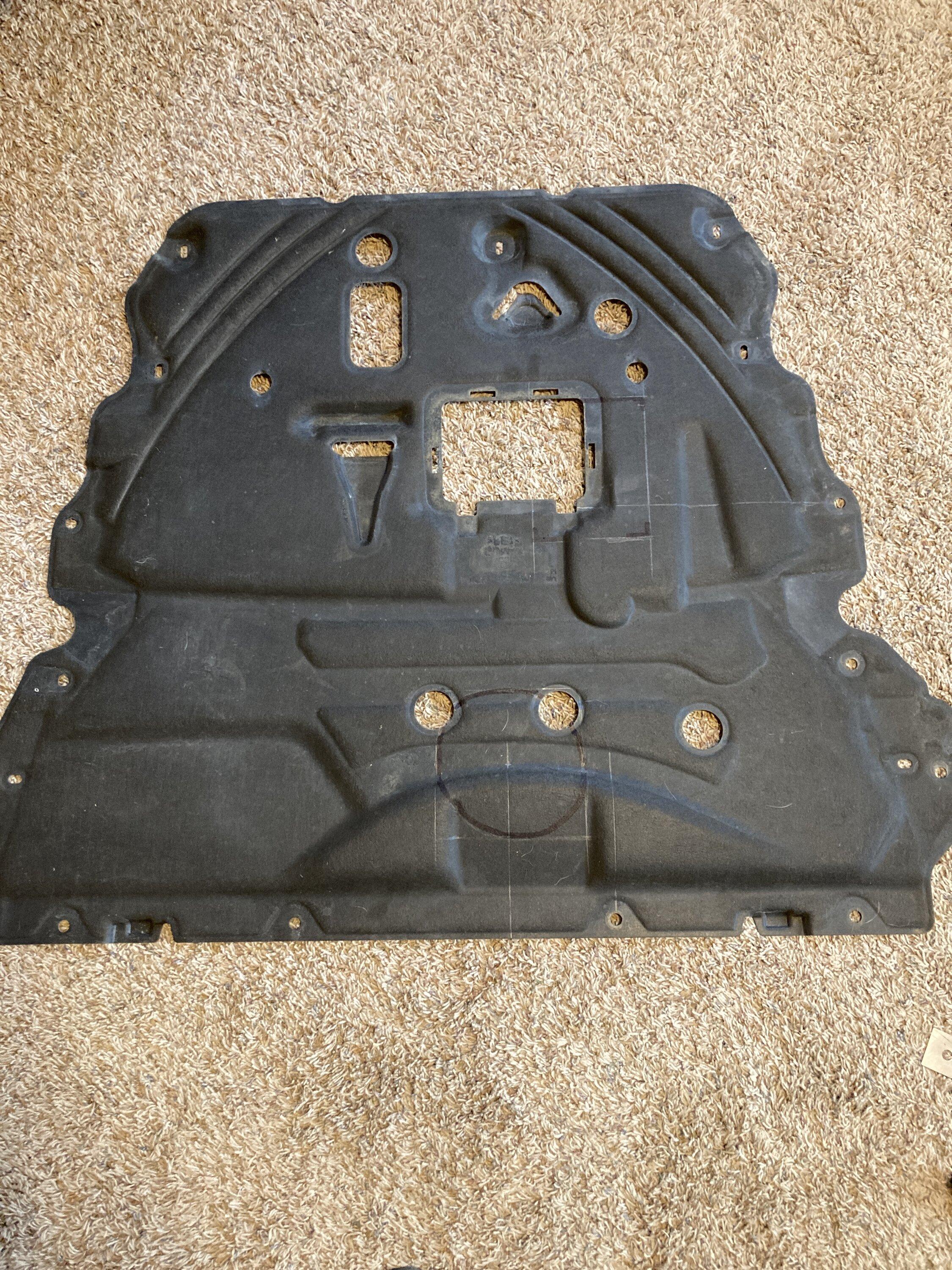

I have that saved, lol. But my shield looks different? Has a large square hole cut already? I have two thumb turn cam locks I’m hoping will work
And I have hybrid. Cam locks won’t be here till Tuesday, I measured oil filter location, and it looks same as pic from thingyverse. My panel missing large part near drain plug is goin to mean just removing more of the panel, not sure how my foot plan is going to work with material missing. Almost ready to cut

been married A LONG TIME................and she wasn't home when I did it........it worked out for the most part and now I have 3d printed covers for both areas, but the LARGE opening caused issues with that cover working, so it's just open for now where the oil can be drained.
