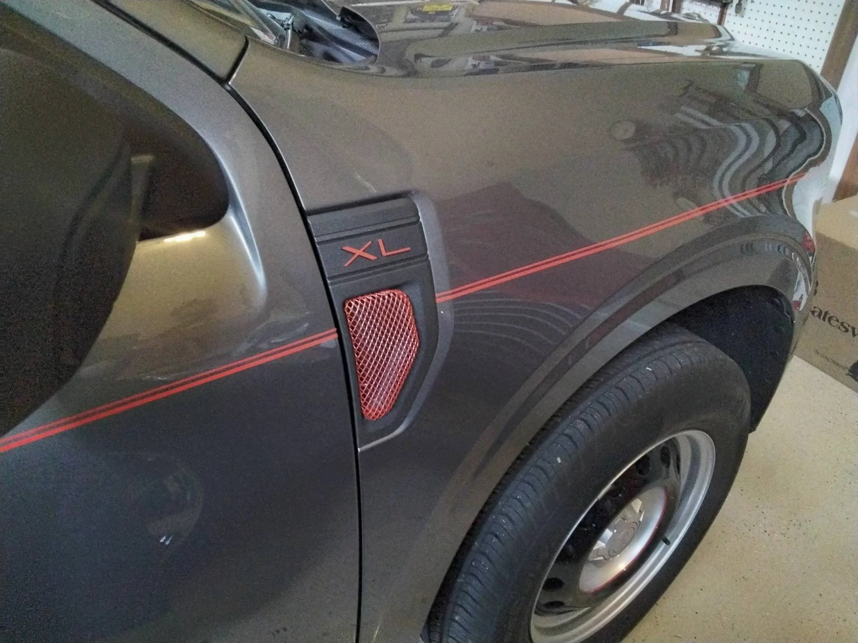

These are both OEM fender vents, not printed. For V1.0, I used a grinder with a flap wheel to remove the "block-off panel" from the backside, then fitted a piece of aluminum hex mesh that I found on Amazon. Once color-matched, I glued the mesh to the backside with J-B Weld Plastic Bond.
For V2.0, I opened them up to the first "ridge" to give them a bit more "open" area. I roughed them in with a Dremel and a cutoff wheel, then finished with the grinder and flap wheel, fit a new aluminum insert, and glued with J-B Weld Plastic Bond.
Noice!!! Good old fashioned ' tooling on original parts ' . Love it!. Thanks for showing your work. I am inspired now.
