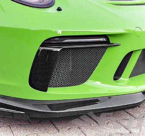

Great idea and execution! I have something very similar on my C8 to protect the front coolers and people use almost the exact product for 911 GT3's....
Ford Maverick Custom lower bumper grille insert I added to my 2024 911 grill insert.JPG
Ford Maverick Custom lower bumper grille insert I added to my 2024 C8 grill insert.JPG
So to all the folks warning of reduced cooling capacity...Noted. I highly doubt any perceptible degradation in performance would be noticed on the EB's and the debris protection would far outweigh that....IMO.

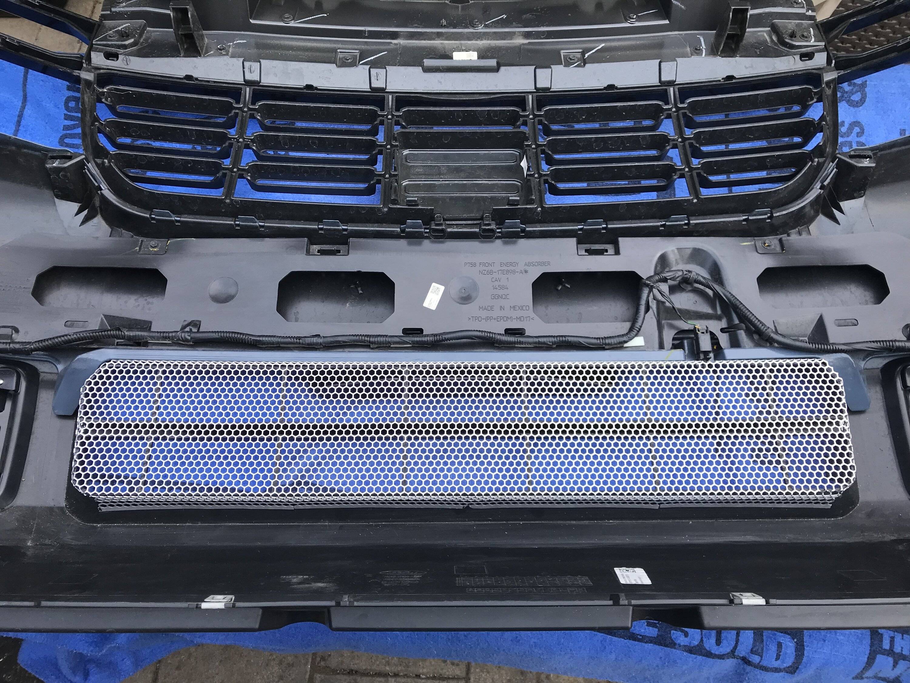

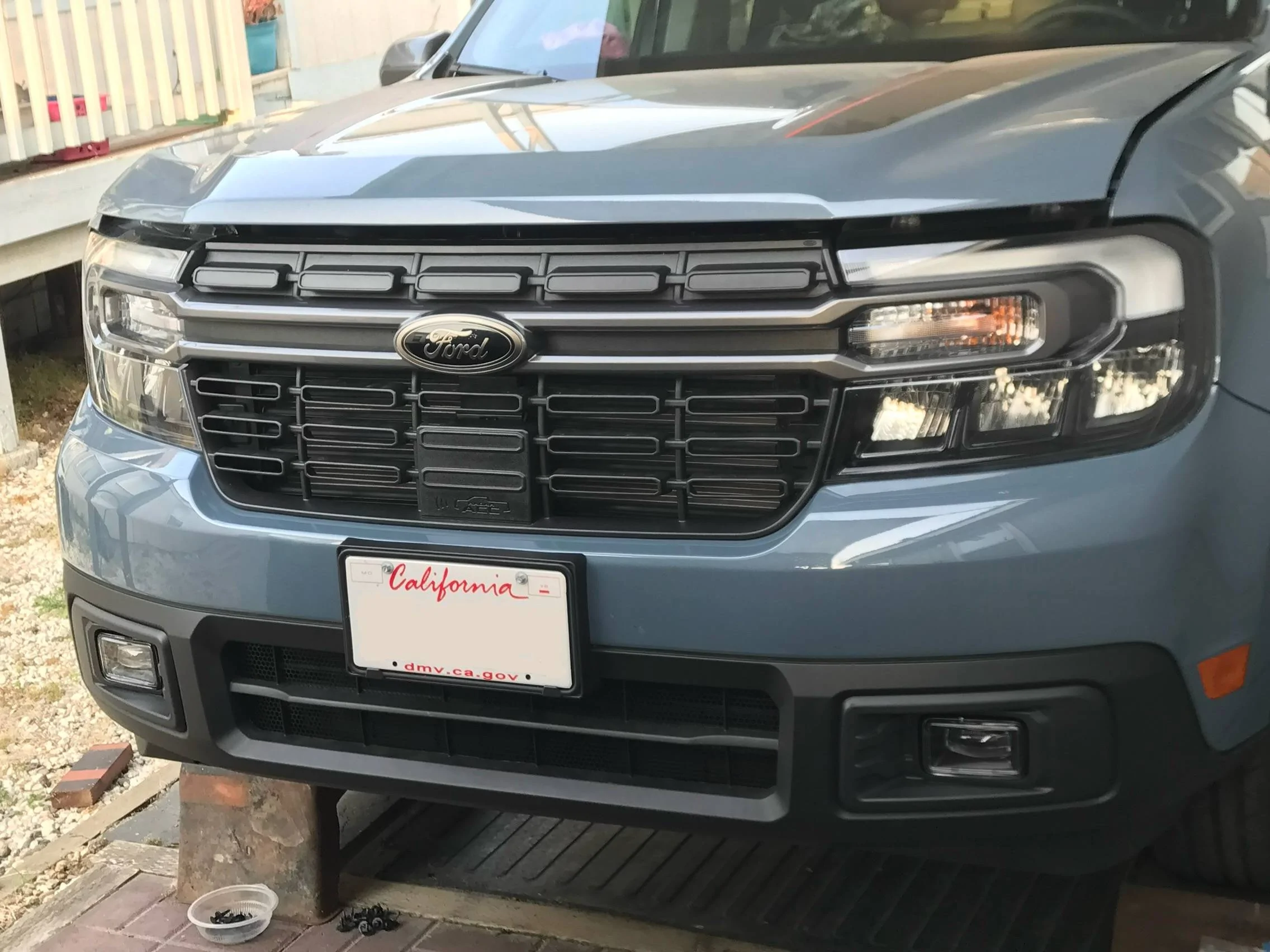

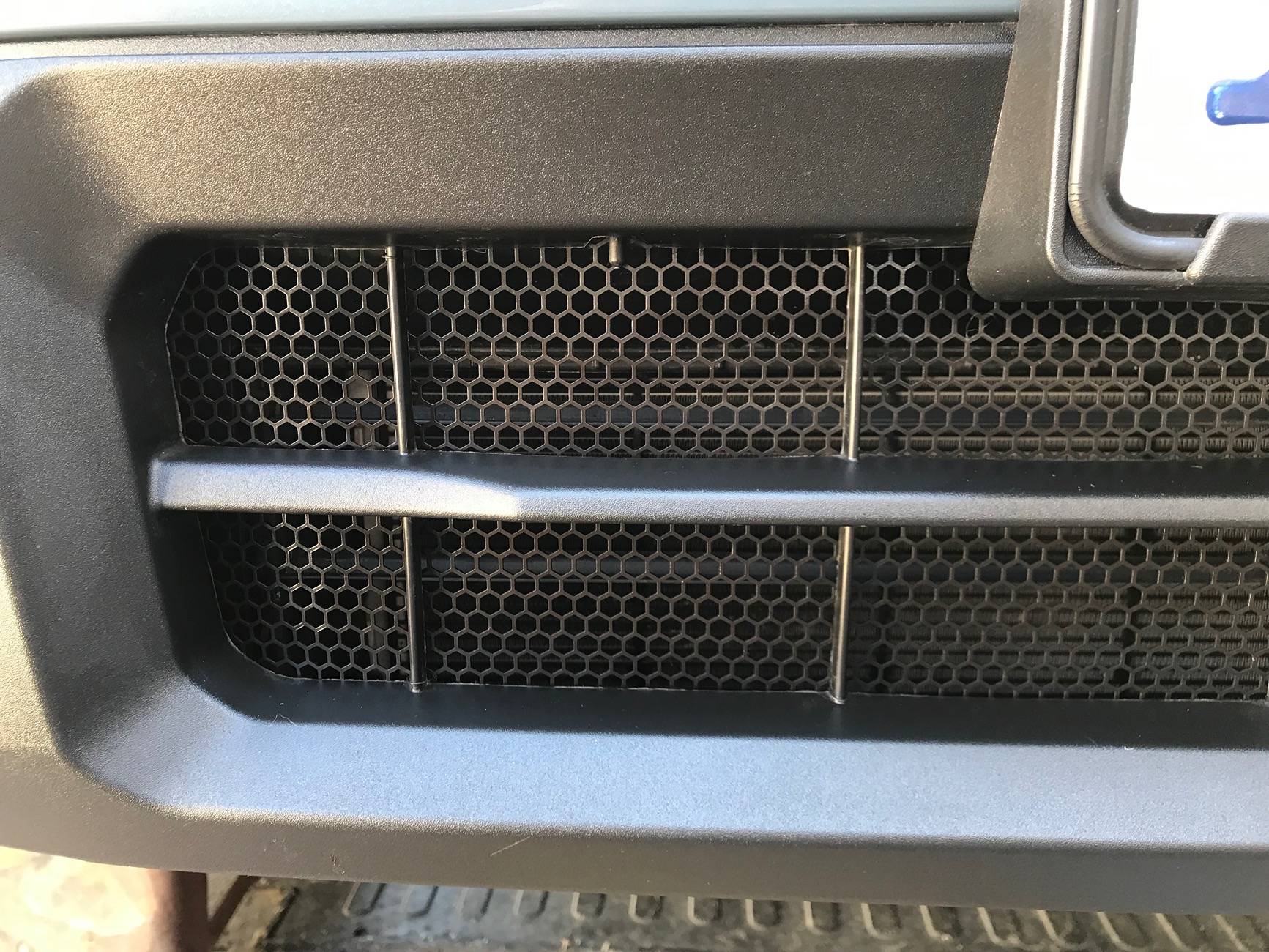

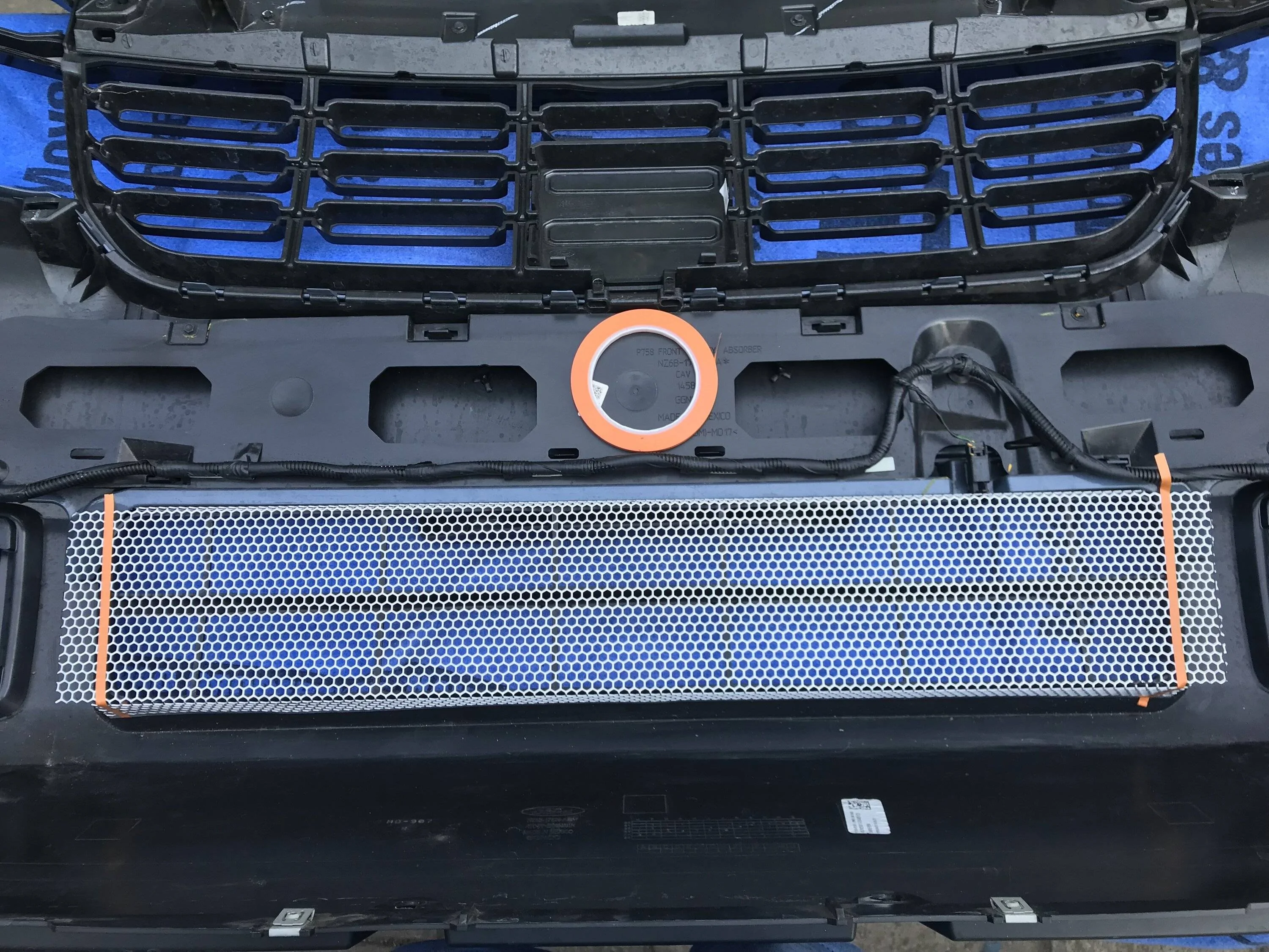

Did my DD Fog Light install this week and since I had the front bumper assembly off there was sever other things I wanted to address the bumper the horns and the backup alarm… First it was the large opening on the lower grill.. Have been considering what I could do to make it look better ever since buying the truck in May.. Well last month I came across this 6mm octagon aluminum mesh while searching the web for something to add to my fender badges… It looked like it would work perfect for the lower grill so I snagged some off of Amazon..

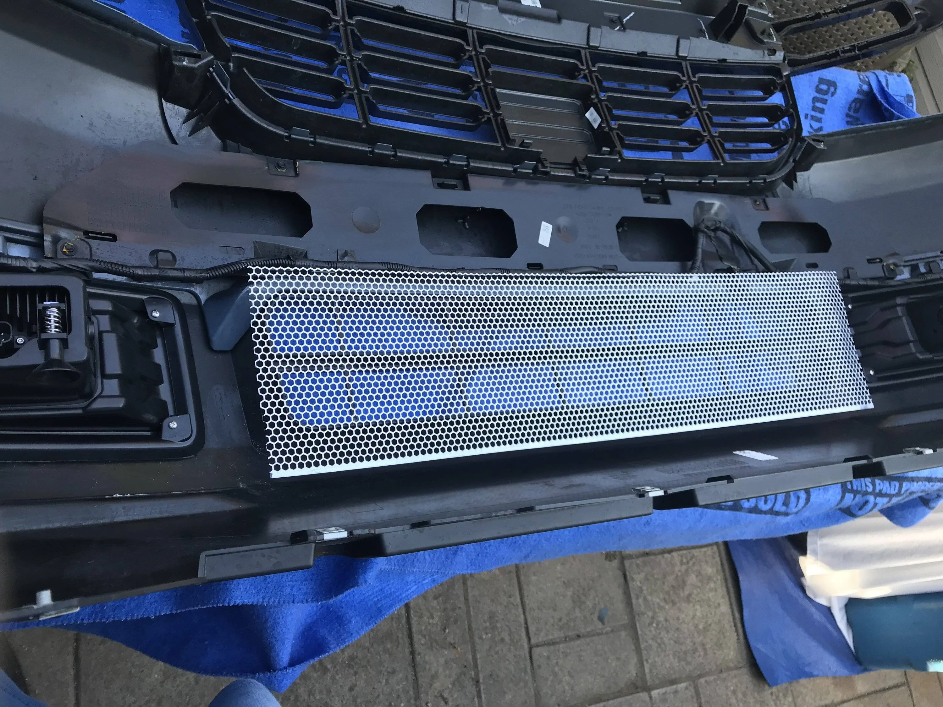

First I made some rough measurements and cut a piece to do some more detailed measurements and bends..
I put a bend in the upper portion then marked it and bent the lower…
Then it was onto the sides contouring it around the plastic opening… When I was happy with the fitment I then shot it with some black primer and then several coats of satin black paint…

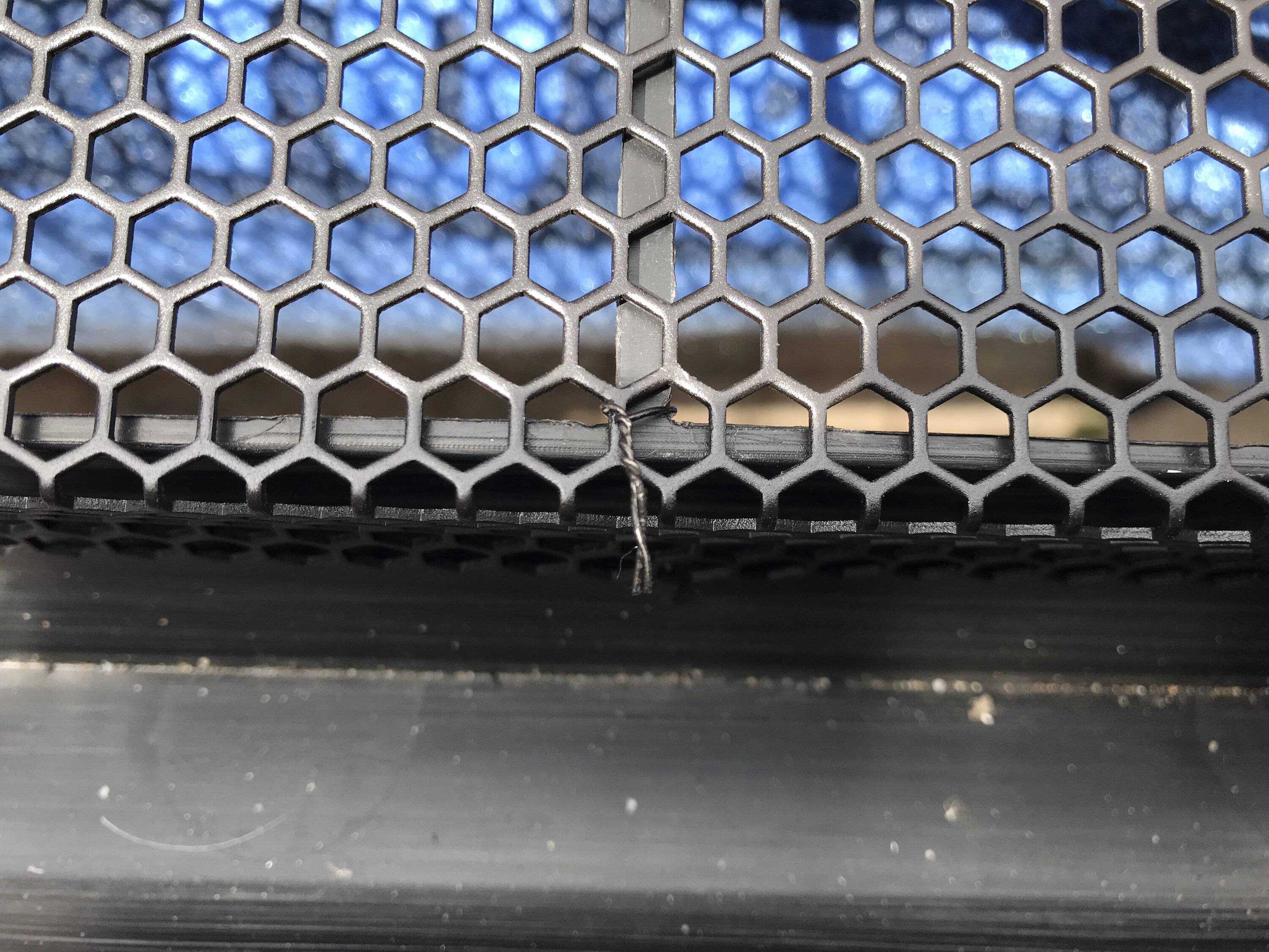

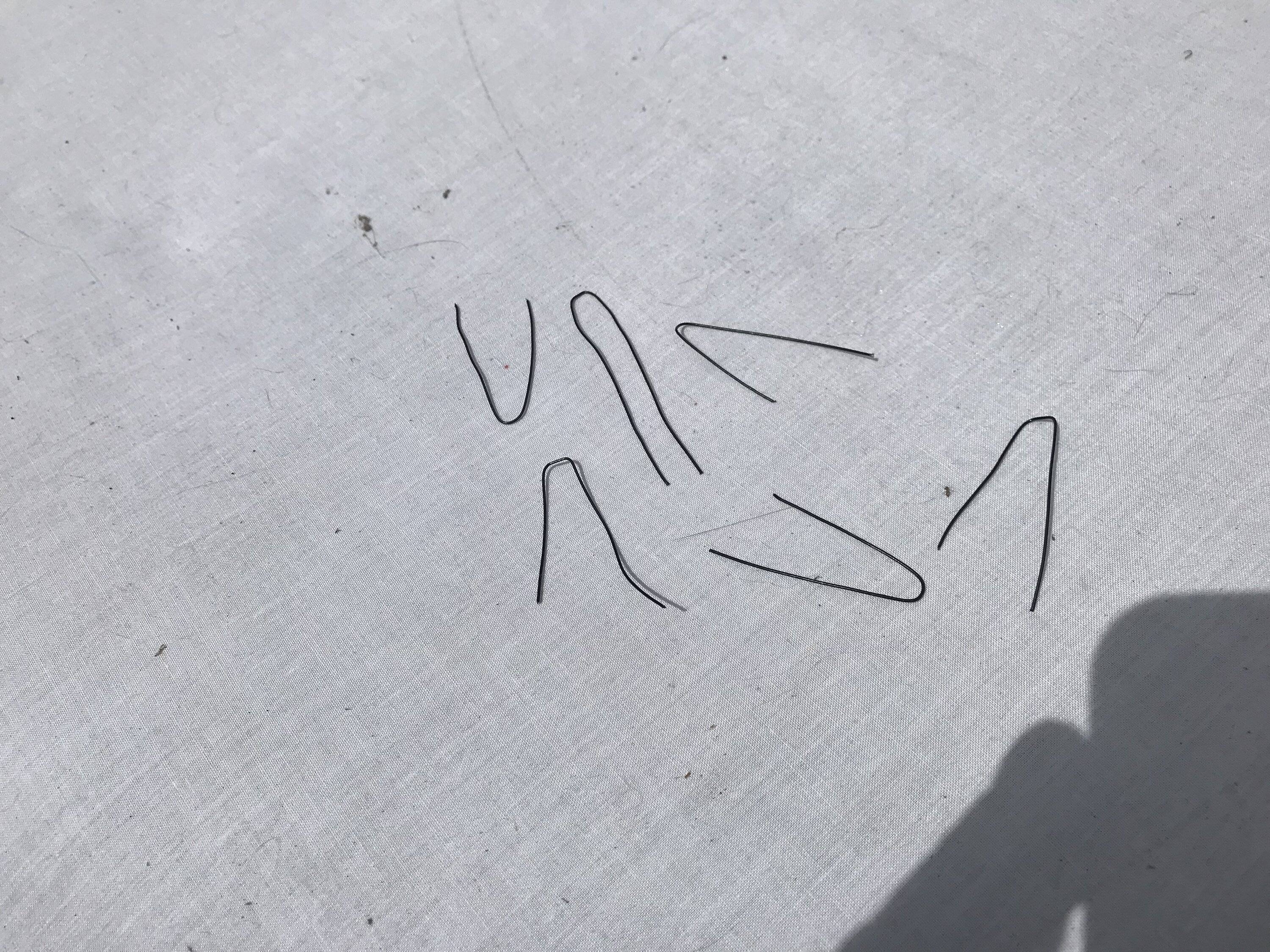

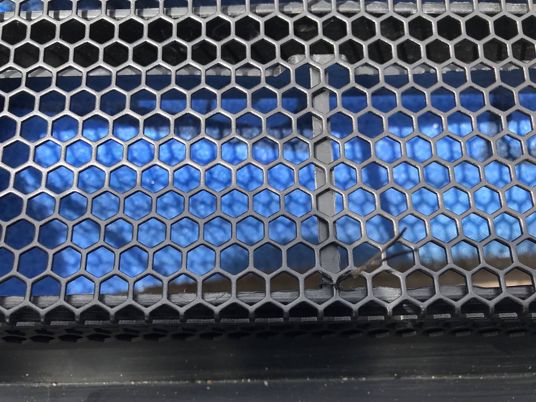

Now I just needed to figure out how to attach it, had several ideas… First thought was to pop rivet it in place but I didn’t really want to see the rivets… Then I thought why not use some thin safety wire and secure it to the vertical risers on the grill opening, unless you have your face up in my grill you’ll never even see them….
Cut and bent 8 of them hit them with some satin black paint…

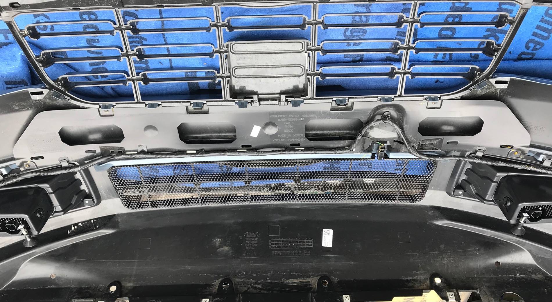

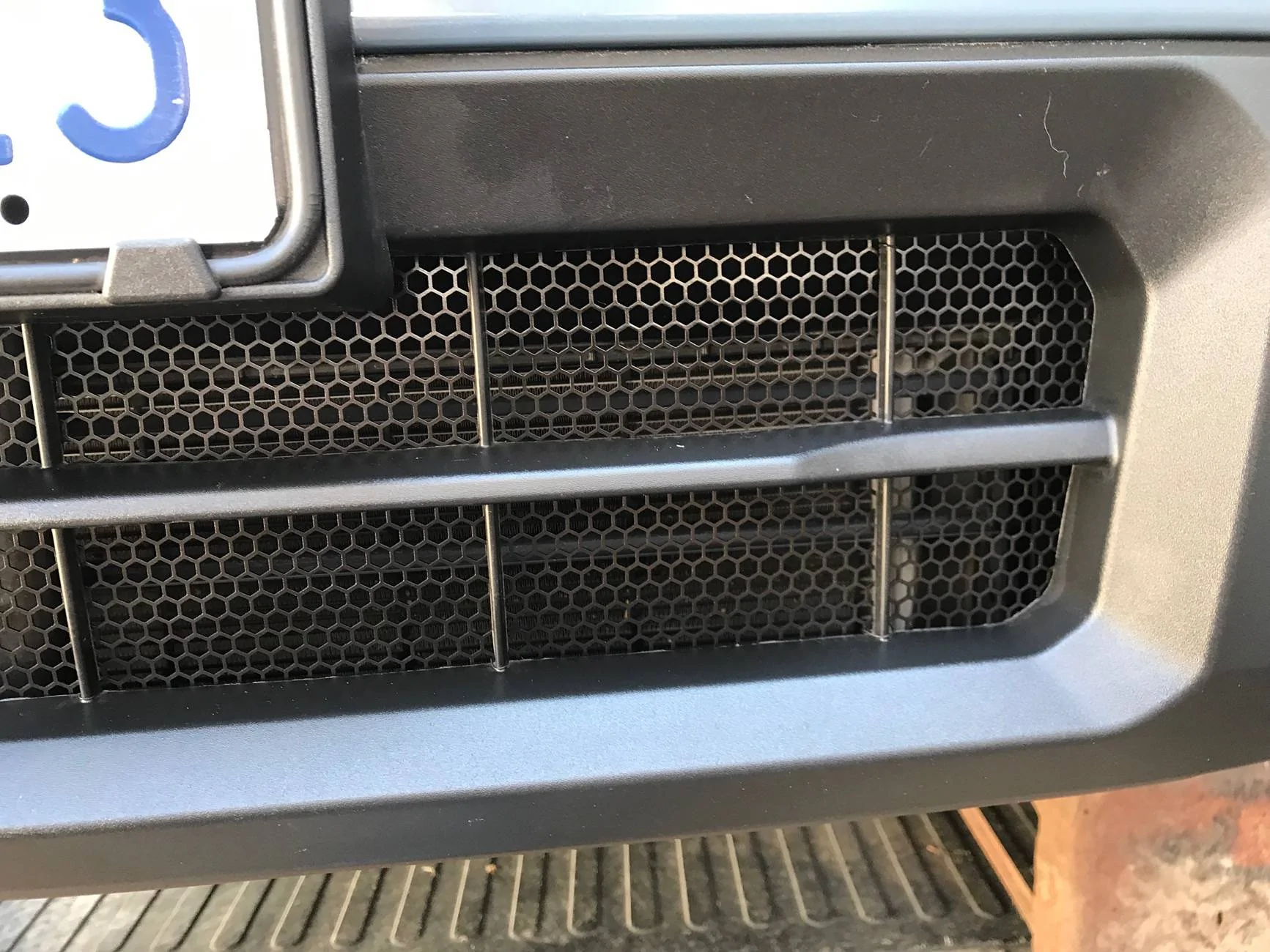

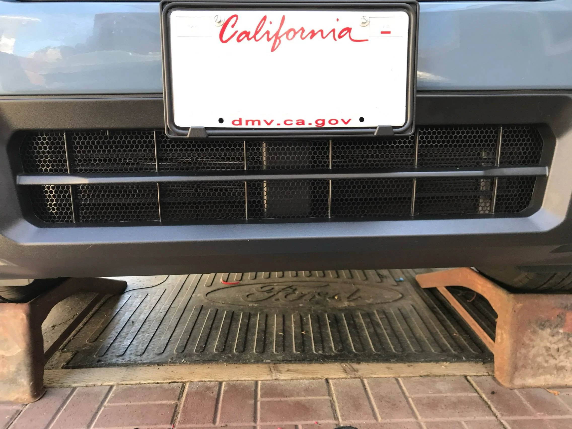

Installing it was just that easy just fished the wires from the front around the vertical riser and twisted them tight, trimmed the excess and tucked the wire out of harms way….
Installed ready to go back on the truck…
