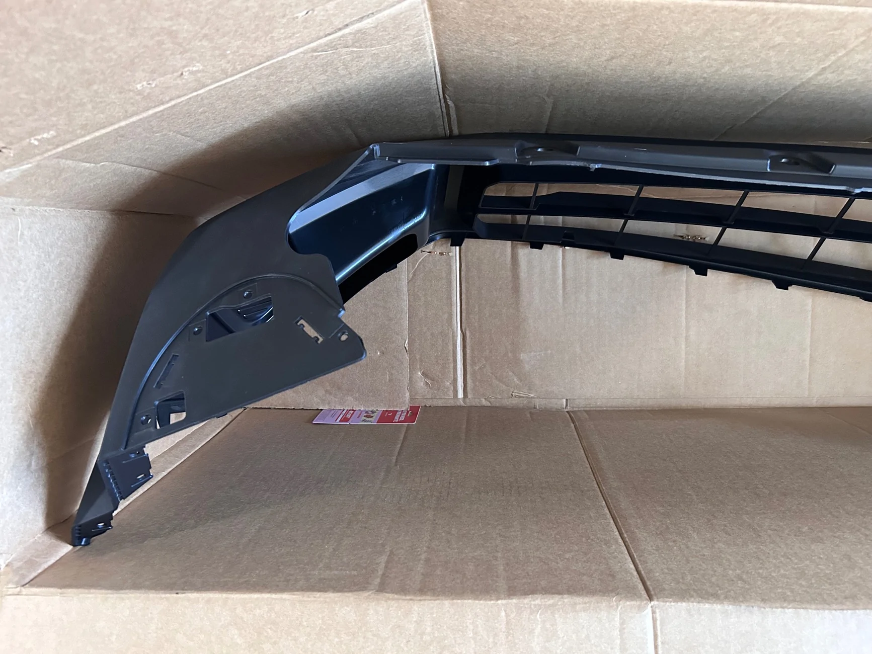

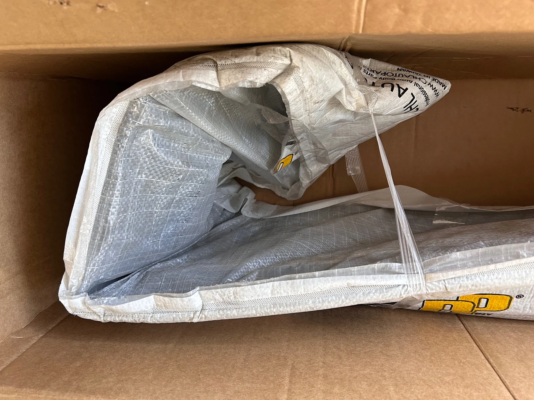

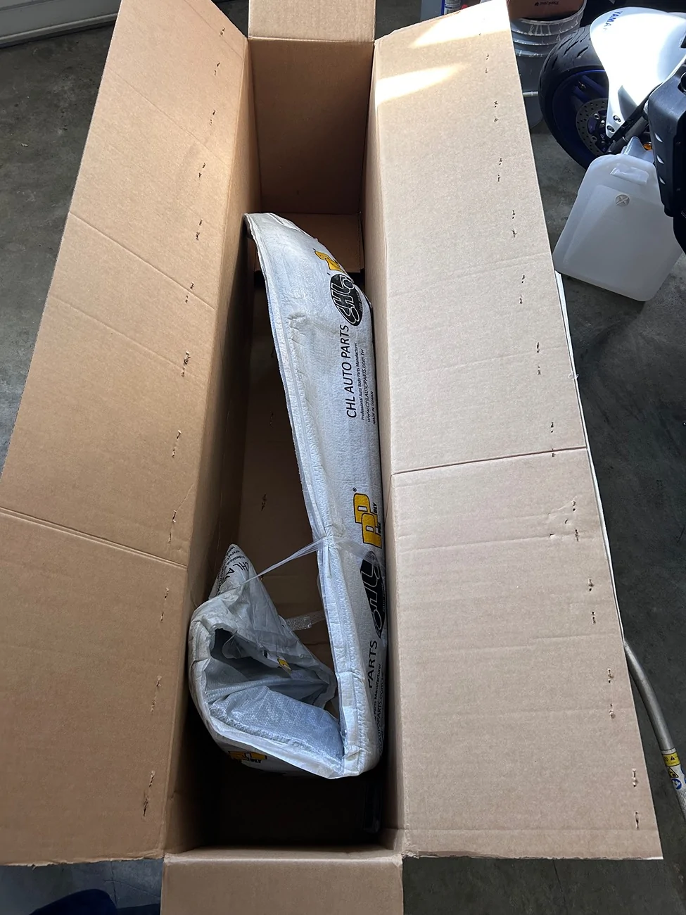

I’ve done bodywork for over 20 years and have had dozens of bumpers delivered like this. It’s pretty normal. Just sit it in the sun or somewhere warm for a day or 2 and it’ll go to its normal shape and be fine. In the winter we would put them in a paint booth with the heat on,
I talked to my buddy yesterday that has a body shop.he said the same thing put them in the sun and it will go back to its normal shape.

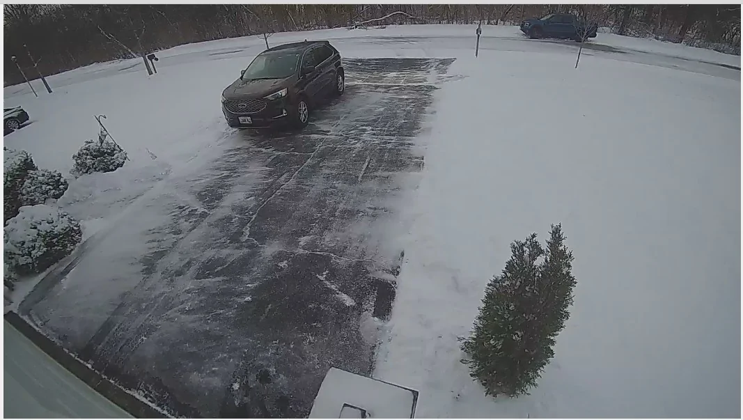

What is this "sun" you speak of?

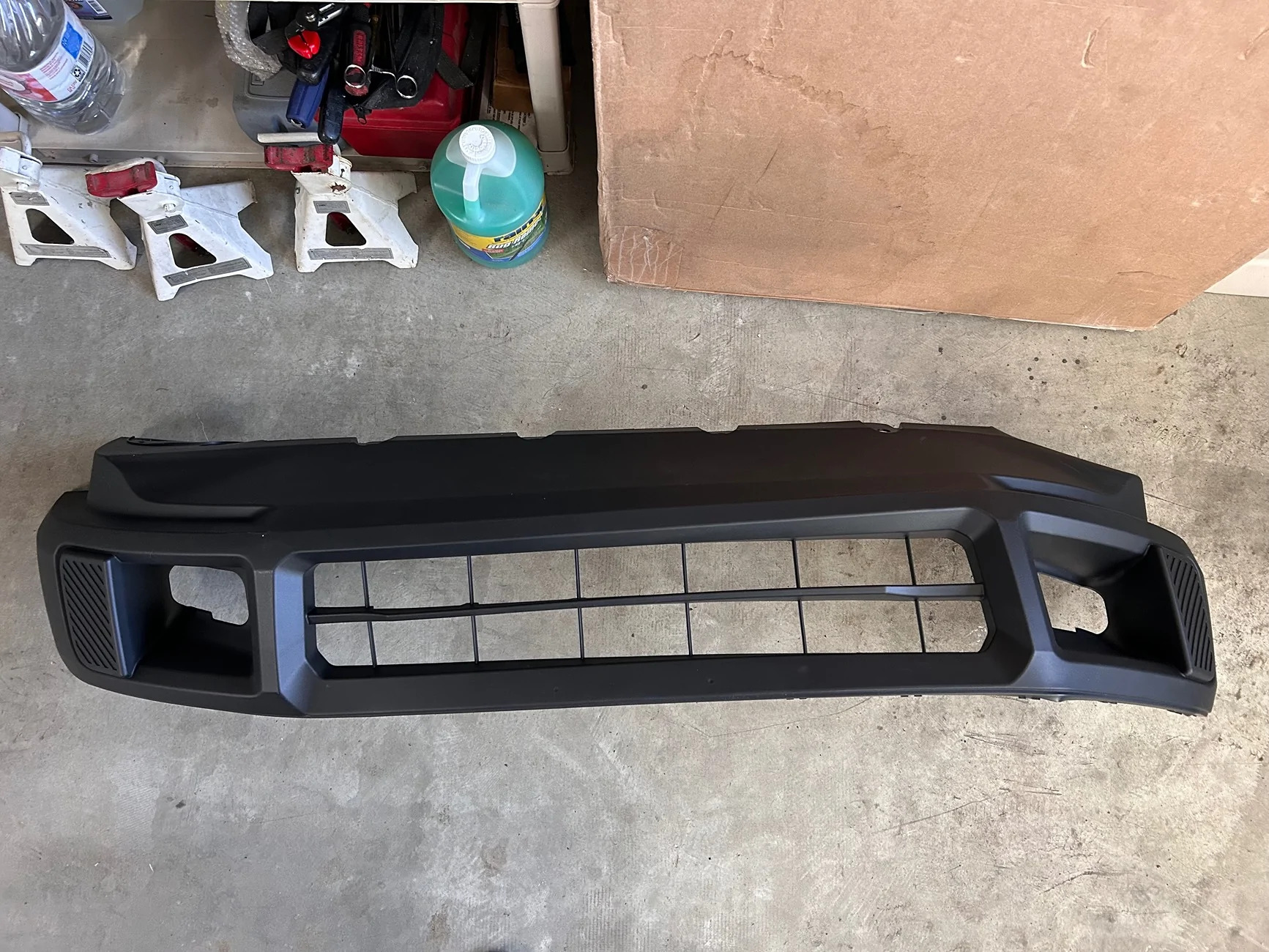

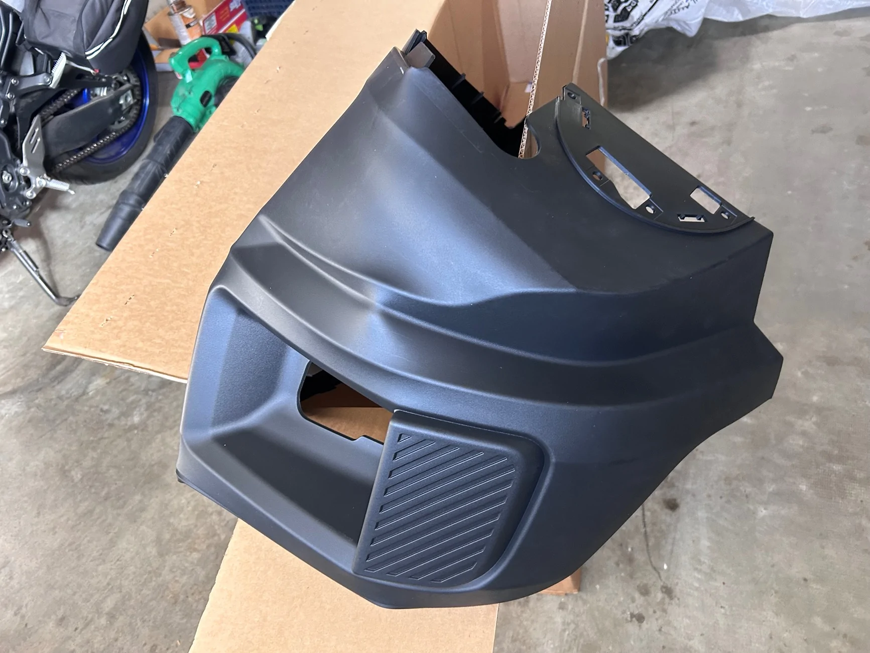

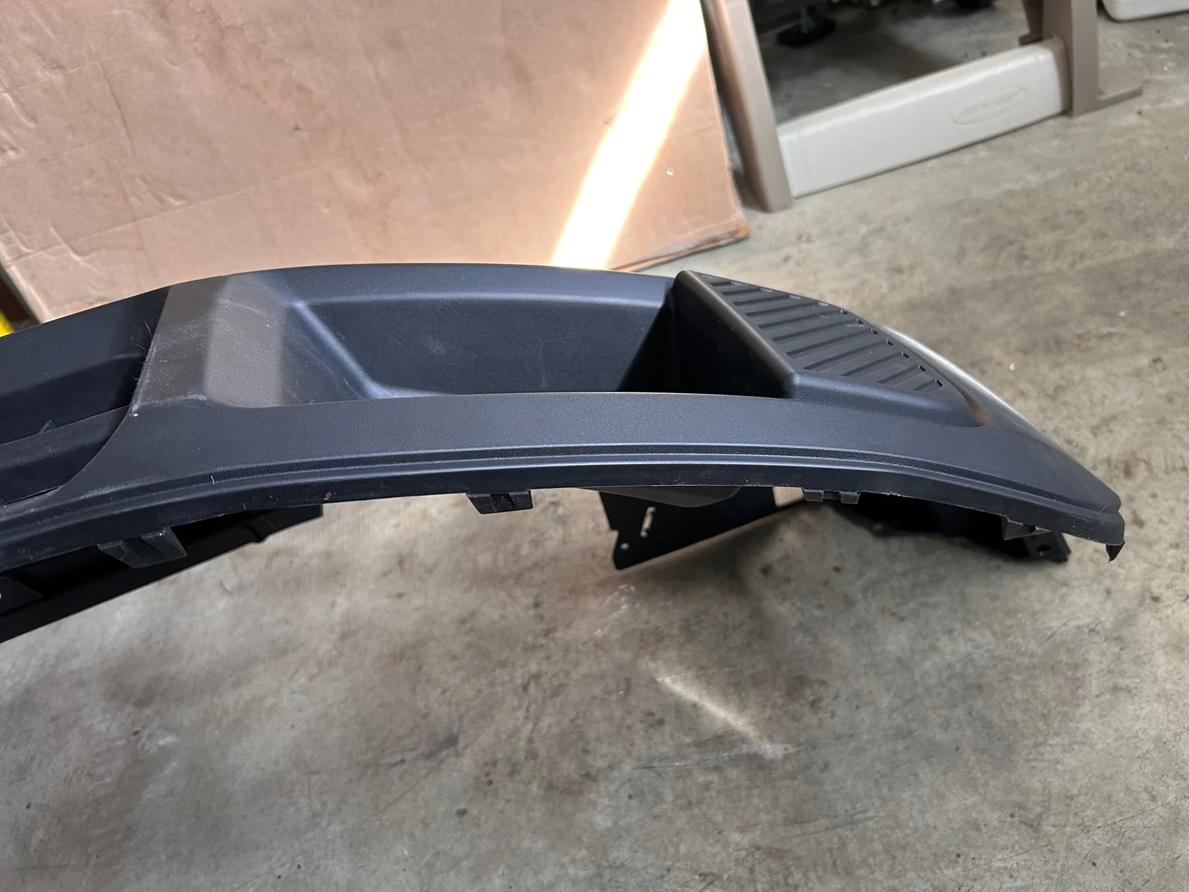

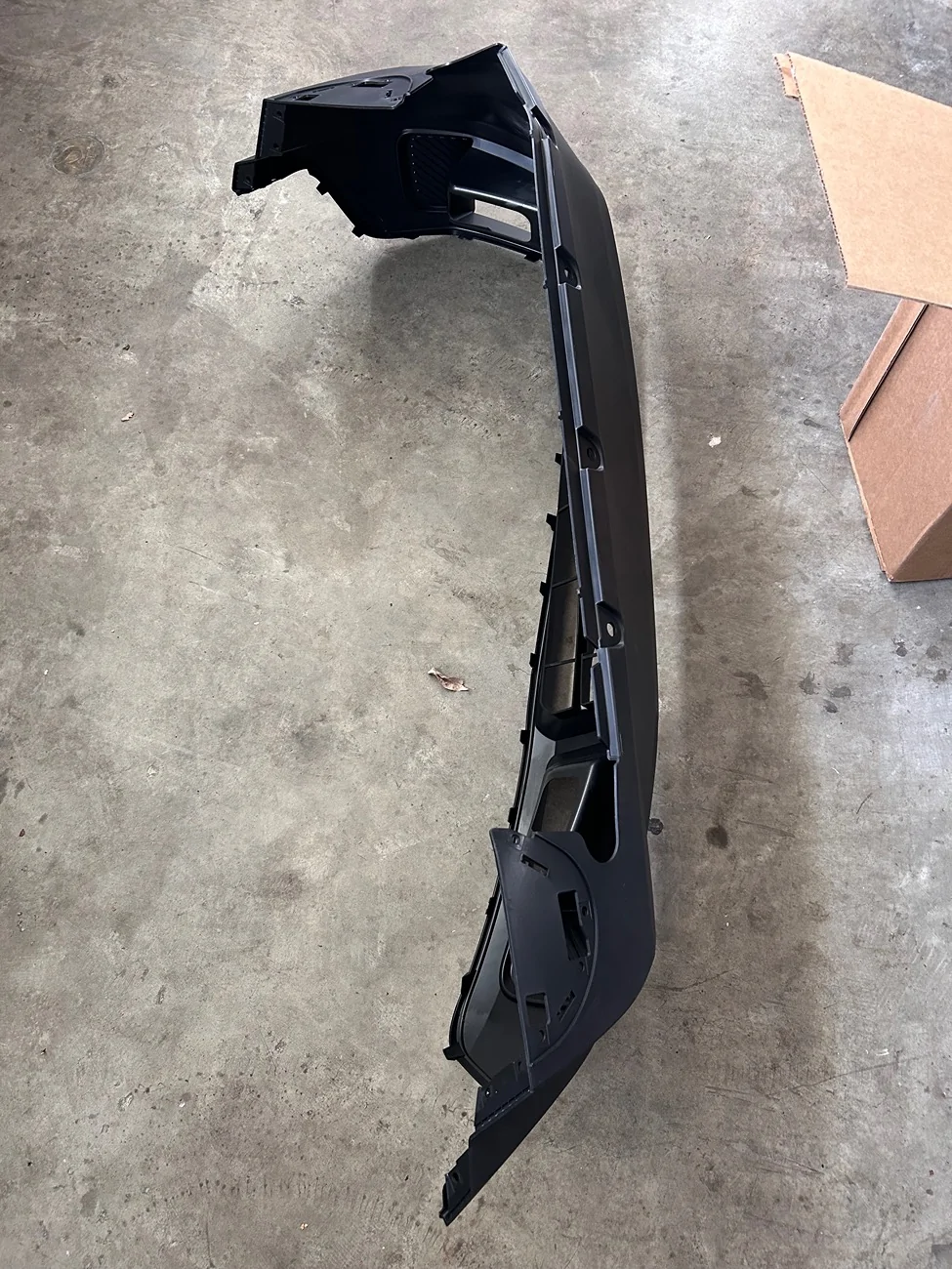

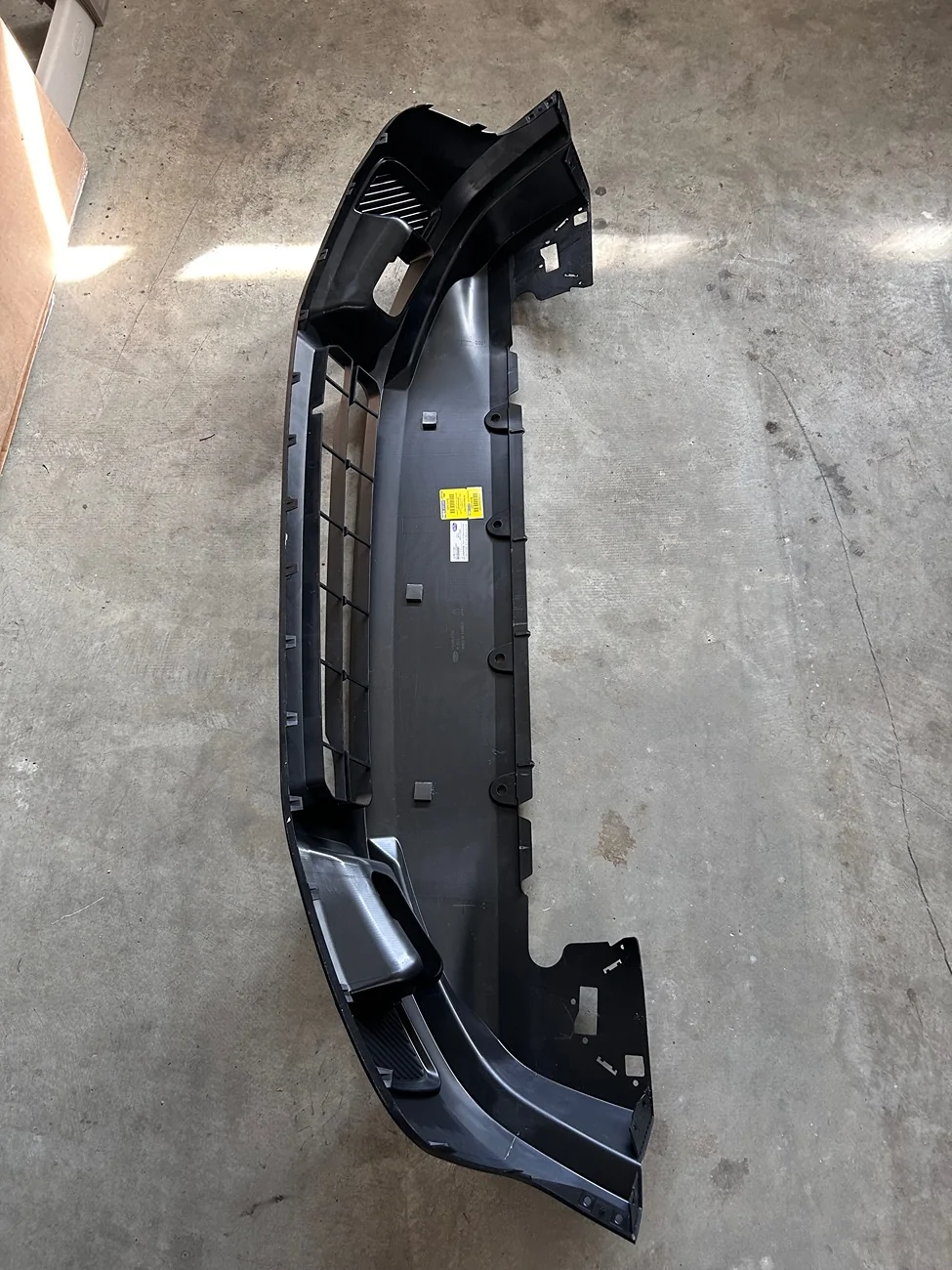

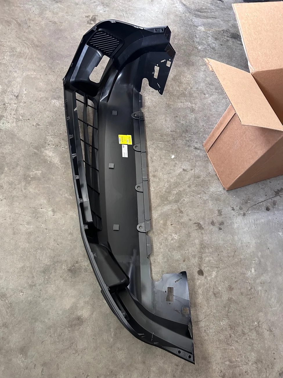

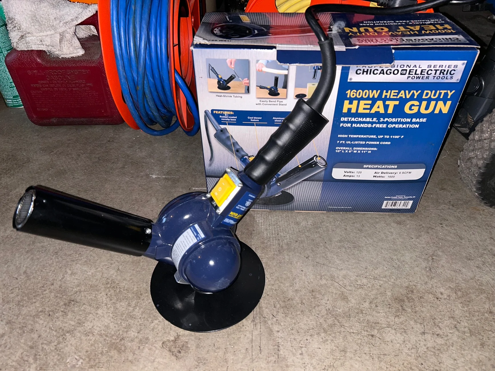

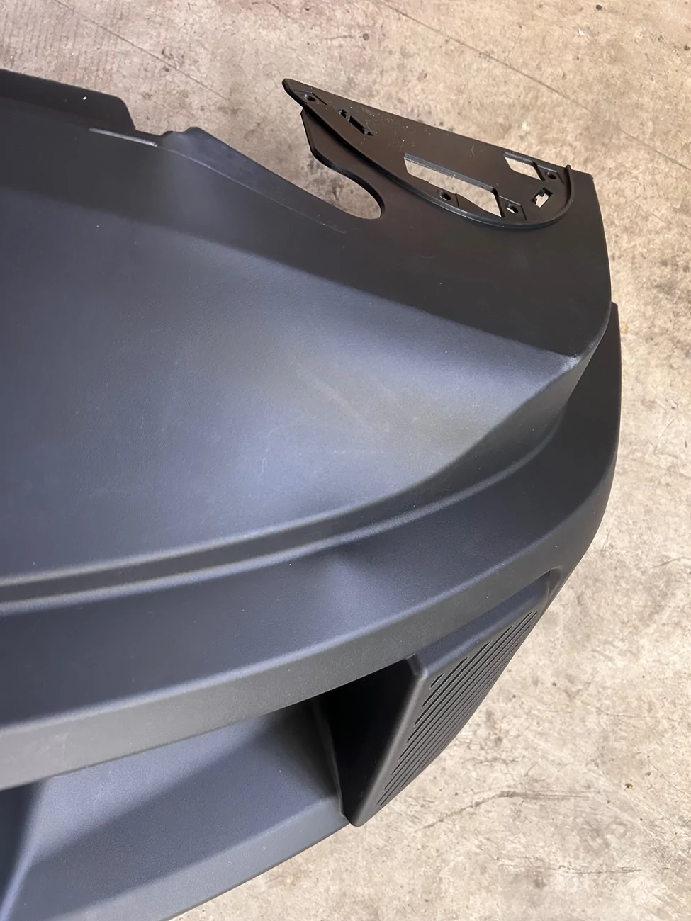

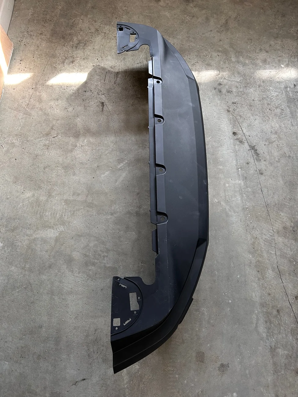

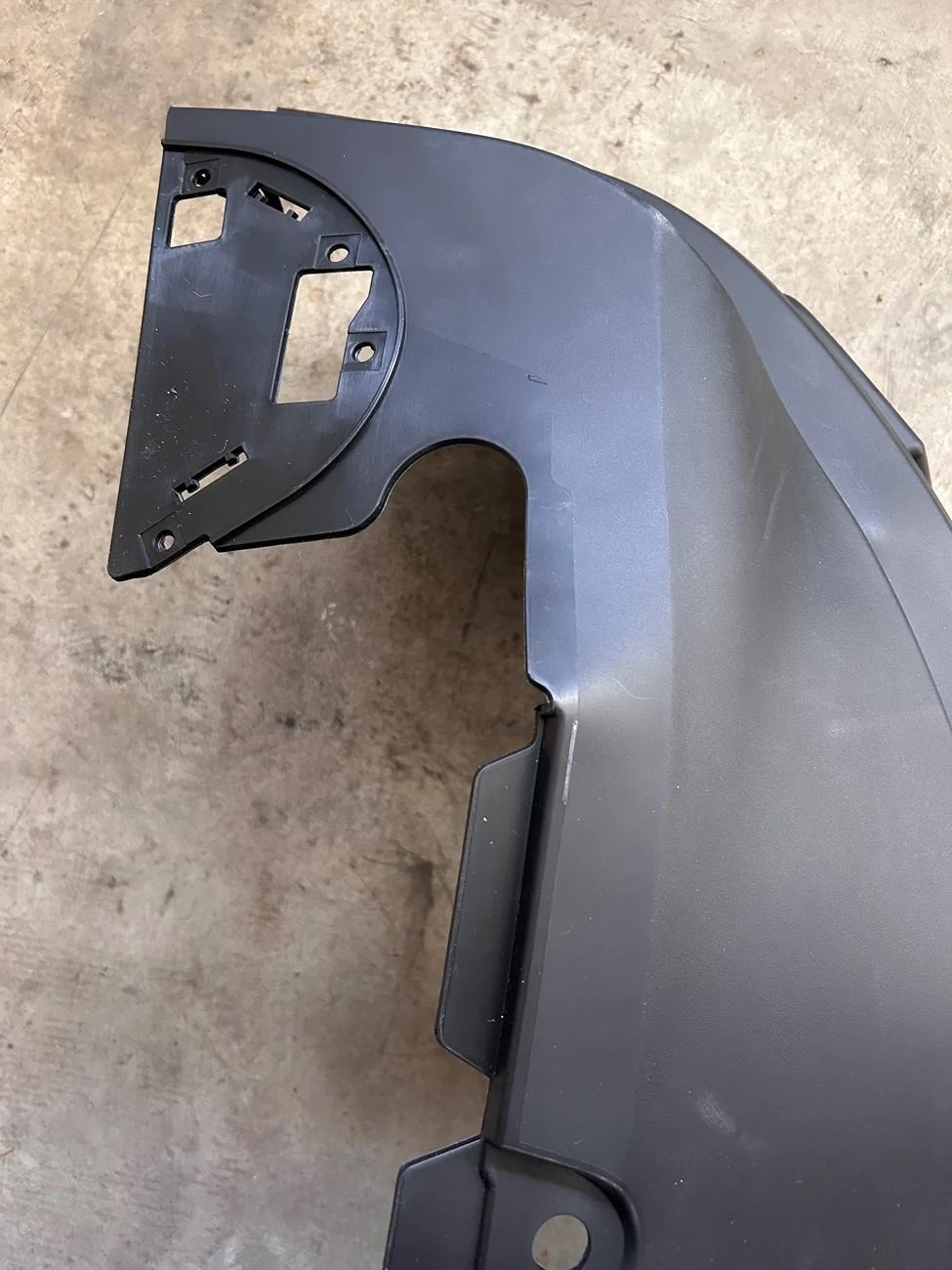

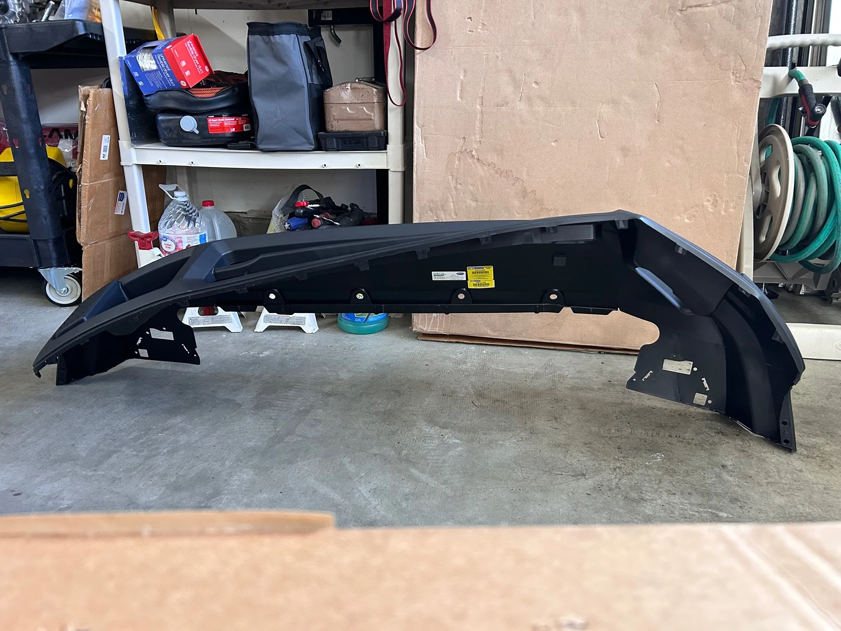

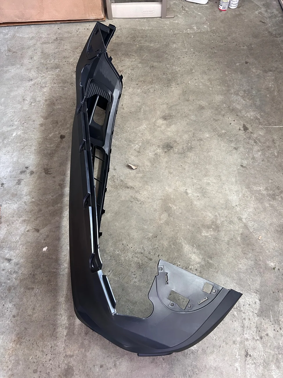

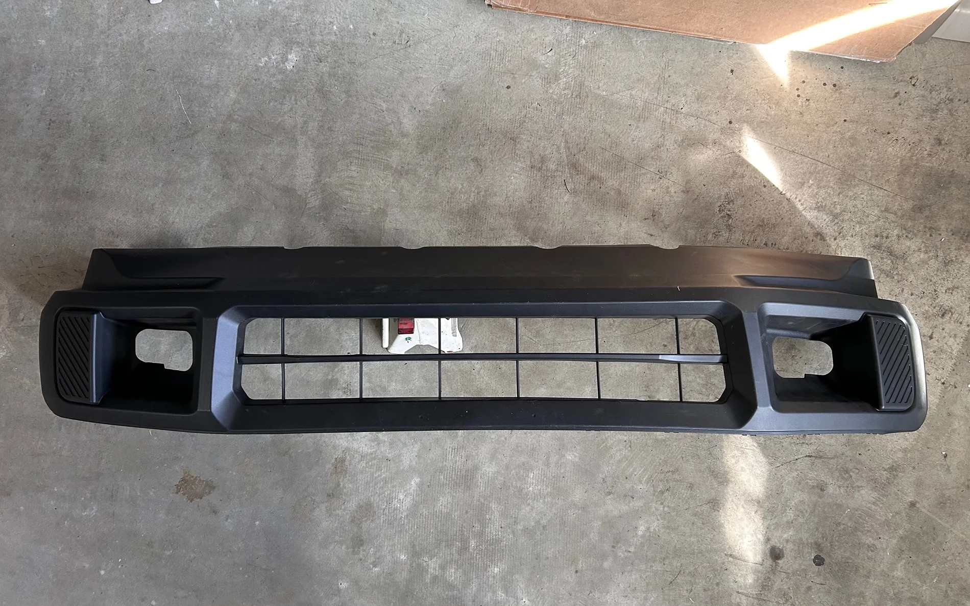

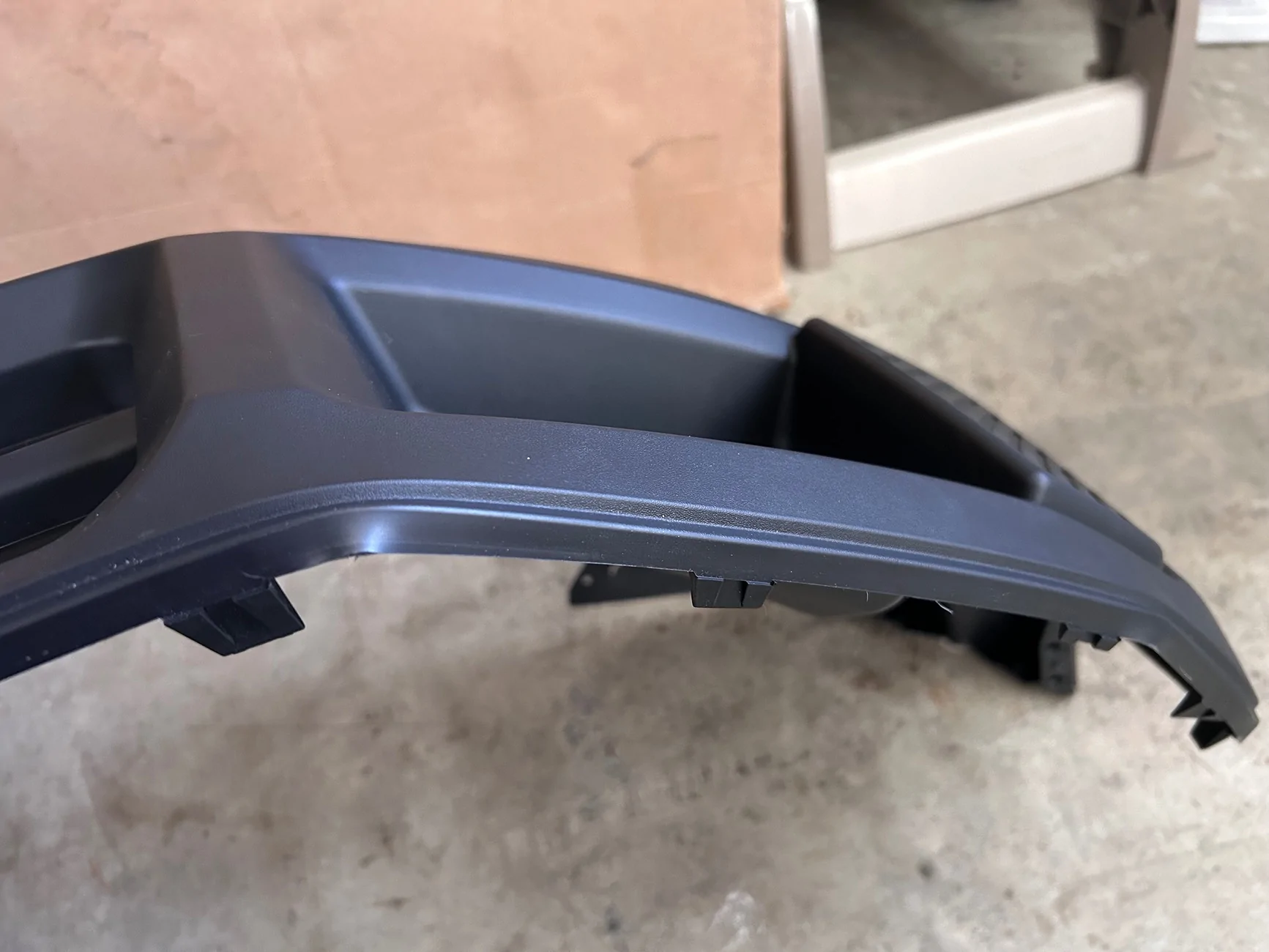

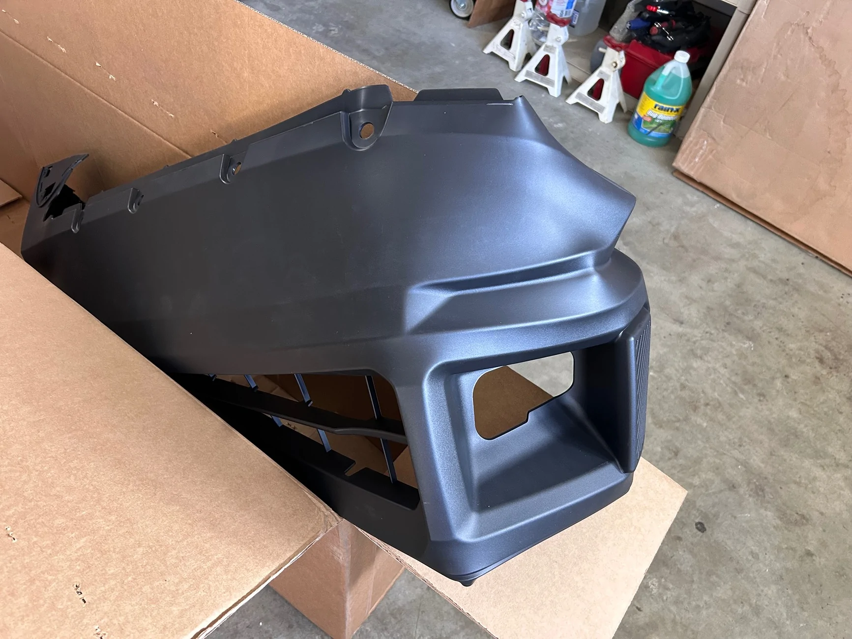

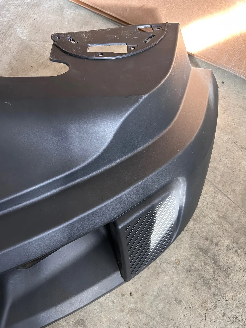

I thought about returning it, but after careful inspection of the warped part, I decided that using my trusty Harbor Freight heat gun, I could likely reshape the bent/folded areas good enough to restore the part to usable condition. It ended up being good enough (pretty good actually) that when it’s actually bolted on sometime down the road, it’ll look like it was never bent and folded up by that certain individual in the shipping dept taking shortcuts.
