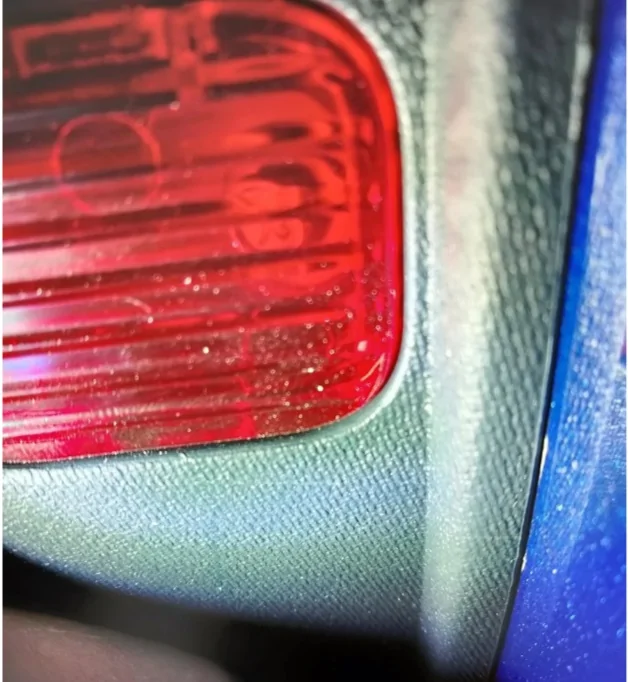

If you don't want to read through the thread. Here's the gist of it.
The red lens has no reflective properties and is there to cover up access to a screw.
Ford Maverick Courtesy Entry Door LEDs 20260901_093252
Red reflective tape added on top of red lens.
I bought reflective tape at Lowe's.
I would have preferred the yellow or white tape but decided to stay with the theme of red.
It does make a big difference VS just the red lens.
Top picture is the OEM Red Lens.👇
Reflective tape added ☝🏻over the red lens.👍
The reflection on the left, is actually the reflective tape, reflecting off of the paint of the truck.
Y
ou could certainly put lights in that area of the door.
Running power wires into the door, or tapping into wiring in the door.
Doable but to what end. Do the occurrences justify the work and cost?
