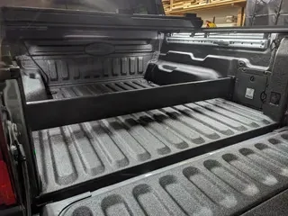

Hi there,

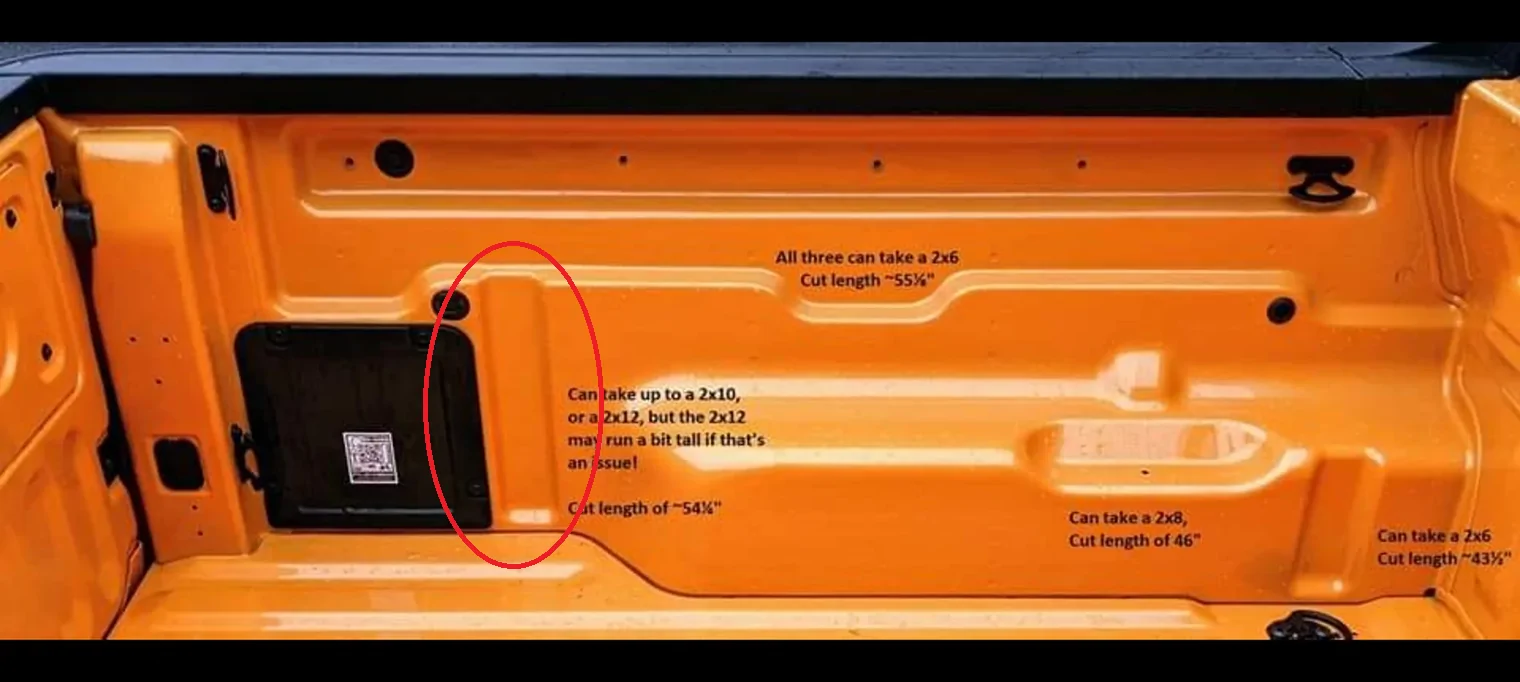

I'm looking to fit a board in the rear slot and was wondering if anyone has found the correct board width that would be flush with the height wheel well/ tailgate in the upright position.
I'd like to use this board as a cross piece to provide extra support when hauling plywood (similar to the 2x8 i have in the front horizontal slot) so the plywood doesn't bend too much when I strap it down.

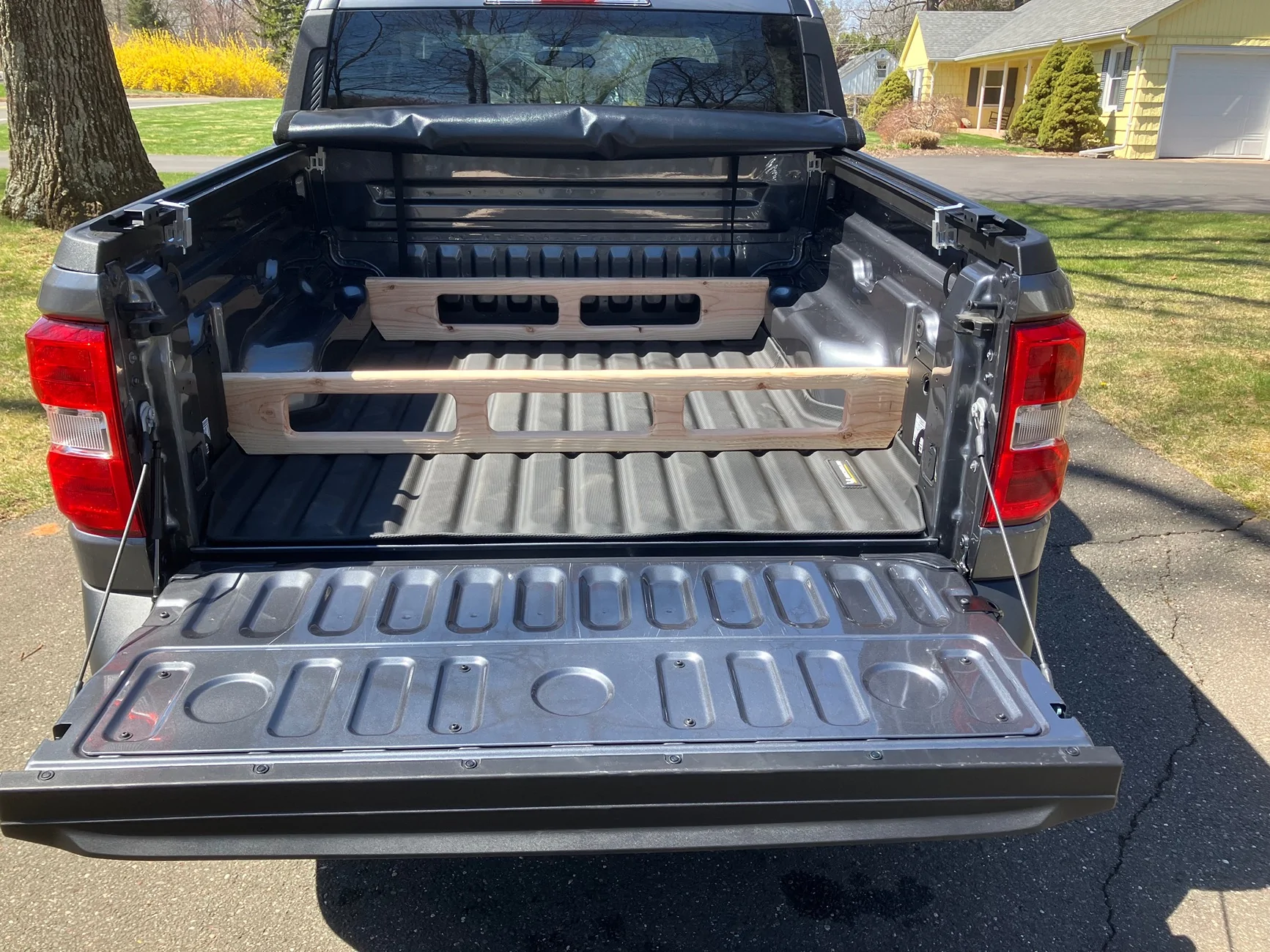

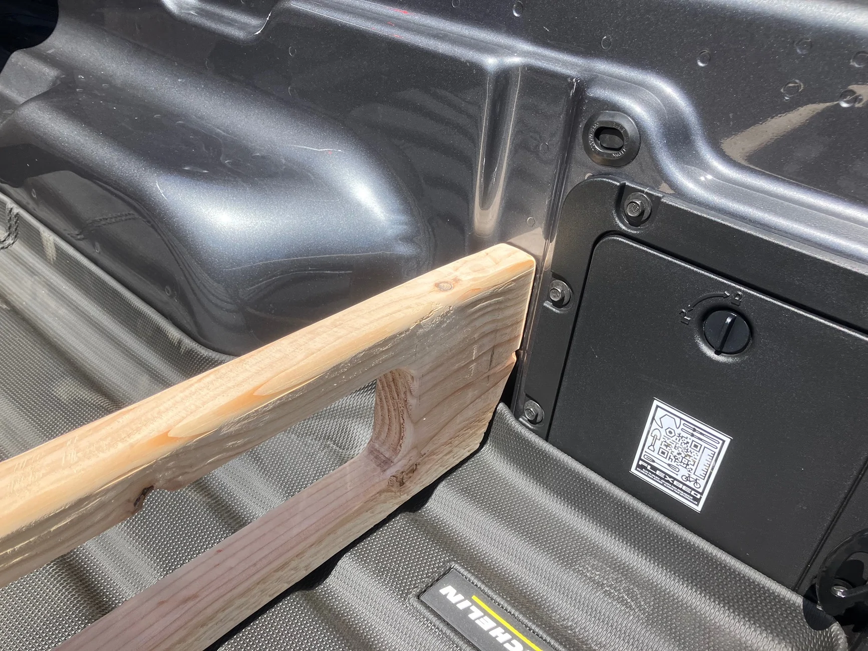

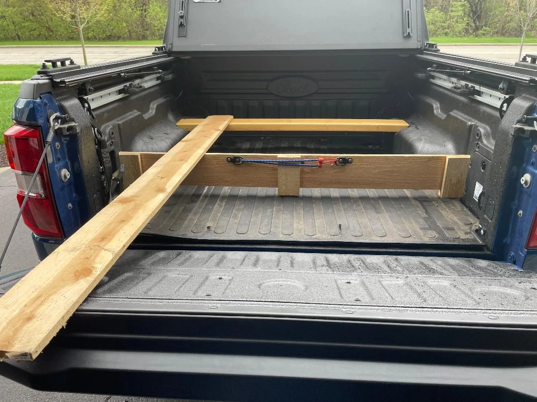

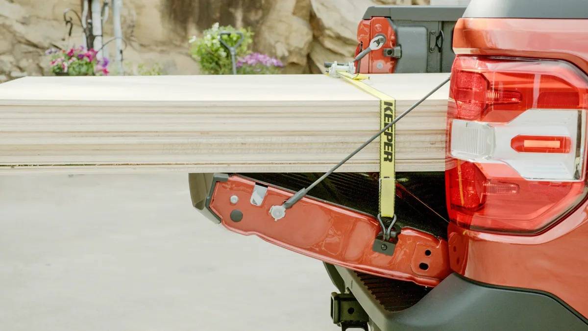

Why would you want the tailgate upright when there's an additional lower tailgate position to level it with the flat board (labeled "cut length of 46") in your pic?
Nothing more is needed.

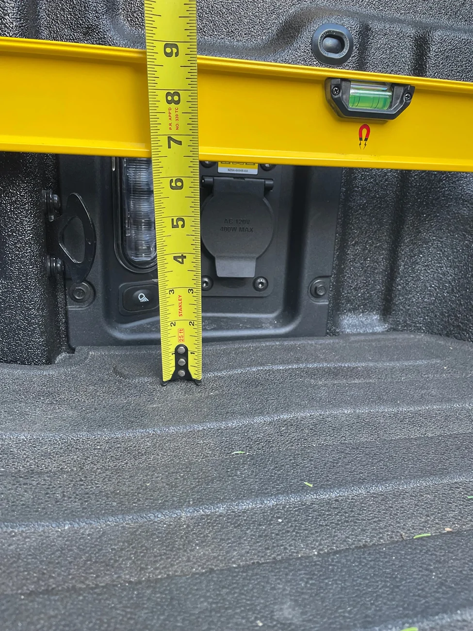

Mine is at 6-1/2", since I have a bed mat.

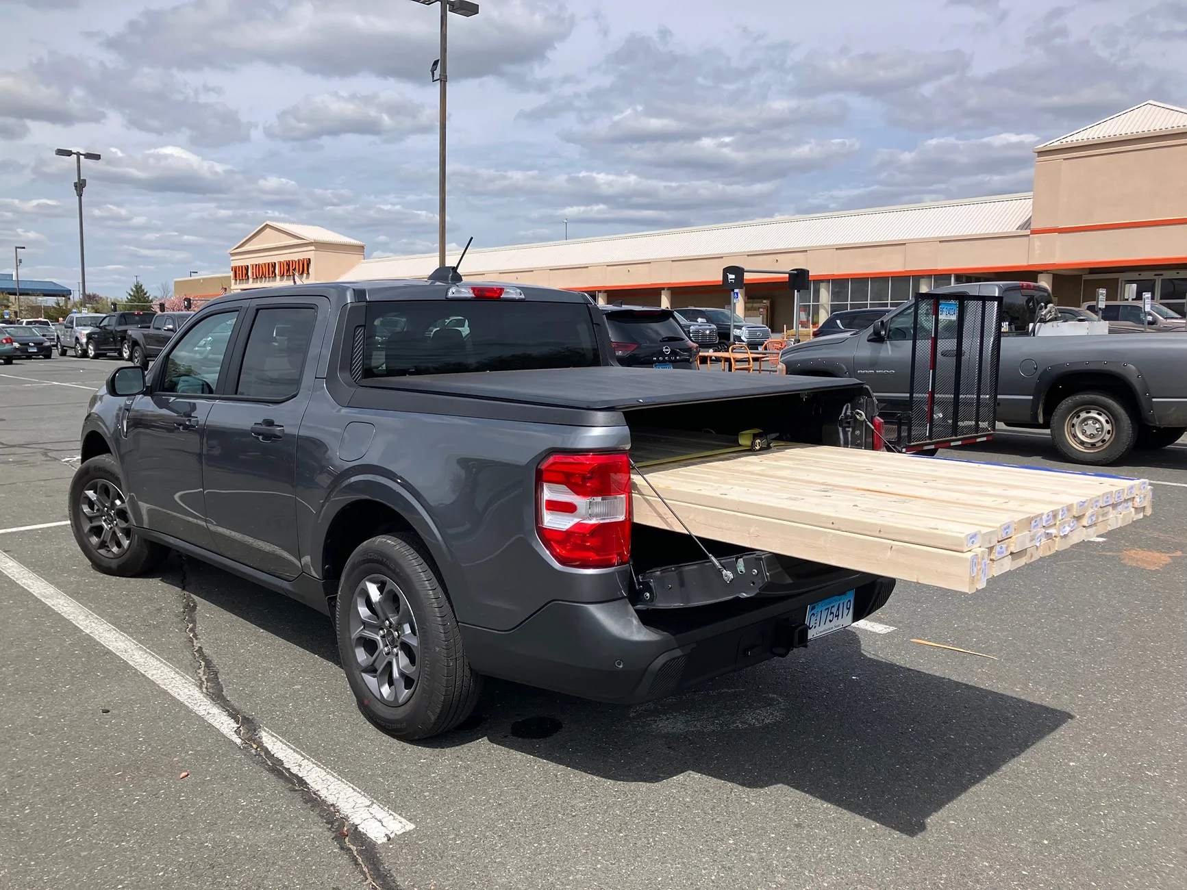

Great illustration for hauling plywood which is what the op specified. 👍

Hey guys, sorry for the confusion. I did mean the tailgate in the "middle" position (flush with the wheel wells).
The width of the board is relevant because when on its side in the slot, it becomes the "height" I'm trying to get flush with the previously mentioned parts of the bed (a bit confusing because I'm talking nominal width of the lumber like a 2x6 or 2x8). The weird part is that slot is angled at the bottom so I wasn't sure where the board would try and rest (depending on how its cut)

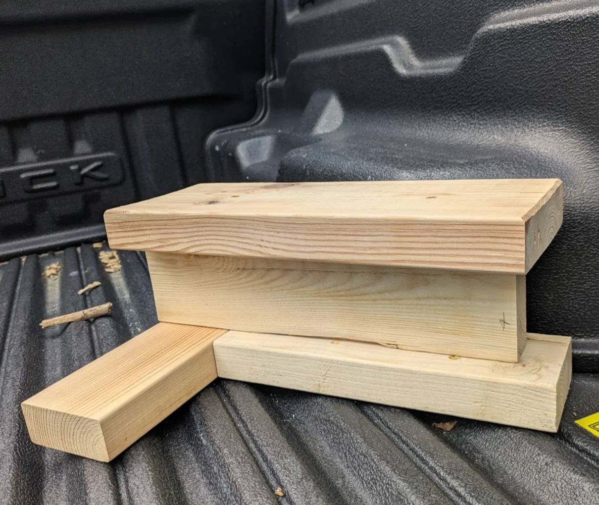

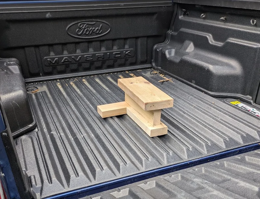

For floppy sheet goods I went another way. Screwed together some 2x's, so 6 1/2 tall, and set it in place it in the center of the bed before loading.

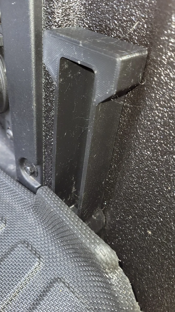

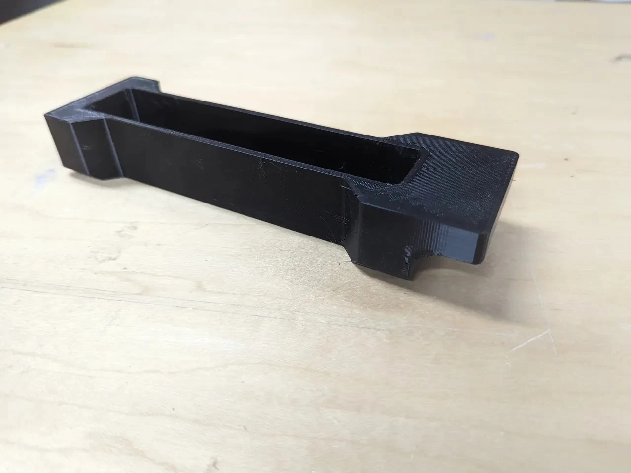

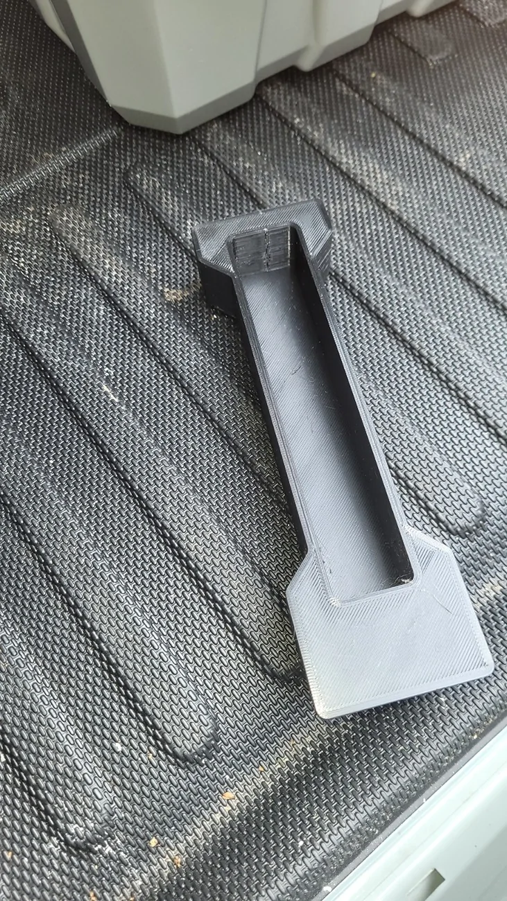

If you know anyone with a 3D Printer you can print these Brackets and use 5/4 x 6 Radius Deck Board. I printed them for my 24 Lariat Tremor which has the horizontal rails and I'm able to slide in trickly in one piece. Here is the link for the file: https://www.printables.com/model/809536-maverick-cap-for-1-bed-divider
