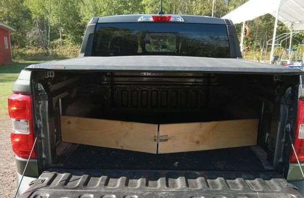

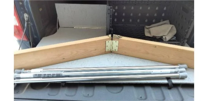

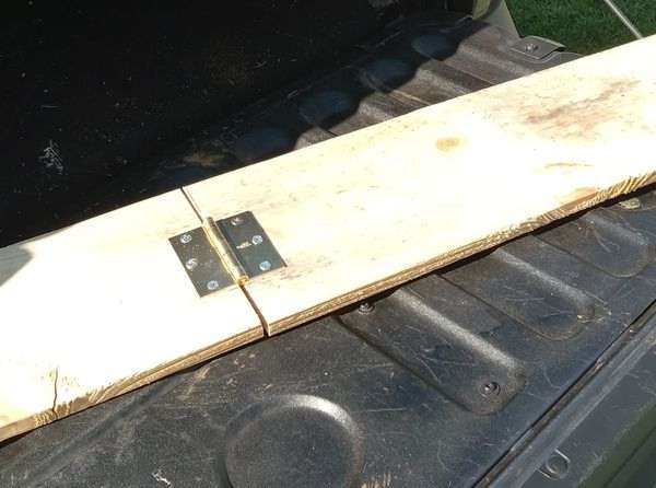

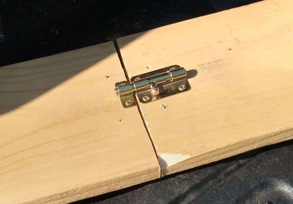

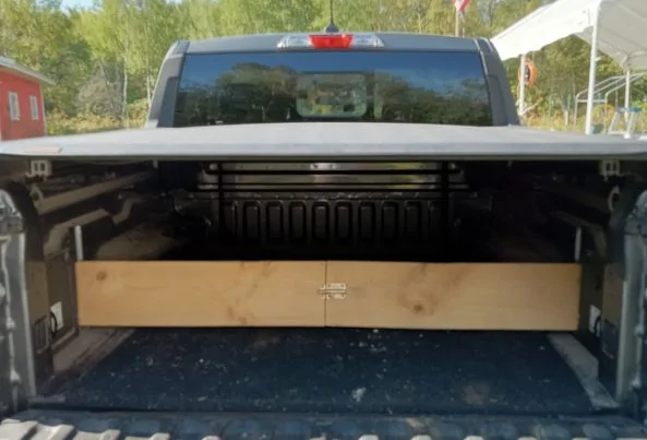

I got tired of climbing on the tailgate to install/remove the spacer board. Myself being a product designer/R&D I needed a solution. What I came up with is a very simple solution, all I needed was a hinge, a cross bolt and a saw. You guys are better carpenters than me and can make it a lot prettier.
