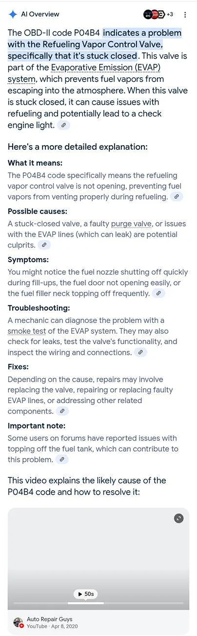

Refueling Vapor Control Valve is Stuck Closed, ask For Warranty
MakinDoForNow
Sep 24, 2021
8,644
6,286
Service done on July 10th and 11th. They replaced the Fuel Vapor Vent Valve. Cleared the codes. I've had it for 4 days and filled the gas tank with no problems. Also wanted to mention that the fuel door activation now works like its supposed to. Not sure what caused the malfunction of the part , but I'm pleased to have it working again like its supposed to.
If the fuel vapor vent valve is clogged, cannot open, etc the the vapor pressure cannot be bled off necessary for fuel toor release to work properly.
