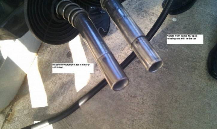

I have had issues in the past with my Fords when they switched to the capless system and 💯 had the same shut off issues. Later found out it is the pumps and I have watched out ever since when I grab a pump nozzle. If they are using a two piece nozzle and the end comes off it still pumps gas so the stations don't care. However the Ford needs that piece to work. I found an image online that shows this missing piece. If it's missing guaranteed to give you grief.
