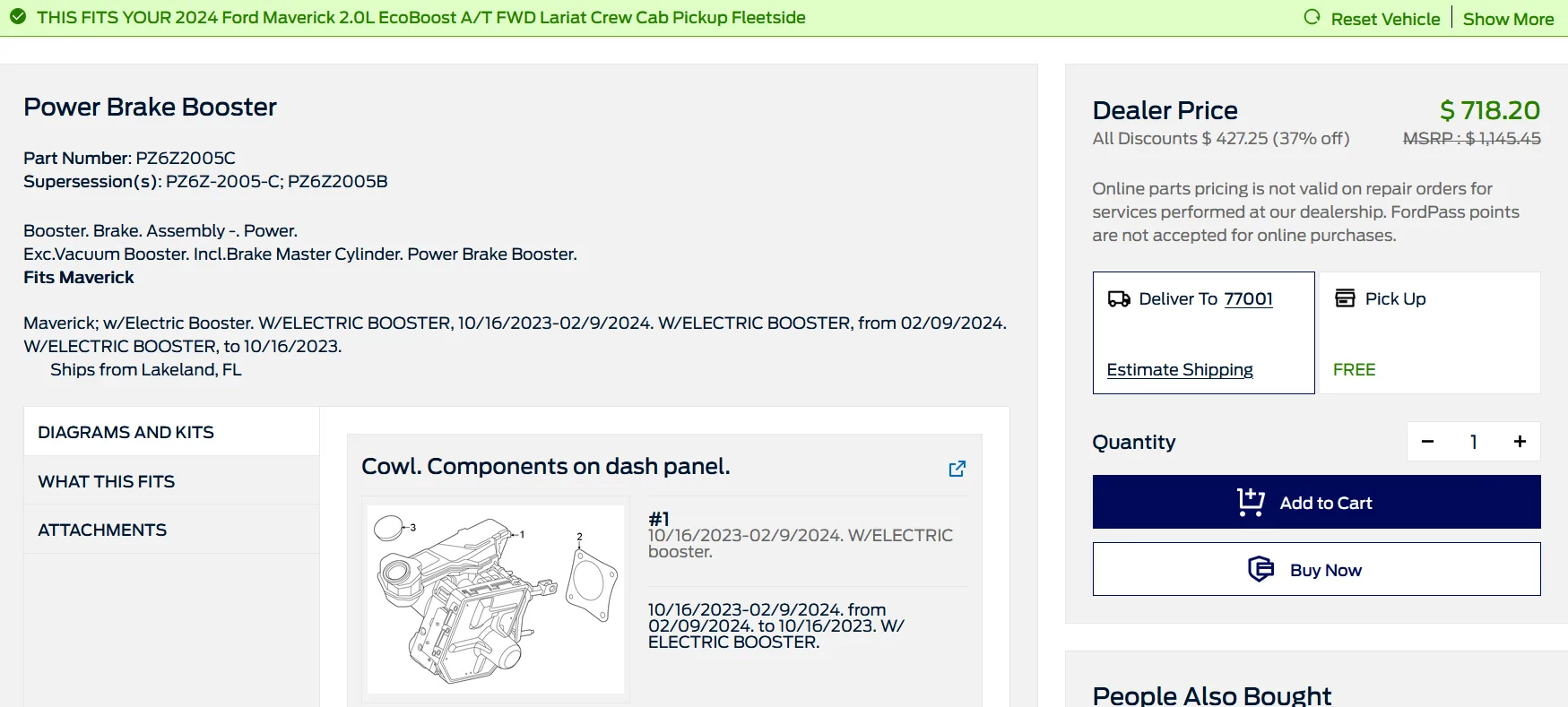

But the EB does not have Electronic Brake Booster like hybrid does (ETA:unless trim with ACC/S&G) - still good ole vacuum - get that one last good press out of it with power.
But did the 25/26MY finally get EBB on the EB's, or still vacuum assist?

I read 2023-2024 Maverick ECO Lariat's with Adaptive Cruise Control with Stop & Go have EBB.
2024 Lariat 2.0L VIN 3FTTW8S99RRB22228
