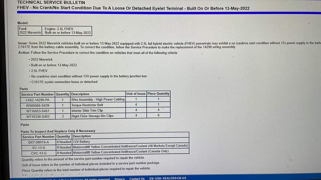

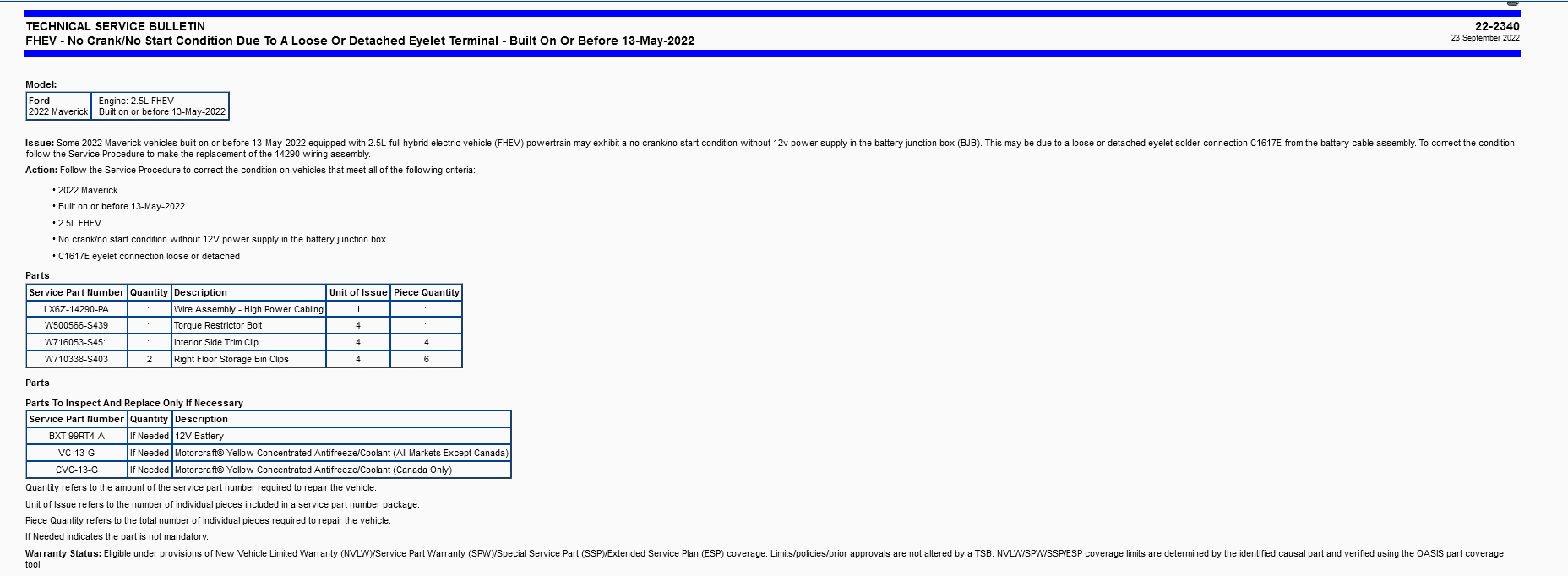

Looks like Ford has isolated impacted manufacturing dates for the hybrid harness / no crank / no start) defect.

Can someone explain the ANTIFREEZE connection here?

Thanks for this.
This answers the questions from forum members who are wondering if the current builds or even if MY23 builds for the Hybrid could still have the problem.
Looks like if your build was after May 13th then the problem will not happen.
This exact date in the TSB seems like Ford narrowed it down to faulty build of batch(s) of the cables and after the date new batches were used that did not have the issue.

Is there a number for this tsb? I don’t see one in the pic.
