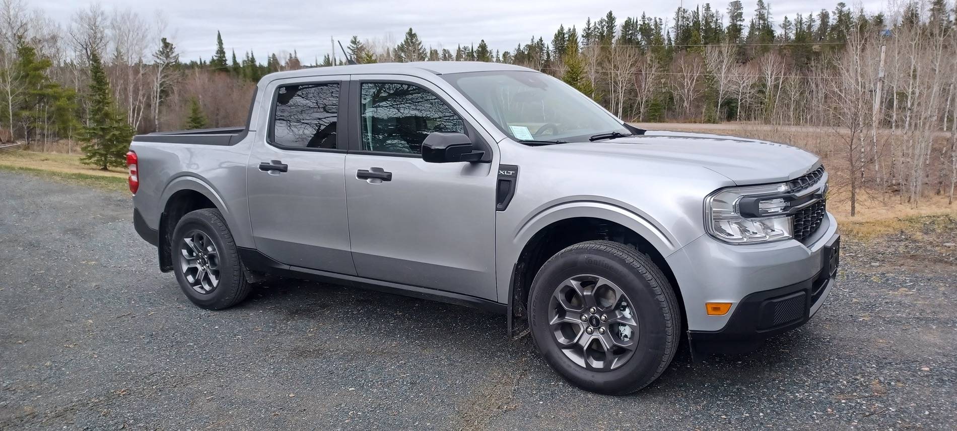

So my 2024 Maverick XLT hybrid stopped communicating with Ford and the Ford Pass app does not communicate with the truck. I called Ford directly and after some on phone diag they said that they could not see the vehicle and said to bring it into the dealership. I brought it into the dealership and they replace the module that is responsible for communication. After I left I tried to connect with the Ford Pass and no luck. I get a message that authorization was not allowed. You are supposed to to get the message on the screen for you to authorize communication but I never received it. I brought the truck back to the dealership and after talking to the tech who was working on it, he said that the module is showing on the data stream but it’s just not connecting to the network. They have contacted a Ford engineer who came to the dealership last week and they are still investigating. The Maverick has been at the dealership for over two weeks. They were kind enough to provide a rental. Anyone else have this issue and how was it resolved. Thanks in advance.
Pic for attention.
