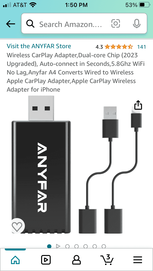

I have same issues as y’all do. I bought this on Amazon see pic they have it for CarPlay and android. Been using it for CarPlay for 2 weeks and no dropped calls no lock ups it’s worked perfect and is much faster.
Ford Maverick Bluetooth issues? BD9927E4-CD23-4BFE-B09F-10B53E61B27E
