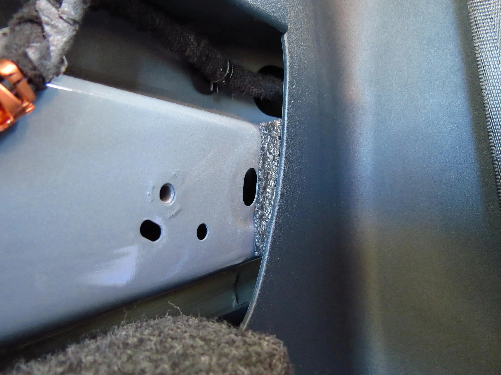

Also back wall has none ,
The back wall was where the majority of my rattles were, even after I'd added asphalt mat. But then again, my sub enclosure spans the whole back wall and is bolted to it. Audio system details are in my build thread in my signature below, see page 4.

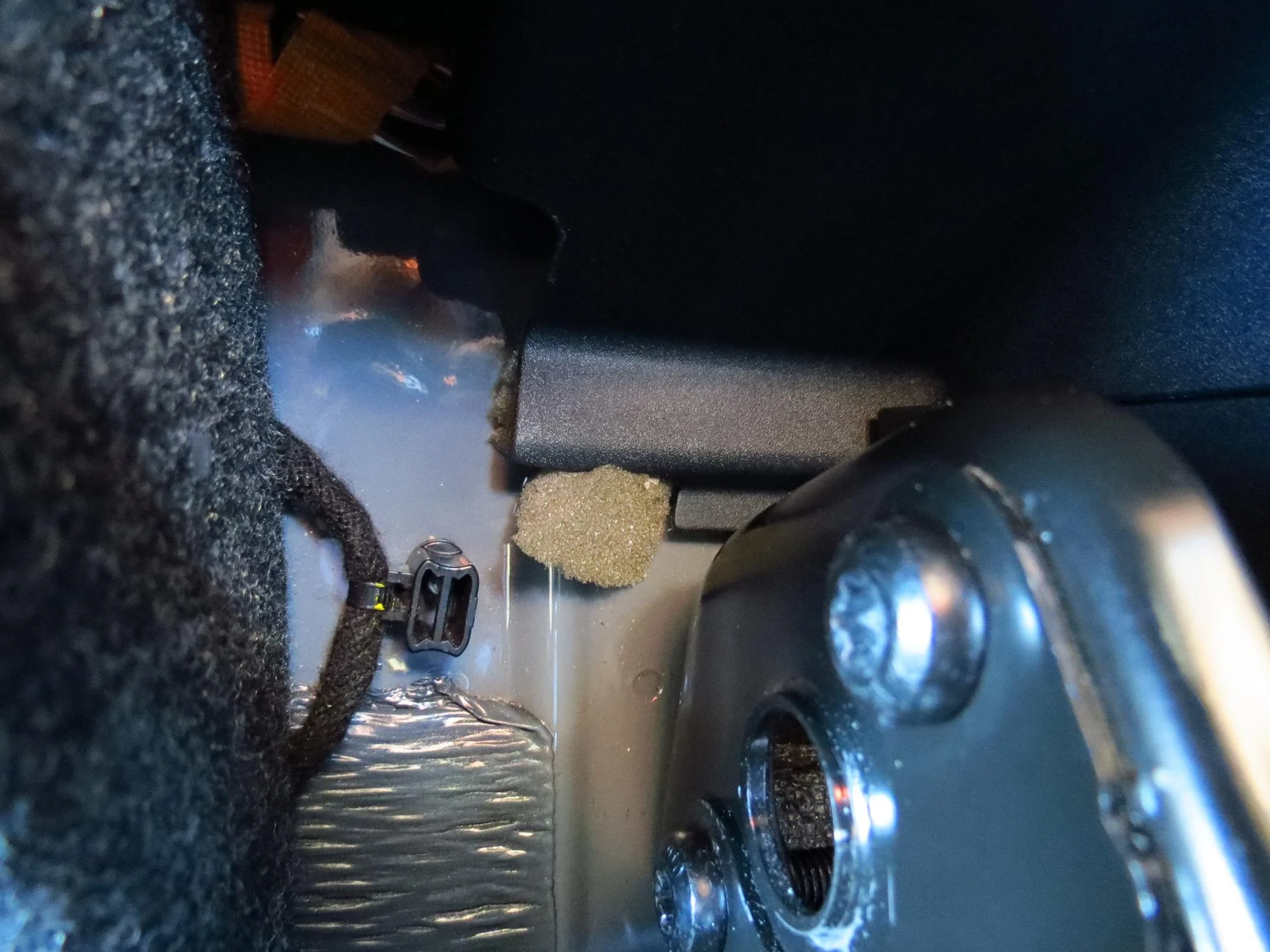

The rattles back there seemed to be in places where the plastic trim edges rest against other things (plastic, metal, or asphalt mat). The black plastic brain box that sits back there on the driver's side was a bad offender. Those were easily solved by cutting some scrap foam into chunks, and sliding them behind an offending panel's edge with a putty knife. It's low-tech and solves it quickly. Use of felt works great also, as another poster had suggested as well.
Ford Maverick Common Interior Rattles? IMG_5364
Ford Maverick Common Interior Rattles? IMG_5366

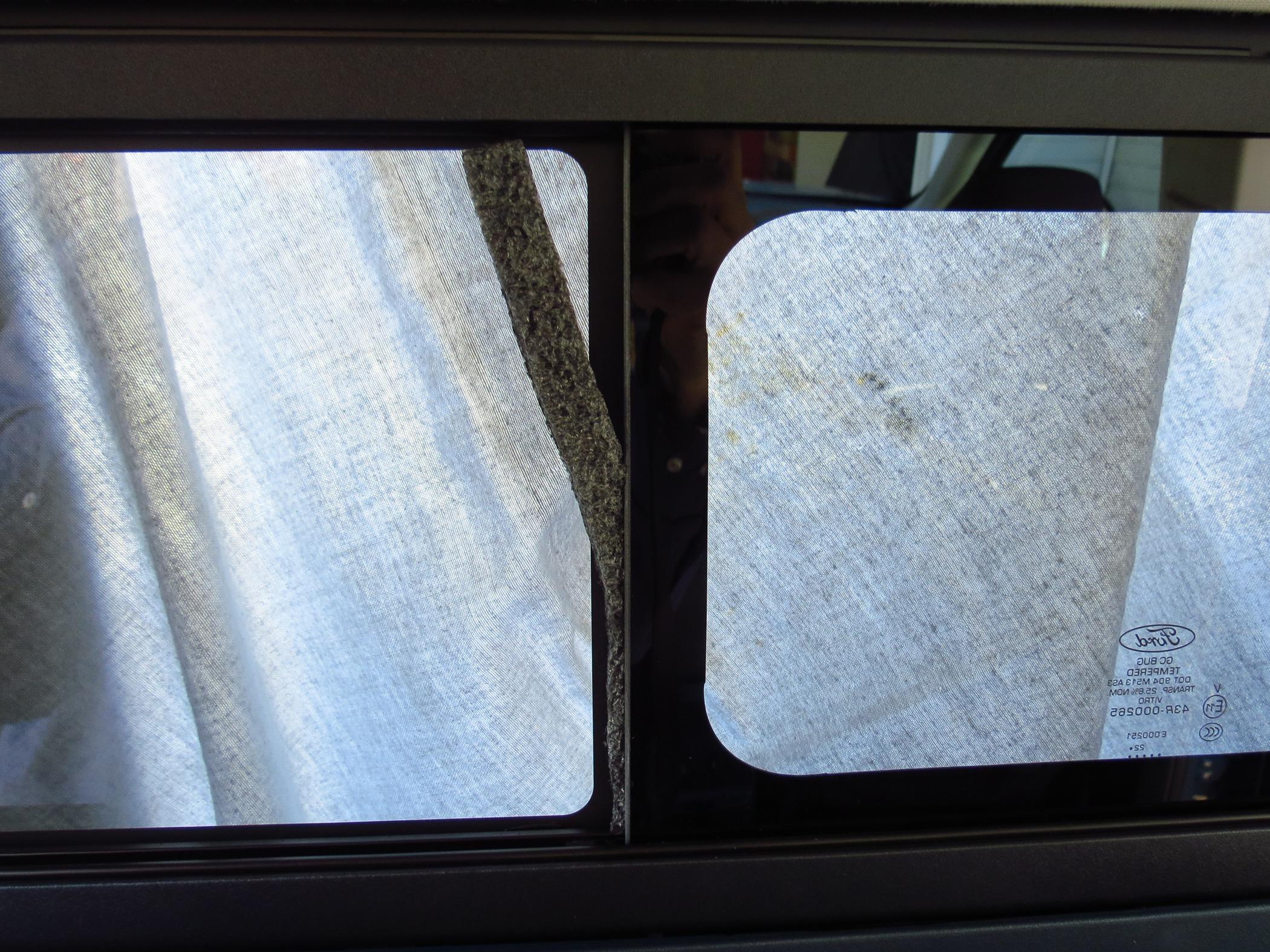

My rear sliding window has some vibration at a high volume, but a small strip of stiff foam slid under left & right edges of the sliding piece of glass took care of most of that as well.
What I did with my sub & enclosure made these back wall and rear window rattles obvious. But if you have a smaller all-in-one sub back there, or one under the rear seat bottom, it's possible you may not notice any rattles from the rear wall or window at all.
