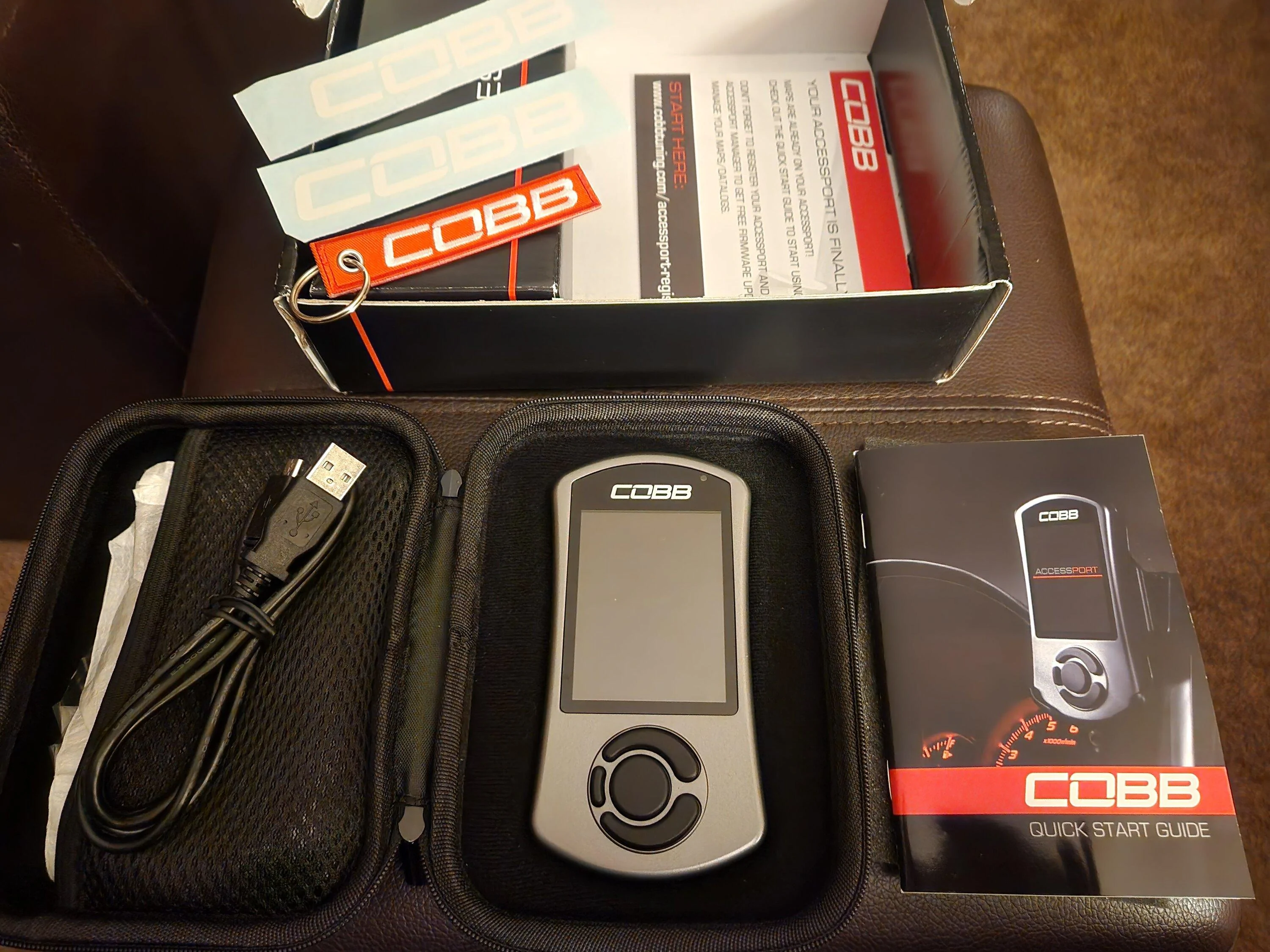

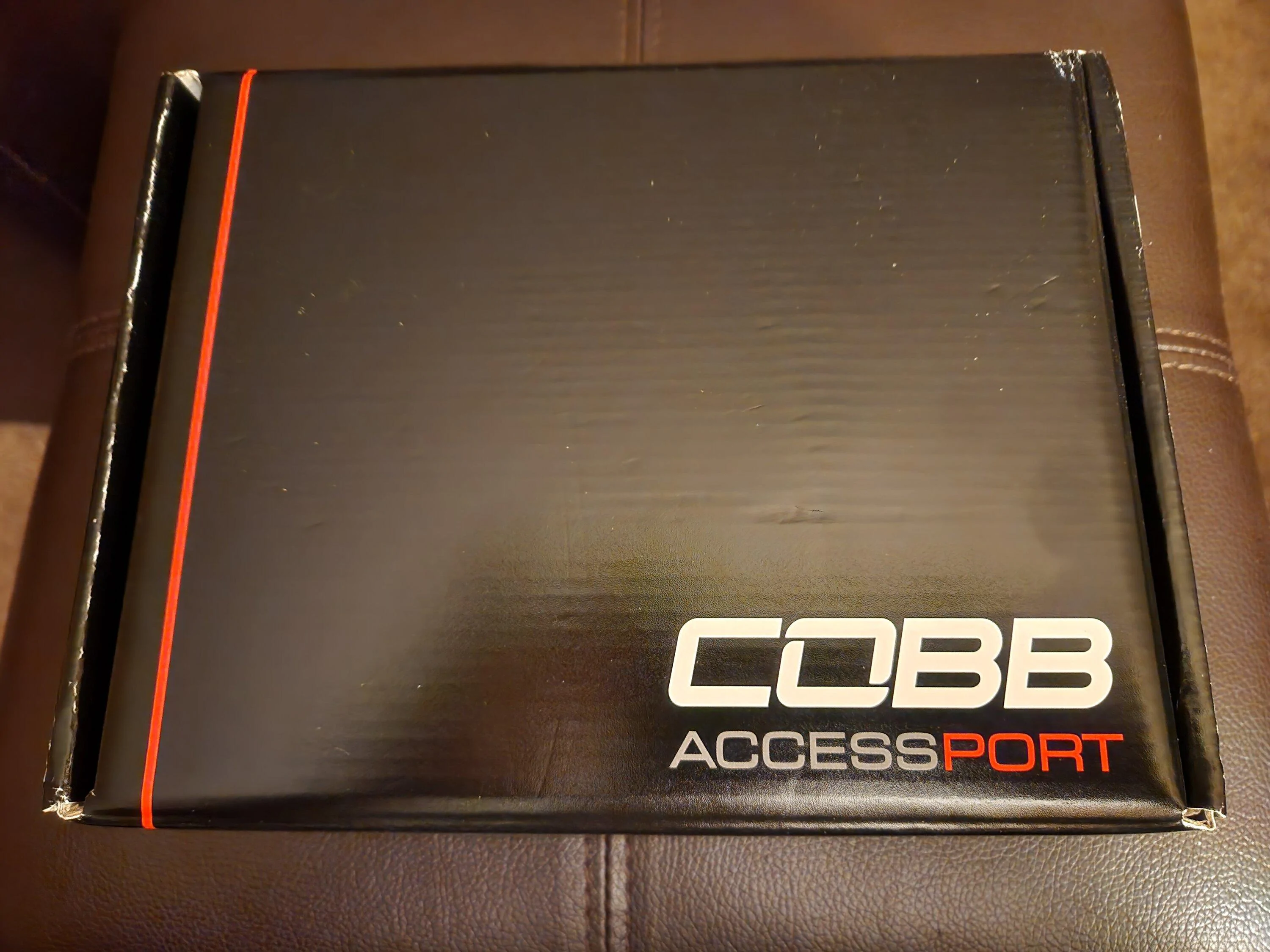

I got my Cobb Accessport this past Monday. I thought I would post a quick review.
This is my 2nd Accessport. I had one on my 2019 Mustang 2.3 Ecoboost 6 speed manual several years ago and was happy with the results.
I was glad to see them finally release one for the Maverick. I purchased mine through Panda Motorsports.

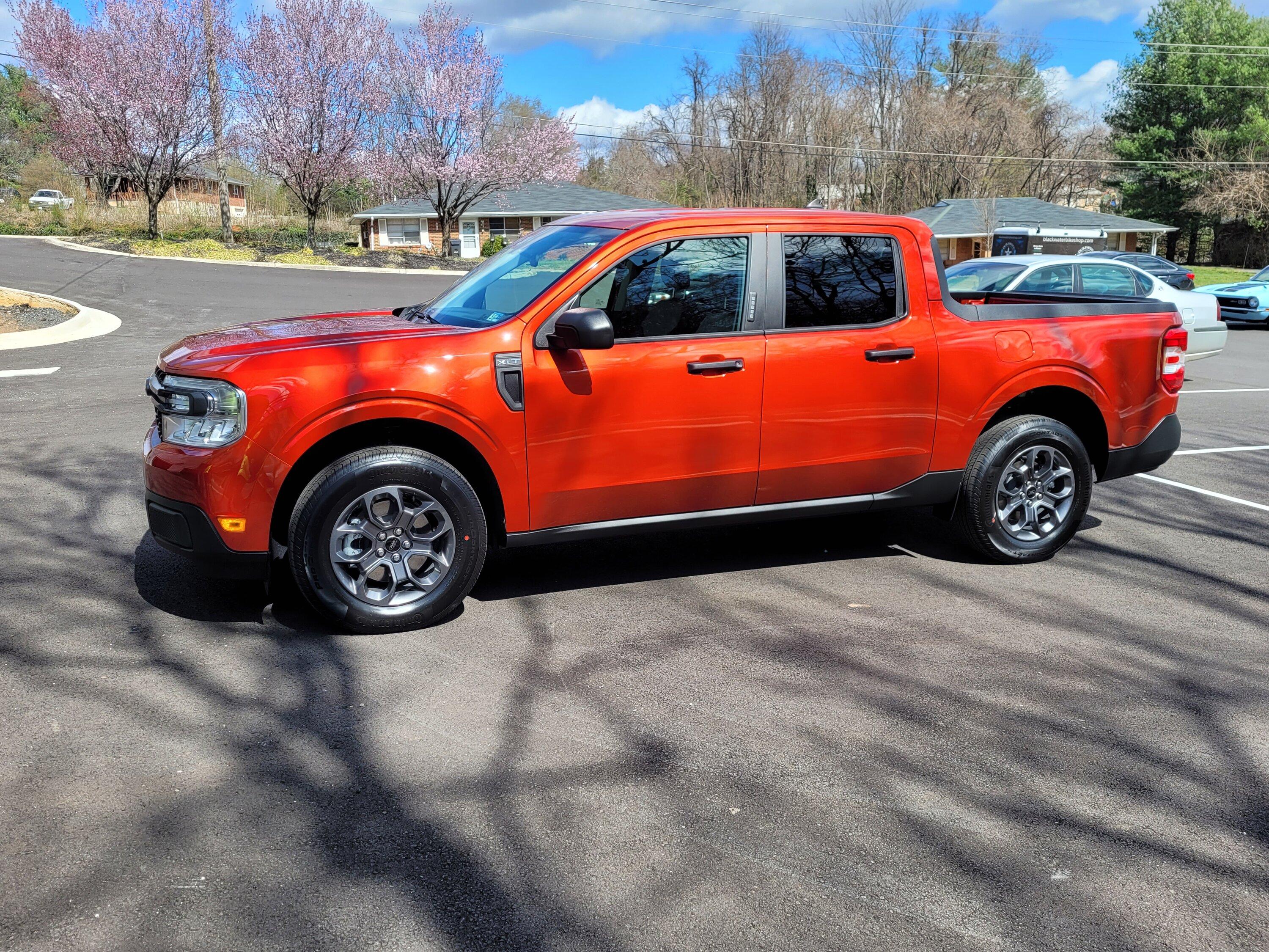

My truck is a 2022 XLT AWD without the 4K tow package. I got it in March 2022 and it is my daily driver. Even though it is my DD it only has 4,300 miles on it because my workplace is 5 miles from home.
I use 93 BP fuel in my truck exclusively. I have also had a drop in K&N filter in the truck since day one.

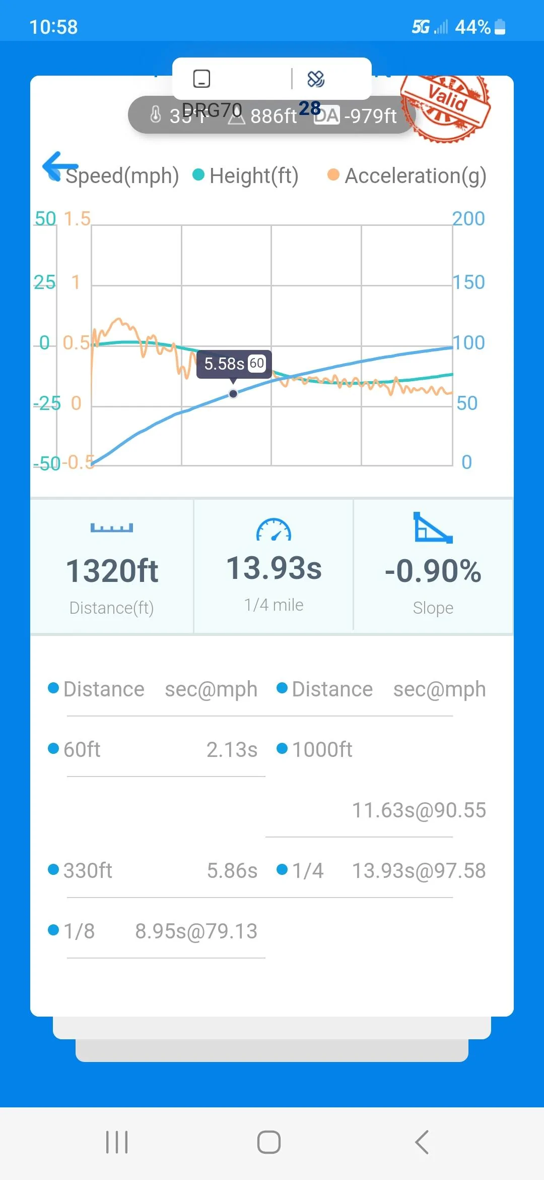

I got my Dragy in this week and was able to go out and find some deserted road to try my truck out.
13.93 with an off the shelf Cobb 93 octane tune and a drop in K&N filter. Everything else is stock.
The truck had a 1/2 tank of gas and I weigh 235 pounds.
I'm very happy!
