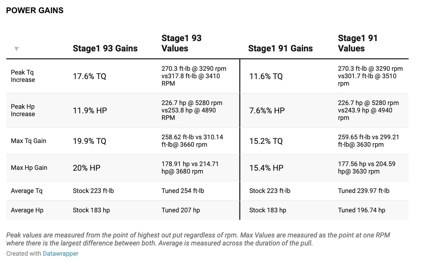

Ford Maverick COBB TUning Accessport for 2.0L Maverick!!! Image 7-6-25 at 9.10 PM
Am I crazy, or is the 2023 Maverick 2.0 listed by Ford as having 250 hp? It seems kind of underwhelming to see that the Cobb tune only raises what should be a stock 250 hp to 253.8 hp.
(Yes, I see that the stock hp in the test was 226.7, but isn't that low??)

Ford's 250 HP is not at the wheels.
