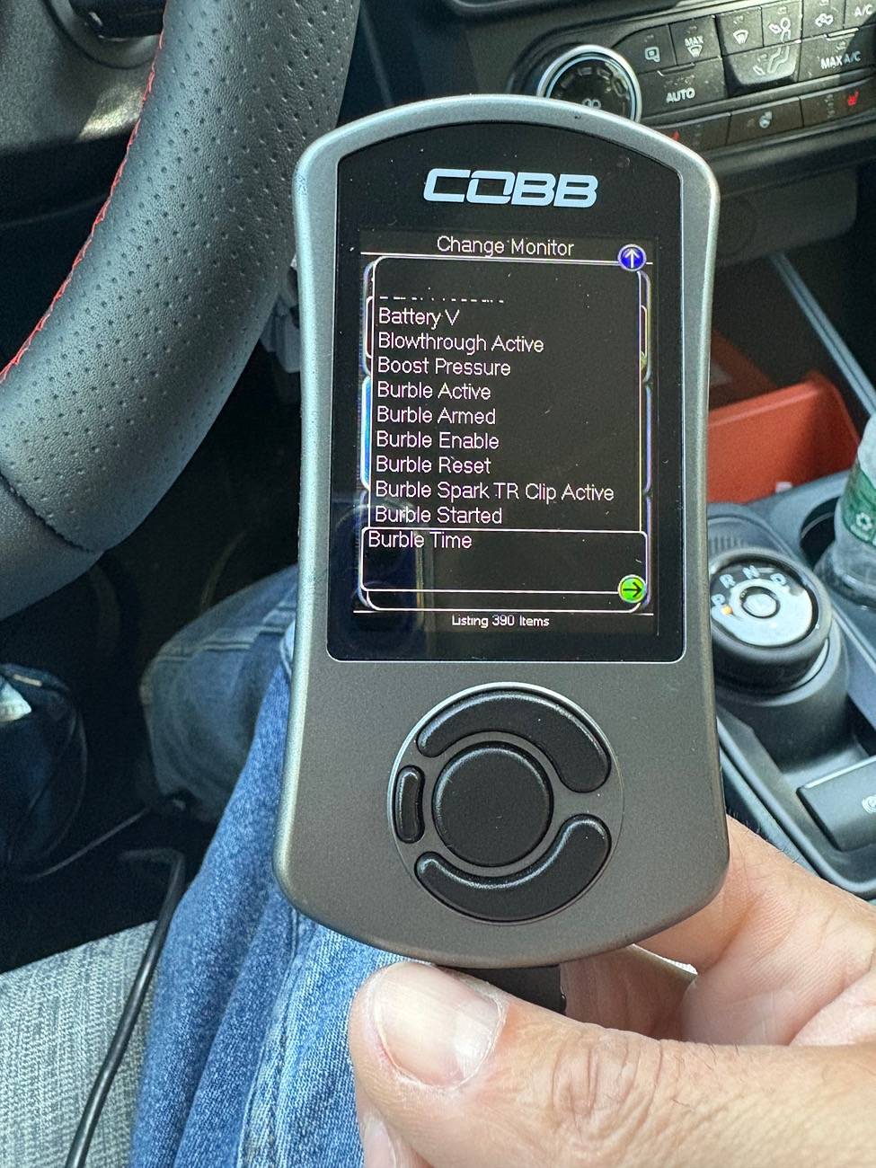

Question with the accessport. Mine has been working since last year no issues. I went to update the software and noticed there was something in there saying enable burble or something to that effect. Has anyone seen or used this??
I’d like a little popping on decel.
Any pics of this? I haven't looked at that section on mine in a while.

Here’s the pic, sorry for the delay.
That is just a monitor that exists for data logging. I believe Cobb just includes a complete list of what Fords can data log. That doesn't mean that it's in settings. If you look it says monitor at the top.

wild. that's the gauge widget chooser isn't it?
yes
Ah ok.
