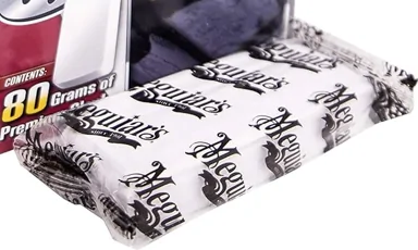

Yes, clay before you wax otherwise you will seal in the grime. Machine polish is nice but clay is sufficient for a truck. It will look great with wax. I clayed my Maverick the first week after I bought it but it had been on the lot for a few months. First I did a full wash with a pressure washer and rinse with DI water and it looked great.
Then I took a brand new Meguiars mild clay which started out like this:

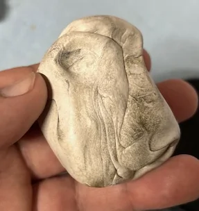

and ended up like this:

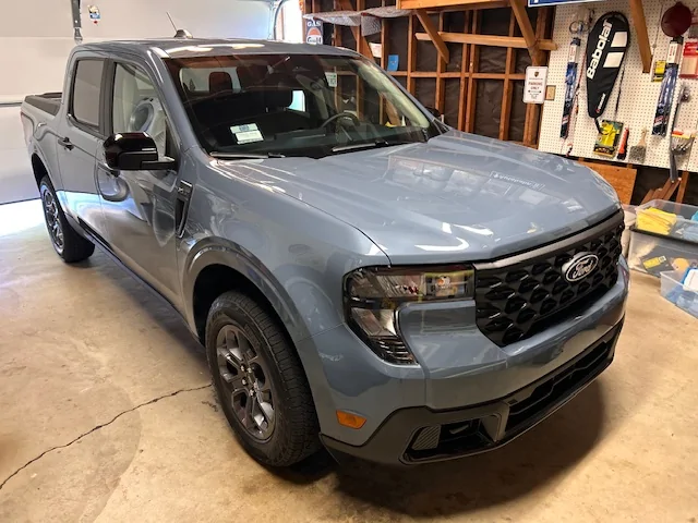

but the result was worth it!
