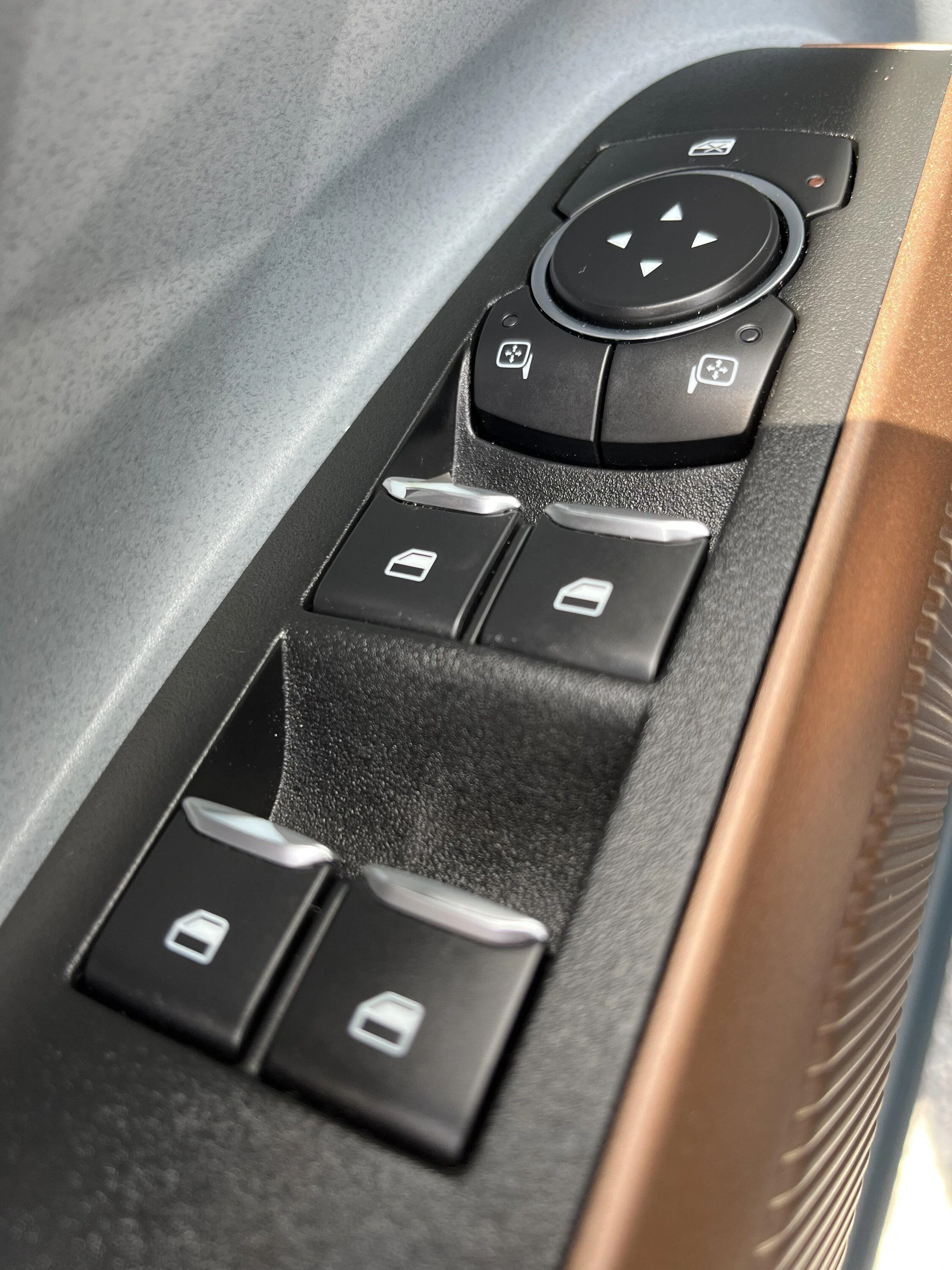

First thing that has “broken” on my Hybrid Lariat. I always felt the chrome tips on these switches felt “sharp” , but with no visual defect…yesterday they broke and even one of the switch tips came off.

Multiple breakages? I don’t see any breakage in the picture.

Yup, just had those replaced on my ‘20 Escape.
My ‘17 Fusion, that I traded in and has the same switch bank, never had a problem.
When I had the Escape done, the service manager said it is happening on a lot of the Escapes. I just figured it was a bad batch that got sent to that plant once.

Yep mine just flaked off yesterday. Off to the dealership.

Just noticed mine today and wondered if anyone else was having issues. 22 Lariat with 25k miles.

Yup. Just had mine replace a couple weeks ago.

Hello, I’m having the same issues. Does the warranty cover this? Thanks, is it an easy fix?

It is covered under the bumper-to-bumper 3/36.
There was also a ‘recall’ like notice sent out, at least for mine, saying there was a one time replacement for longer than that.
They just swap the entire switch module, but they do have to take off the door panel.
Your dealer should take care of this for you.
