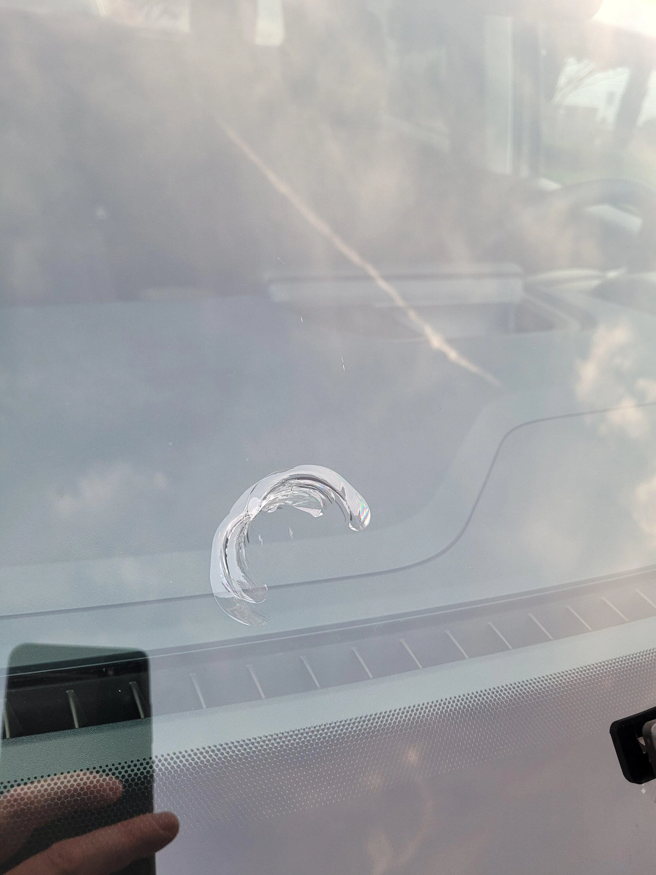

In the interim, the windshield got hit by what looked to be a metallic cylinder (D battery?) on Tuesday and got a replacement this morning. Unfortunately aftermarket going through insurance, and apparently the 2023 Luxury package includes a wiper de-icer that needs different windshield. At least it was in stock as an overnight.
Ford Maverick Check engine light before 2k miles - P2282 Air leak 20230905_191318

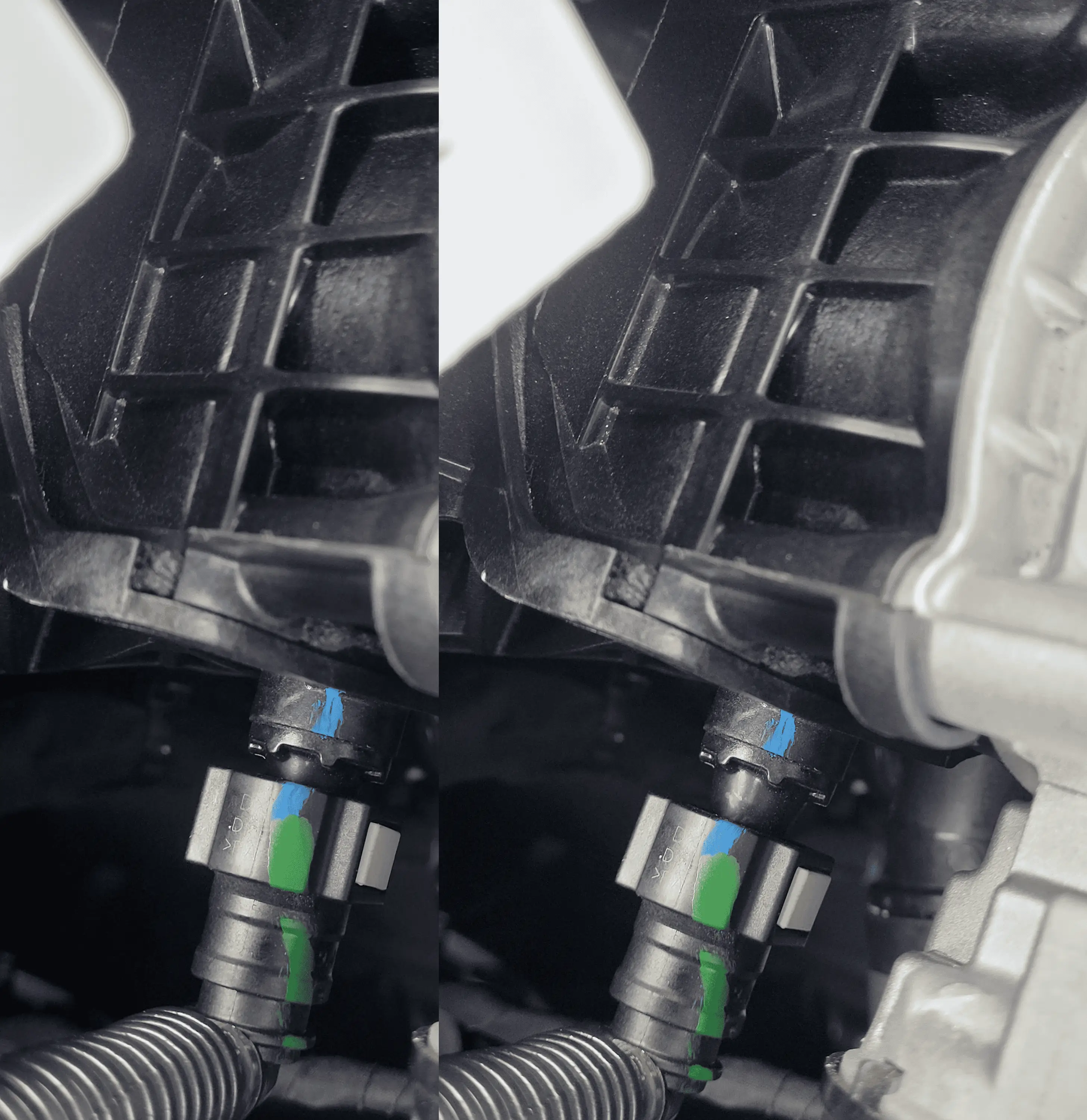

FYI, here is the amount of play on the hose connector after the throttle body. The white/grey retaining tabs are still fully engaged and it doesn't pull off. Can anyone else with a hybrid confirm this is normal for this connector? There is an o-ring inside the connection.
Ford Maverick Check engine light before 2k miles - P2282 Air leak hose travel
