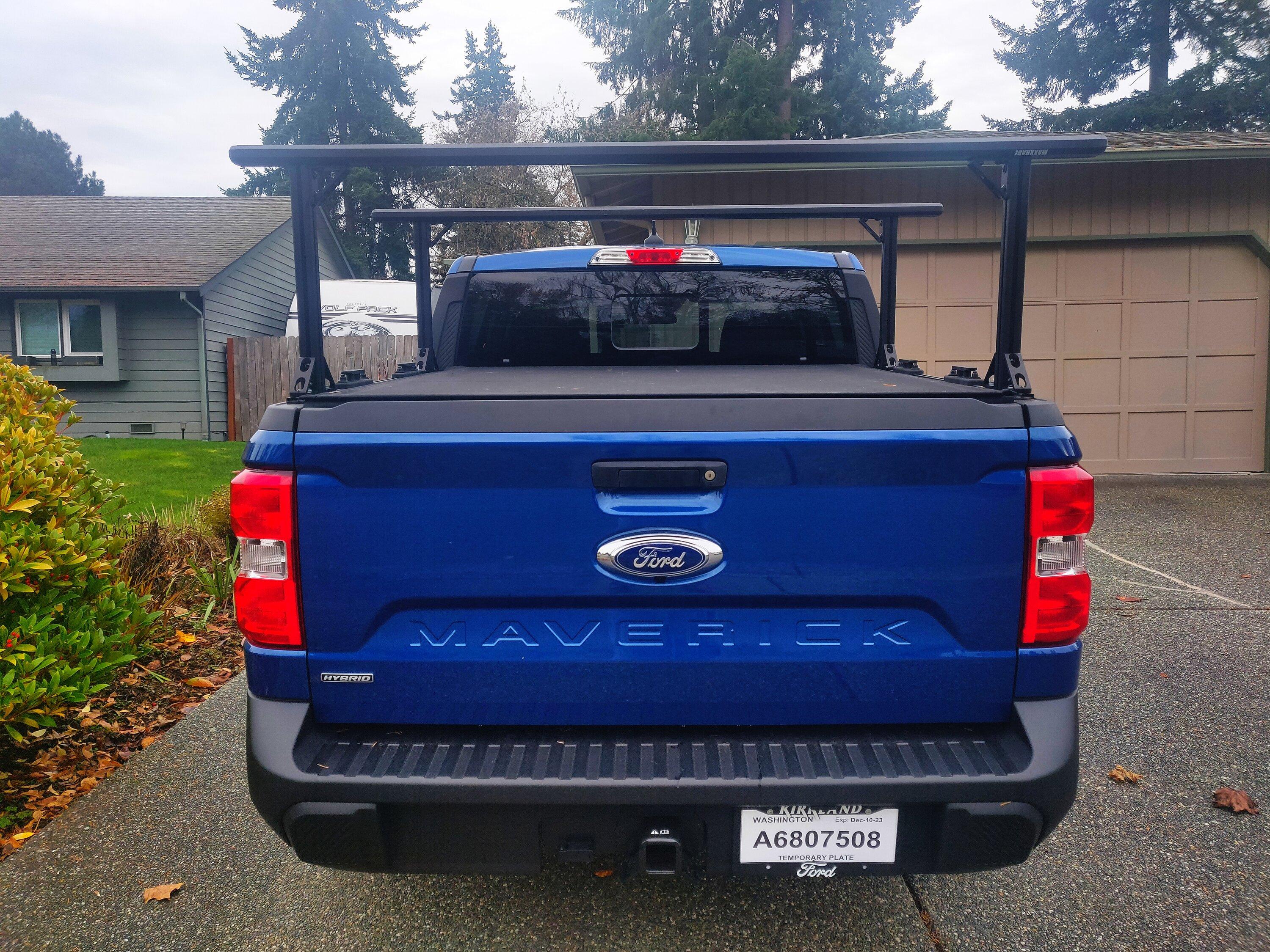

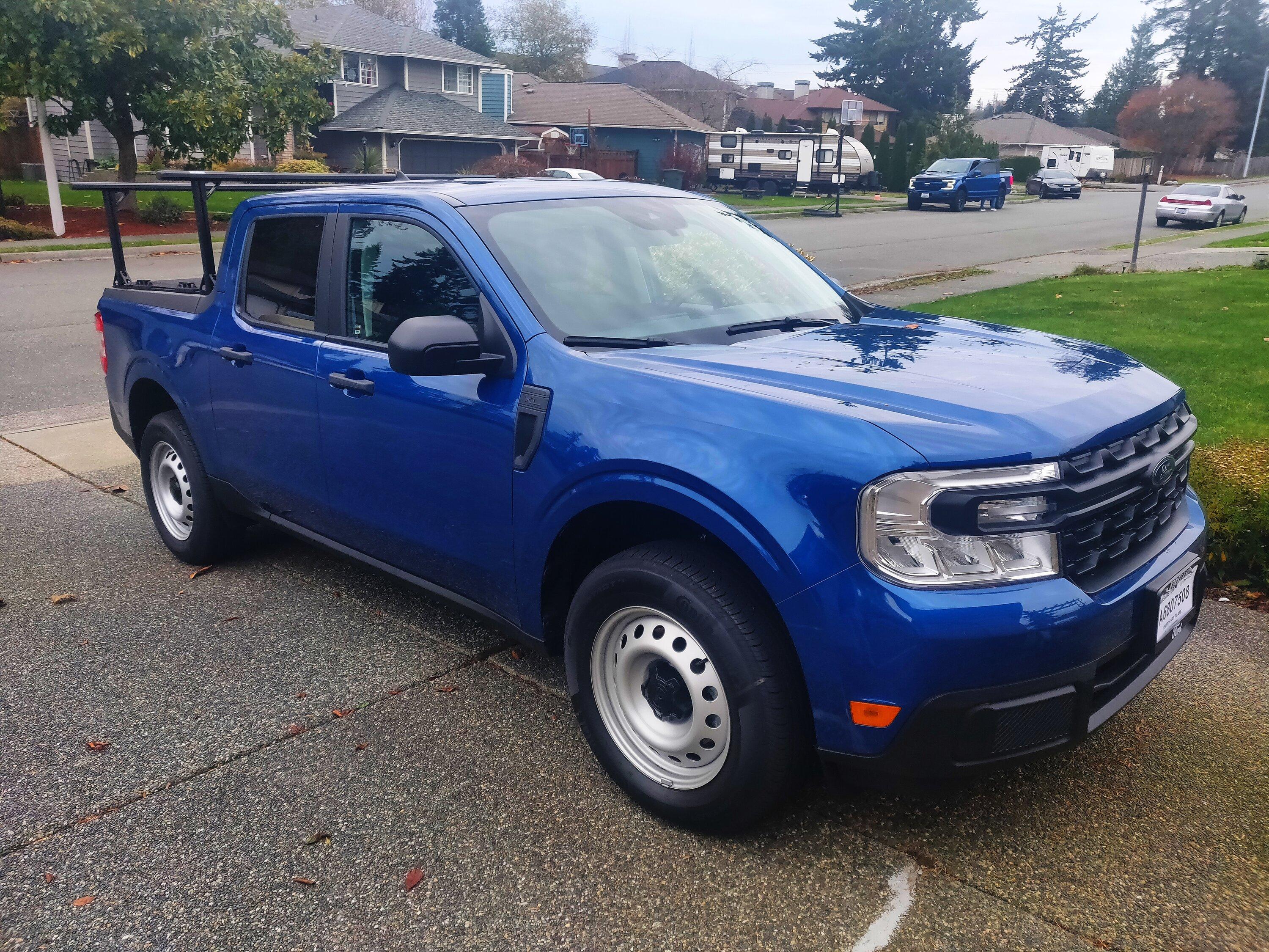

I've been looking for the cheap bed rack which will work with my Truxedo pro x15 for the last two years. And didn't find anything.
Truxedo cs is the most popular option here, but still 900 USD +.
The other racks doesn't work with the cover.
So I found this simple solution on the jeepgladiator forum and decided to adopt it for my Mav.
https://www.jeepgladiatorforum.com/...t-slot-rack-for-bak-revolver-x4s.59111/page-4
Bought 1.5" t slot beams, brackets, fasteners, can of loctite from mcmaster and pair of cheap cross beams from Amazon.
https://www.amazon.com/gp/aw/d/B09NZPDZZ1?psc=1&ref=ppx_pop_mob_b_asin_title
It took less than an hour to assemble it and install on my truck.
Here is the result.
It's sturdy and my kayak will definitely fit there.
I didn't feel any excessive noise on the highway and don't see any drop in fuel consumption. At least so far
PS: Sorry for the duplicated last photo. Looks like delete button doesnt work on this forum
I like this, Looks like on your 4 risers you got the slots on 3 sides and flat to the outside. It is available with slots on 4 sides which would give you a fastening point on the outside for accessories. Just a thought. This is a very wallet friendly way to go with the Amazon crossbars and even with the t slot rails you need to also have a tonneau cover. nicely done.

Yep, it's definitely flexible. You can attach as many tight downs as you need. Or just remove unneeded

I see in your photo you added another brace over the gusset. Looks like you removed the cab side gusset to get the rack closer to the cab.

Yep, I did. Still playing with this thing. This additional brace isn't needed, I added it just in case

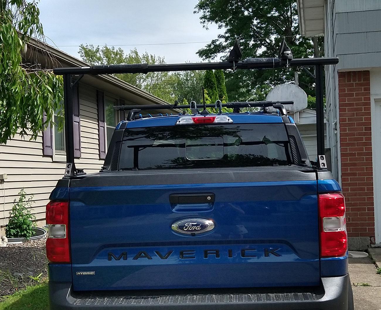

I also got the 68 inch long bars. Cut 4 inches off it. I used only one bar. I have Yakima roof bars too. I haul long kayaks over 16 feet. My setup used Tnutz upright bars.
Hey Dan,
Also going with TNUTZ on all the hardware and it looked like I could shorten those crossbars a little. Looking to carry 2- 12' kayaks. Like your set up. This is a very cost friendly way to go. Thanks

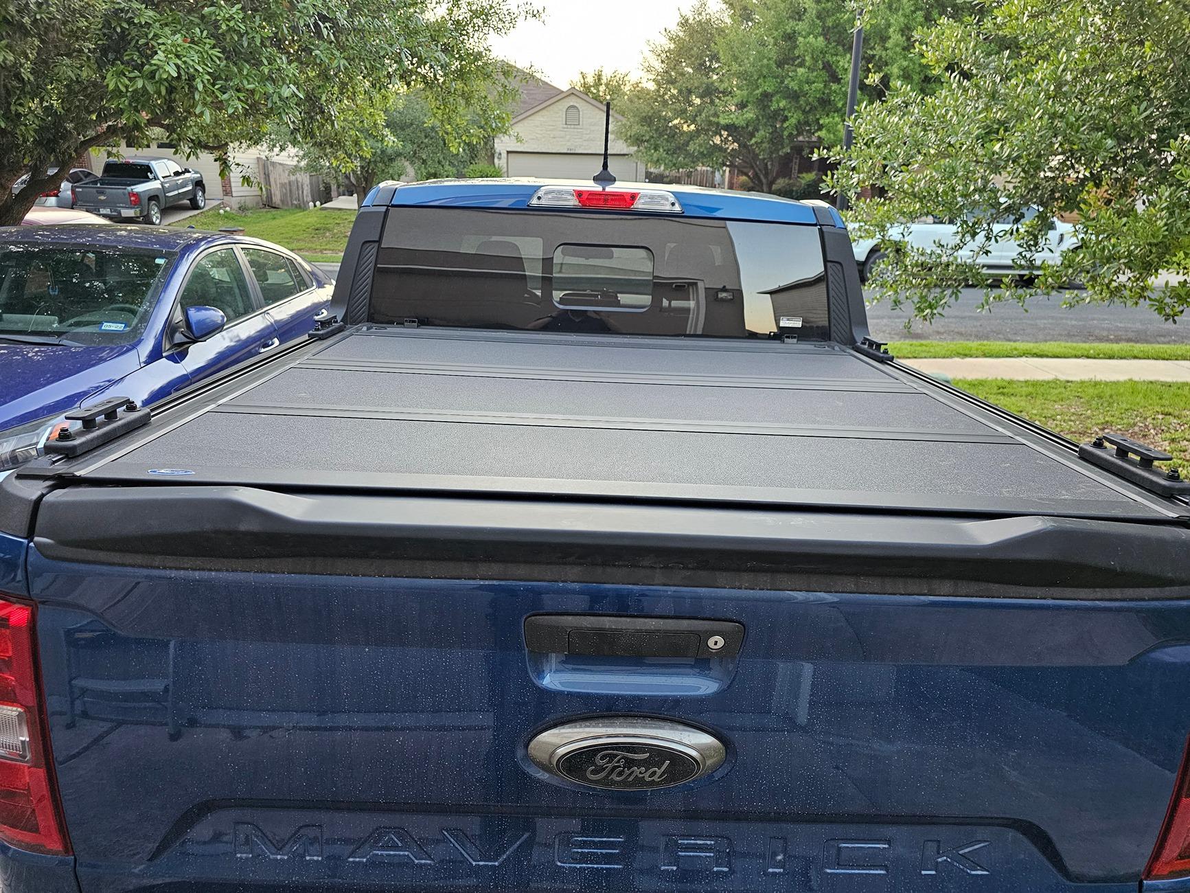

I have the Ford hard tri-fold (I'm pretty sure it's rebranded but I can't remember what the other forums users said it was).
Do you know if it can have rails?
I have the Ford hard tri-fold and a set of Elevate TS rails.

In this last pic, it looks like it is a DIY roof rack. Is that what it is? If so, are there instructions?
