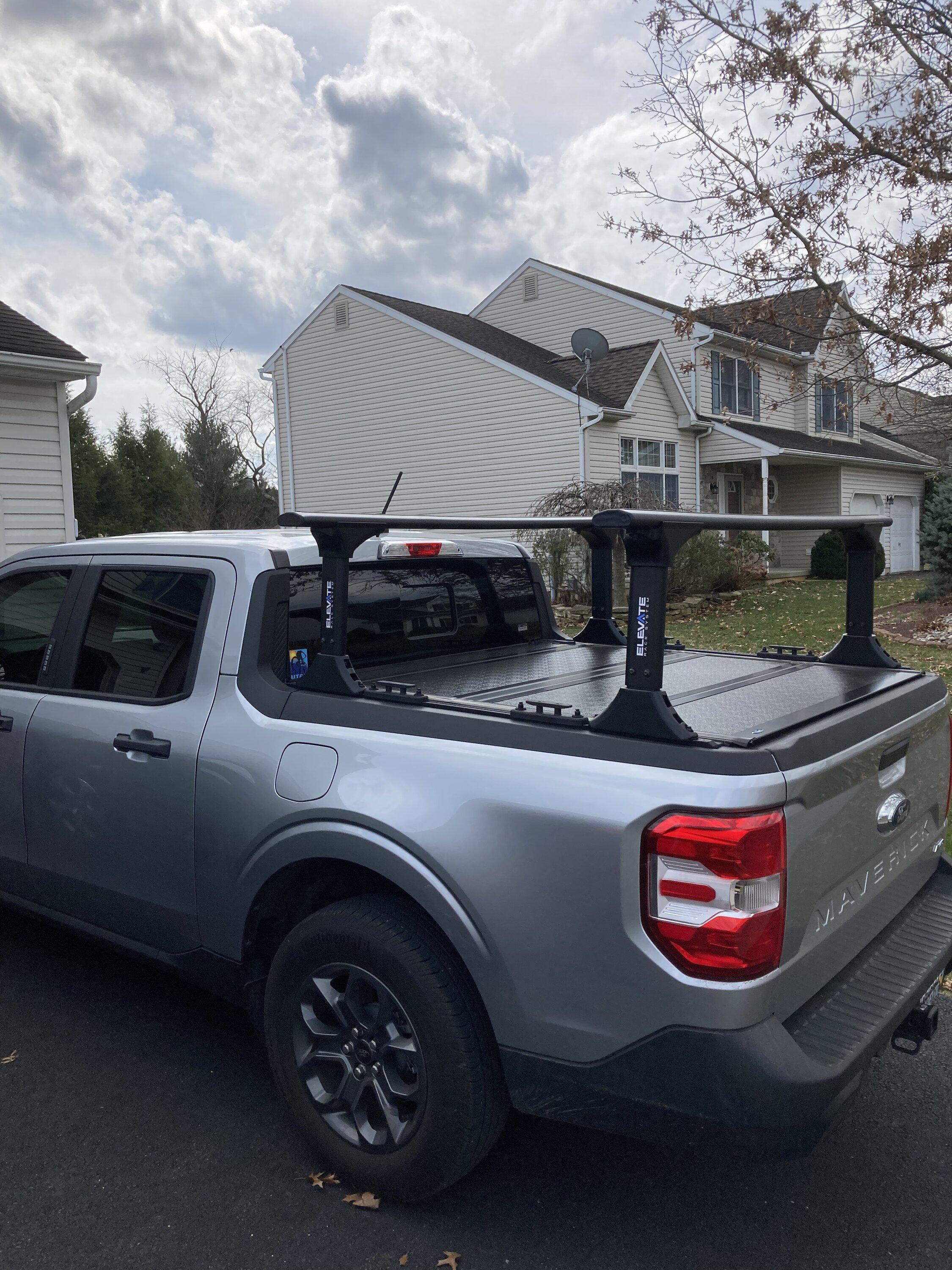

Does the 3rd fold (upright against cab window) clear the front rack when in the lower position? I just installed my MX4 with these racks, and the MX4 can't completely fold open... it's about an inch too tall.

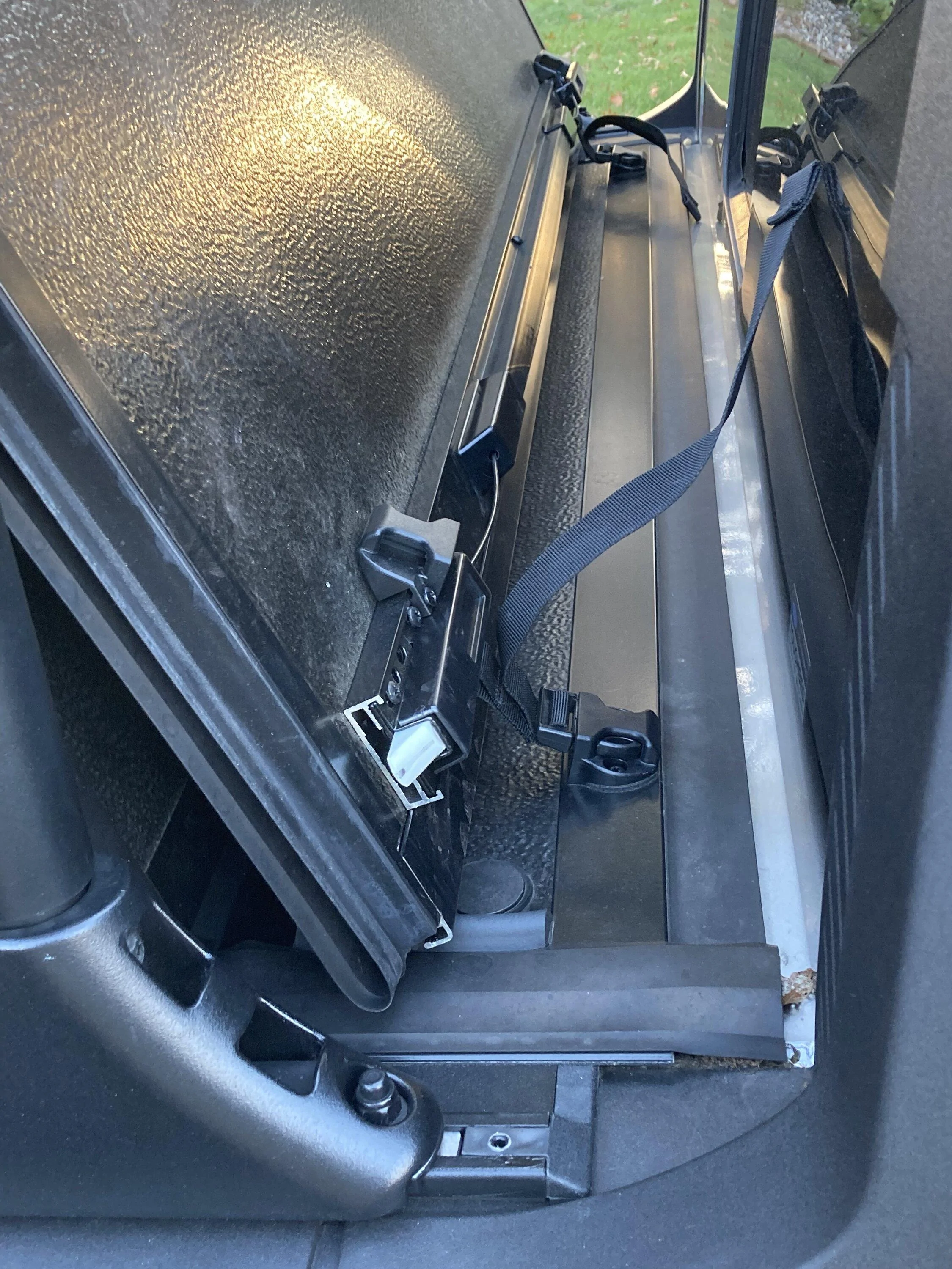

Unfortunately I have the same issue with the Ford OEM hard trifold. I can’t complete the last fold against the cab. When the racks are in the lowest setting. I resolved the issue with a partial solution for the few times I needed full bed access. I fold the cover against the racks as far as they will go and then attach the cleat/buckles and pull them as tight as possible. I wouldn’t suggest this for a long ride in a highway but it has worked okay for a few short trips where I needed. I attached pics showing where my cover hits the rack, and then my partial solution. You could also drill new holes for a custom height as in this other post from today -

Unfortunately I have the same issue with the Ford OEM hard trifold. I attached pics showing where my cover hits the rack, and then my partial solution. You could also drill new holes for a custom height as in this other post from today -
https://www.mavericktruckclub.com/forum/threads/tonneaus-with-rack-rails.22138/post-419198
I wil
Ford Maverick Bed rack that works with hard folding tonneau? PXL_20221019_150306953
l probably modify height on my elevate posts. Until then, I will fashion/3d print a small clamp that can secure the build in tonneux support rods at that position

I wil
That’s a great idea. If you are able to work out a viable 3D print solution, I’ll buy a set from you if you make an extra pair 😎

I have the Elevate Rack/Rails with the Ford hard folding cover and can confirm the setup works
How quickly can you remove the rear most cross bar? Like if you had to get a fill of mulch and need it out the way?
Hammer
Sep 28, 2021
372
534
Easton PA
2009 VW GTI
you could do it in 2 mins or less. Only requires removal of 2 cap-nuts on each side with 1/2“ socket and then lift off the entire tower in one piece.

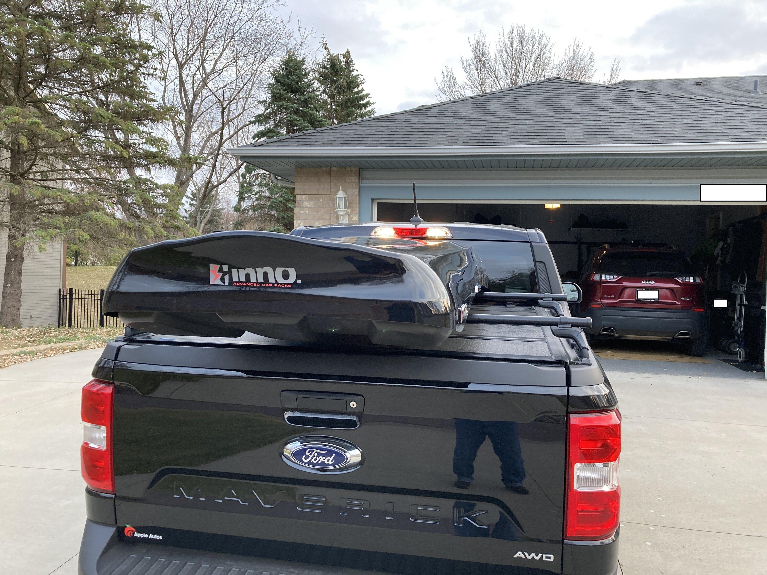

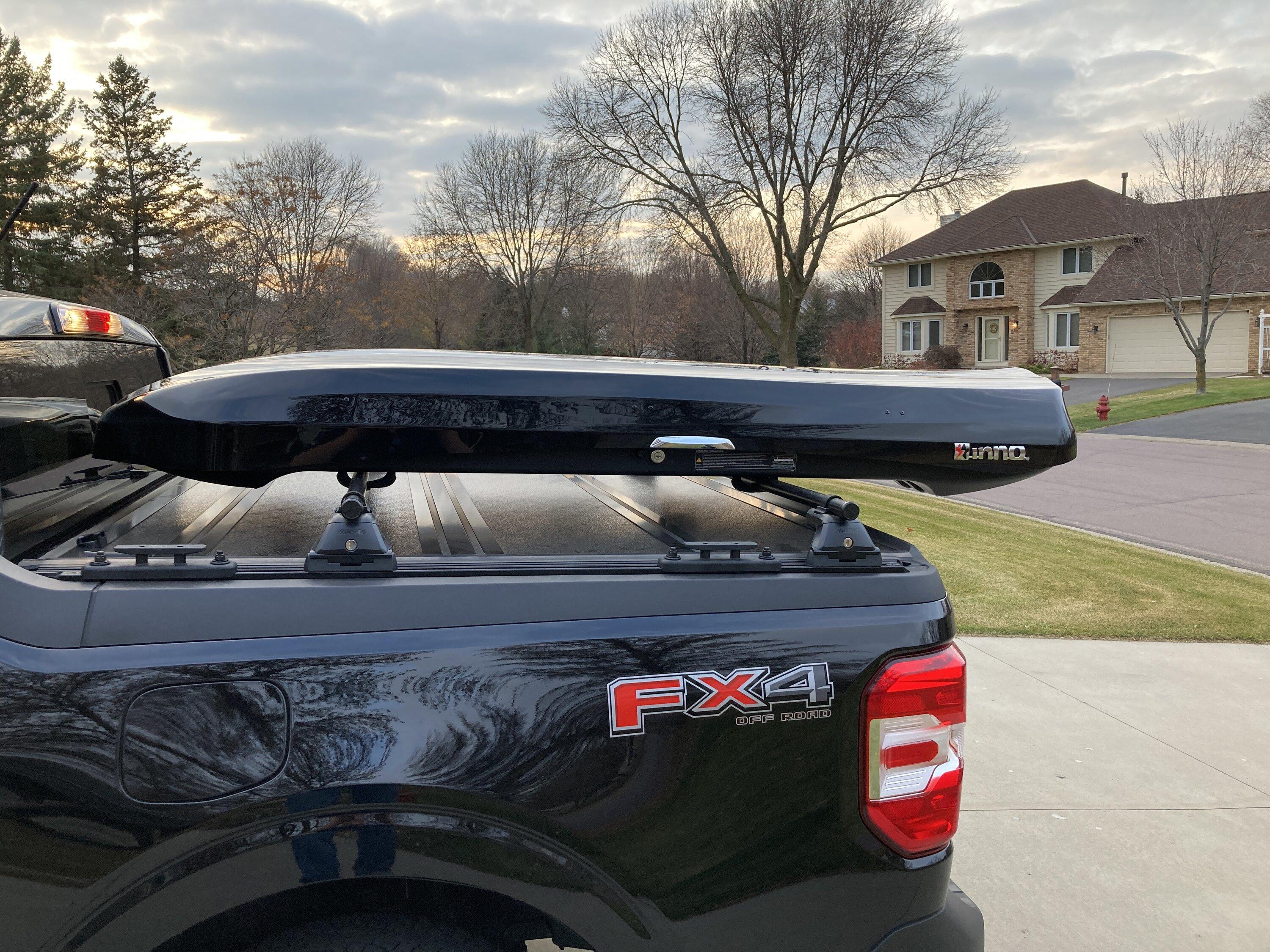

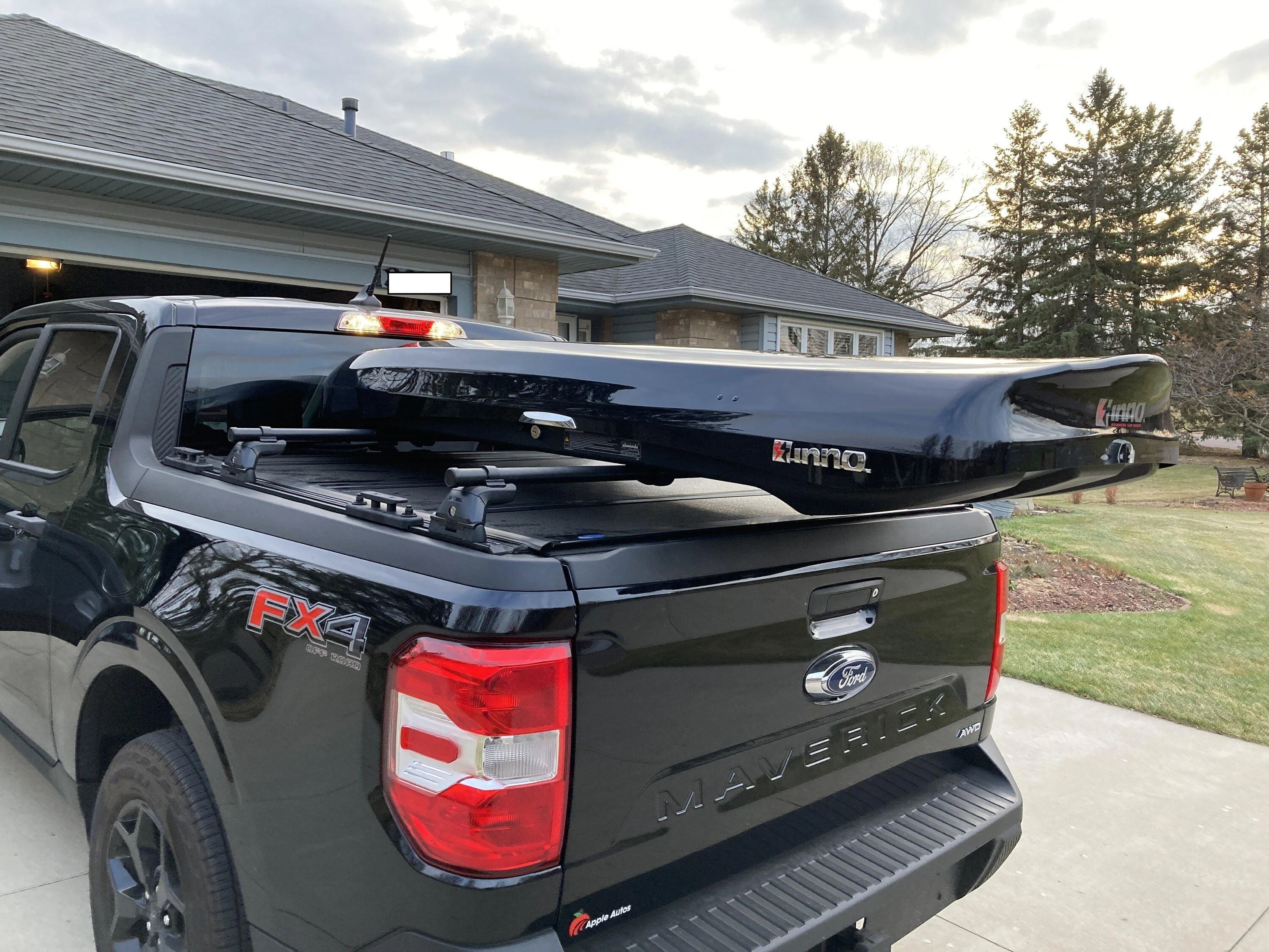

I'm kind of regretting ordering the hard folding tonneau cover, I need a rack system on the bed so I can but a clamshell for ski's on it. They just are not out there in a low profile that will work with the tonneau cover. Anyone know of a solution?
You could get a T-bar for the hitch and a roof rack. I do that for my canoes.
