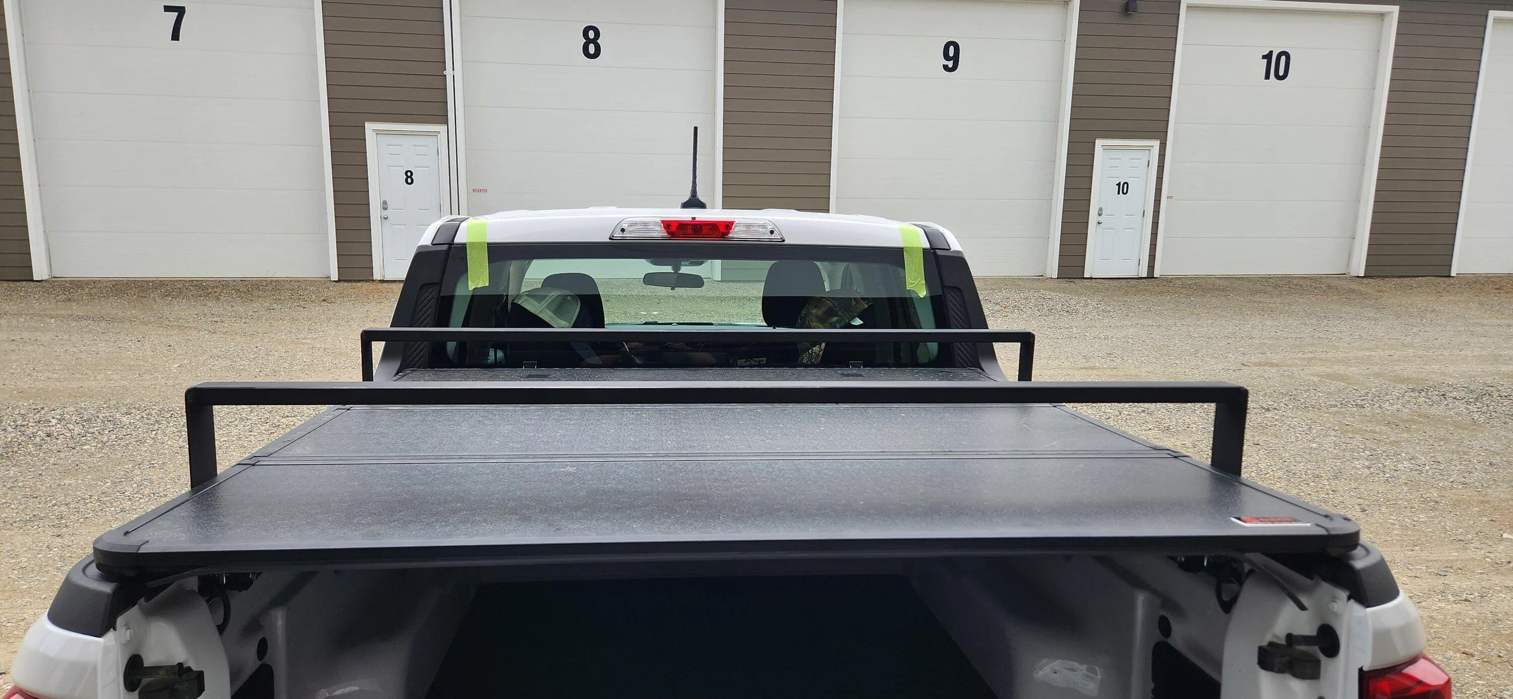

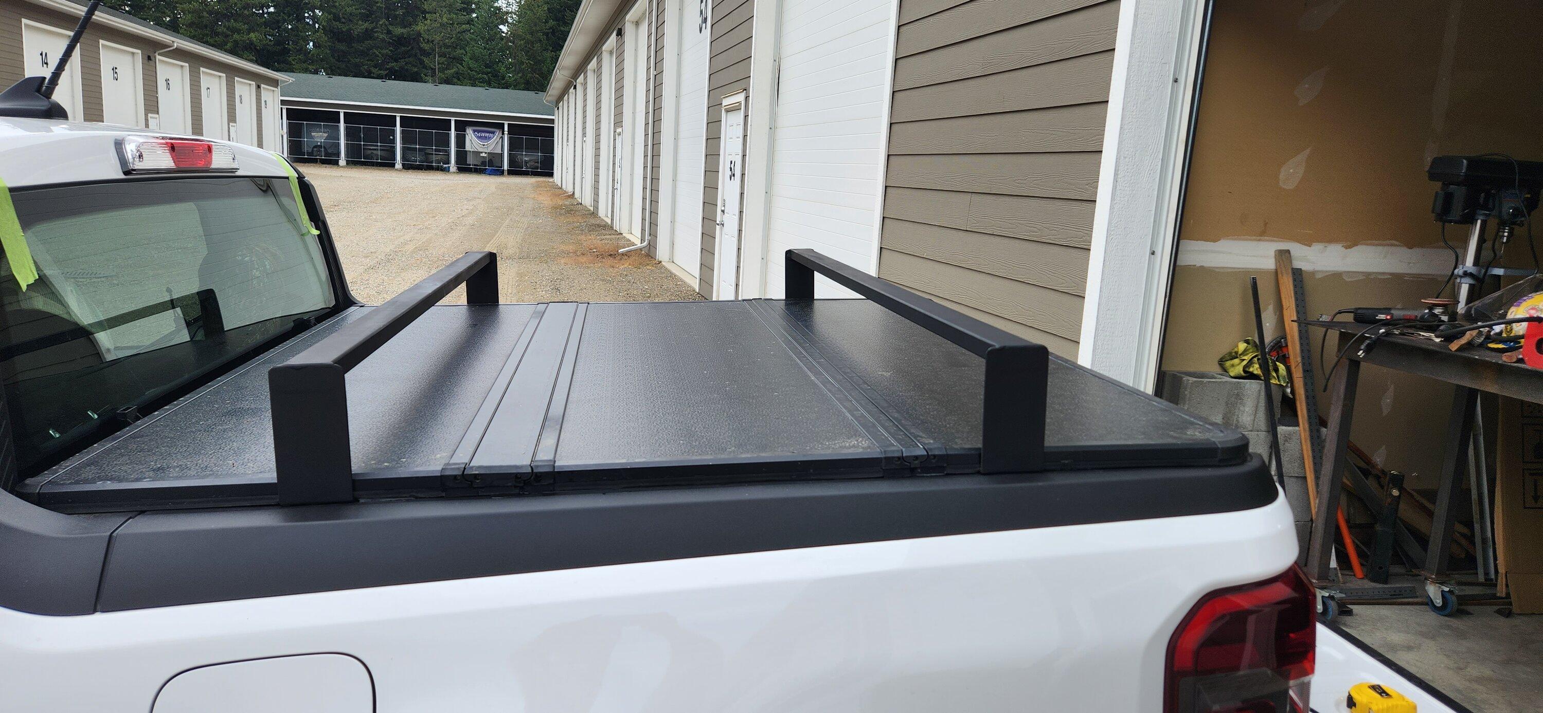

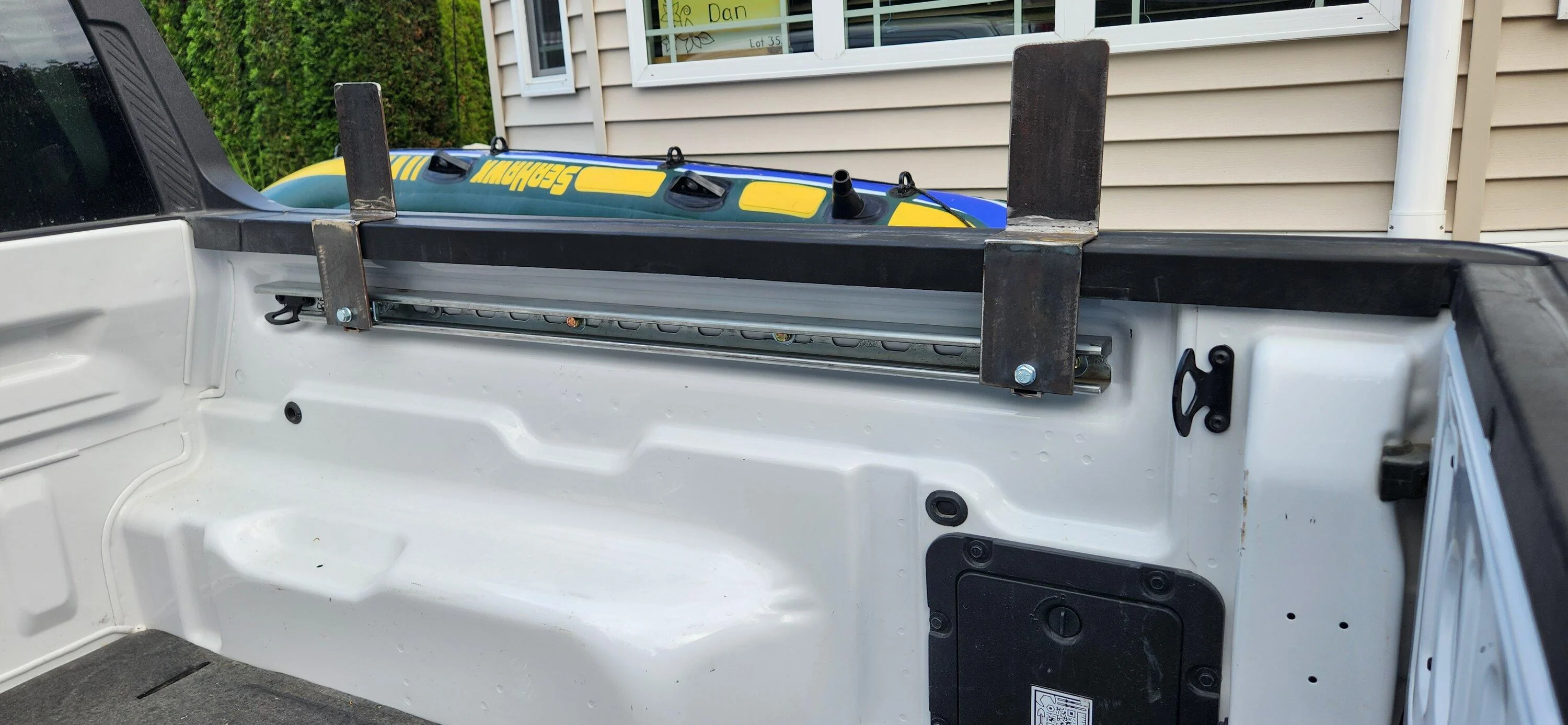

At the risk of embarrassing myself, can I ask how the hard tonneau folds-up, since you mentioned that the cross-bars are welded on? Maybe a pic or 2?
HRG
Eagleclassic
Dan
May 2, 2023
British Columbia, Canada
2023 2.0l Maverick XLT
It doesn't fold when rack is on. I slide the cover u Der and store underneath.
At 4'6 it's not hard to reach to front.
I was going to bolt bars in, but thought I would rather reach under anyway.
Takes 2 minutes to strip it all off if I want to haul anything.

ford
