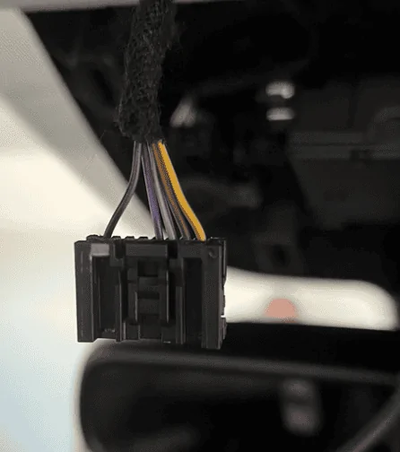

Anybody know where to buy one of these plugs, with wires attached.

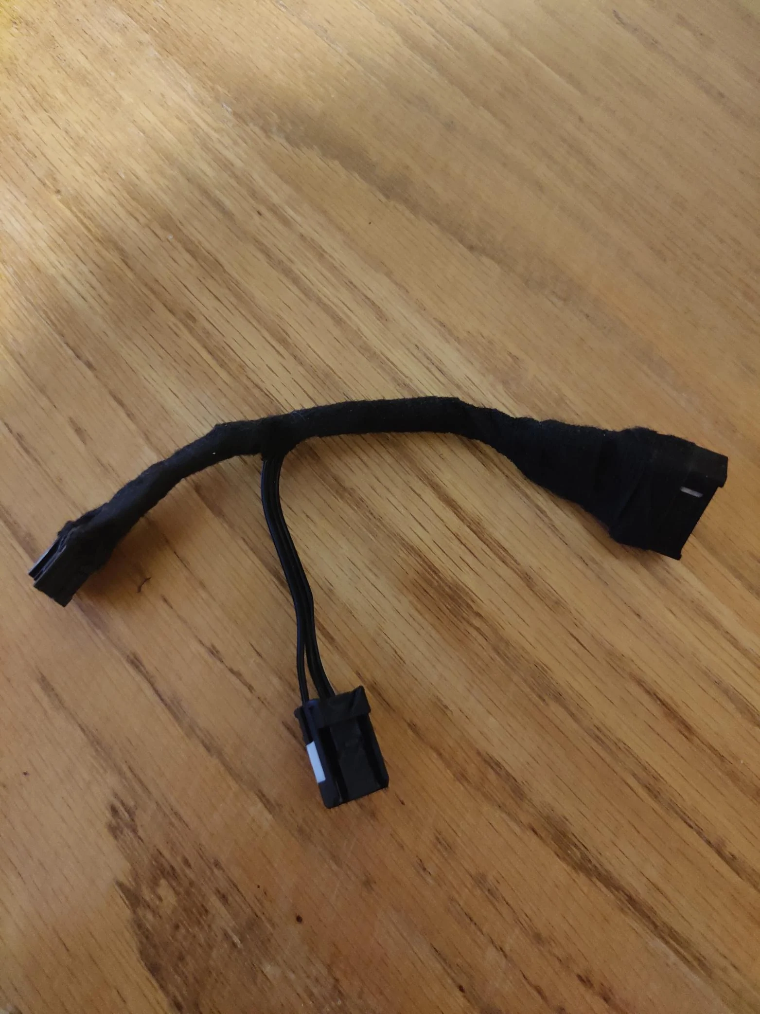

I just built a patch cord with parts from Mouser Electronicsand some 22ga wires.
You need:
1- 538-34792-0080 Female 8-pin socket that fits the above male plug
1- 538-34791-0080 Male 8-pin plug as in your picture
10- 538-560023-0421-LP Loose pins
5 - 6" pieces of 22 ga wire, multiple colors preferred for ease of not screwing up
5 - short pieces of heatshrink tubing for keeping the pins insulated on the back side of the female plug
A roll of cloth tape.
A soldering gun
Mouser shipped quickly and it was less than $20 total for these connectors and pins, along with a 12-pin set as my first plan was to use the 12pin connector in the camera section instead of the dome light. But this was easier. I ran my Kia mirror plug to the purple (switched on) and the black (ground) wires in the patch cable. I will likely tear it open to add more for my dashcam.

my issue is i need to cut the existing plug as I connected the wires too short. my install works, but it seems to be wired wrong.. Everything seems to be powered all the time.. I wired black/white from the mirror to yellow/back, and black from the mirror purple.. If I buy the socket, how tough is it to connect to the four wires, plus ground..
BradnChristine
Brad
Nov 3, 2021
43
2,463
3,078
Wyoming
Not sure exactly what you are asking as far as cutting. That male plug is easier to wire than the female plug. What is too short? The Ford wiring? The mirror wiring?
As far as power, I think most of us run the Kia ground to the ground (black) and BOTH the other KIA wires to the Purple. Purple is switched 12v; yellow is constant on. No need to have the homelink powered for me when I am not in the vehicle, with the ignition on.

i used wire taps to connect the mirror wires to the the male plug wires and cut them too short. If I get a new plug, i can cut the old one off attach the new ones to the existing wires and then redo the mirror wires (correctly this time). do I attach pins to new wires and them put them into the bare plus.. will I need to soder them in ??
