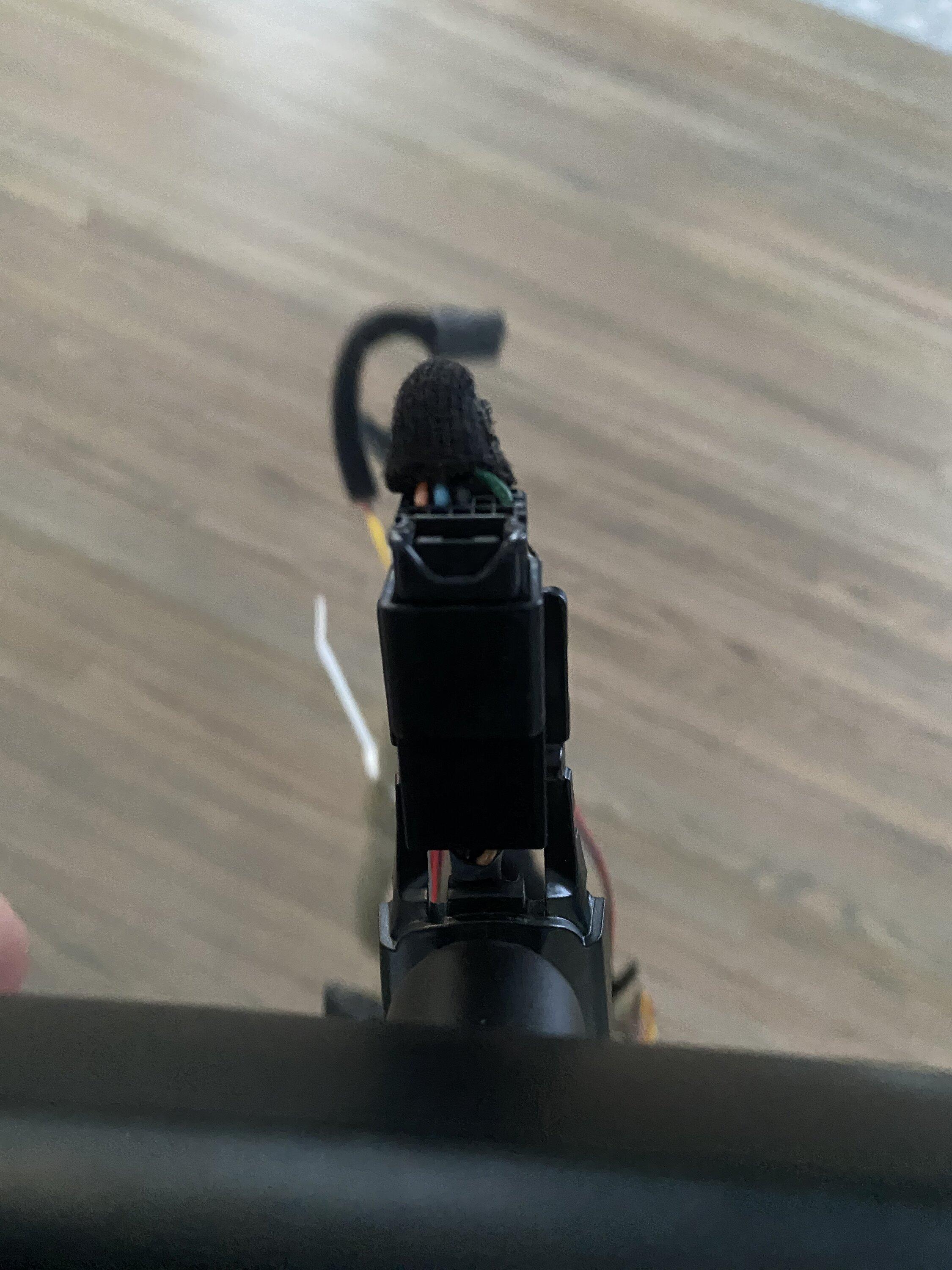

Has anyone installed this with 4 wires from the Kia mirror? Anyone able to advise which wires to use? I’ve got green, orange, blue and black from the Kia harness. I can take a better photo if needed.

All the information you asked is in this thread...
Hi,
Yeah, I read the thread, thanks.
I've seen different part numbers for different mirrors. Or maybe they are the same part number for the same mirror, I don't know. However, I replied to that user in particular, b/c they have a hybrid, so I wanted to order the specific one they got.
