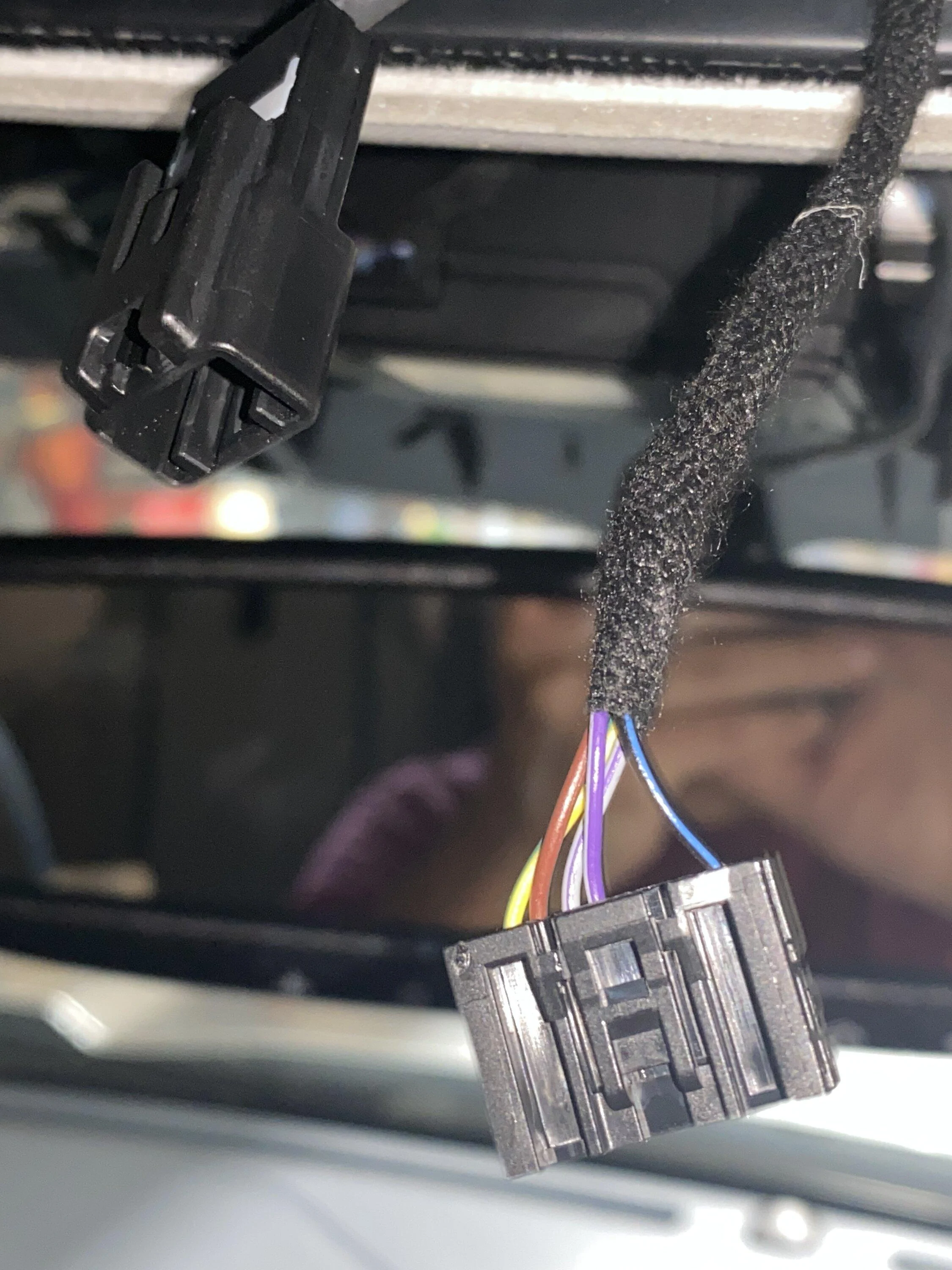

I am still trying to figure out what wires to use. I removed the dome light model and took a pic of the plug. Starting from the left:
Yellow/Green: +12v
Brown: +12v
Violet/White: +12v
Purple: +2v (?)
Black/Blue: Ground
I have not been able to find a switched +12v in that plug. Am I missing something?

The black/blue wire is your ground, the Purple wire is your (switch power) Yellow/green (last write on your right) wire is your constant power.
This was all written in my post.
All good. I appreciate the hand holding. I got it all installed and HomeLink working.

OK, I was able to install the Kia Mirror and tap into the wiring harness for the Dome lights. I watched a video on YouTube, and in the video, I watch the person telling which wires to use... Complete success. Had to make a run to O'Riely's to get wire connectors.
There are three "clips" holding the black cover on.
The second photo shows there is a "tether" connector that holds the panel (I couldn't figure out how to undo it)
We also took the cover/panel for the Dome light (I have a sunroof) down and disconnected the wires. I tapped into the wires for the dome light. The video I found did the same thing on another Ford vehicle and the same wires were there...
The black wire is your ground, the Purple wire is your (switch power) Yellow/green (last write on your right) wire is your constant power.
I used about a foot of the wire that came with the mirror, it was over kill but when everything is tucked back in place there is plenty of space.
In this photo you can see the green light is on the mirror, so the mirror is getting power. VERY simple and easy... Truly I could do this in about 25 minutes from start to finish.

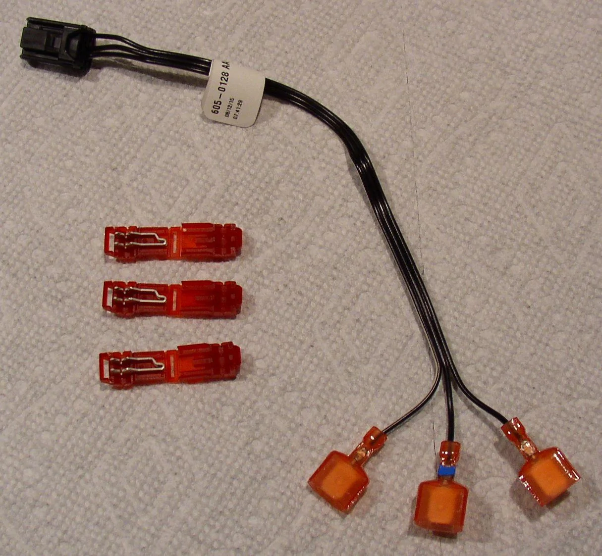

This is what I used to connect with the wiring harness.....

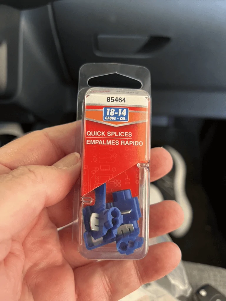

May you kindly confirm where can you get the red tool that you used to remove the dome light model? And, did you had to cut off the terminals from the wiring harness to properly connect with the(blue) splices? Your image #5 shows the wiring harness already connected, however I'm curious if you cut them off or left them. Thank again!!
Ford Maverick Cheap auto-dimming, homelink mirror Taps and Harness
I shortned the harness, not sure what you are getting at about the blue wire.

Awesome! Thank you for the link! I was referring the blue splices from the image you posted below:
Yes I cut them off your connector is shorter than mine... Mine was about 2 ft.
