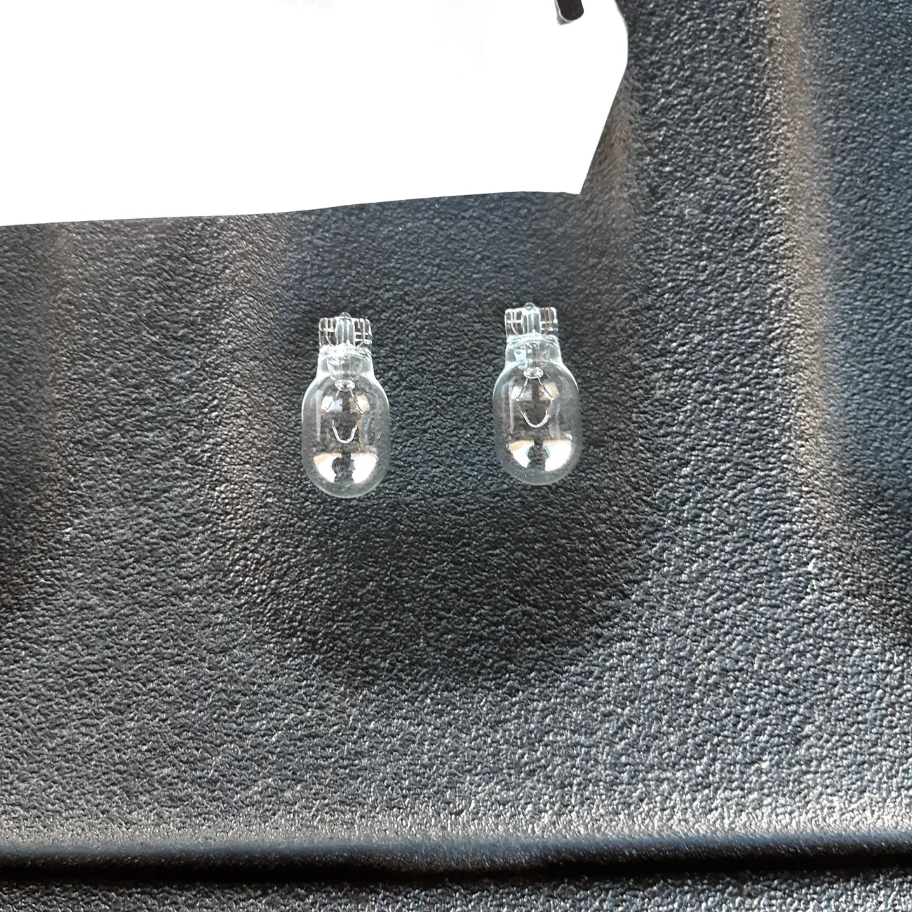

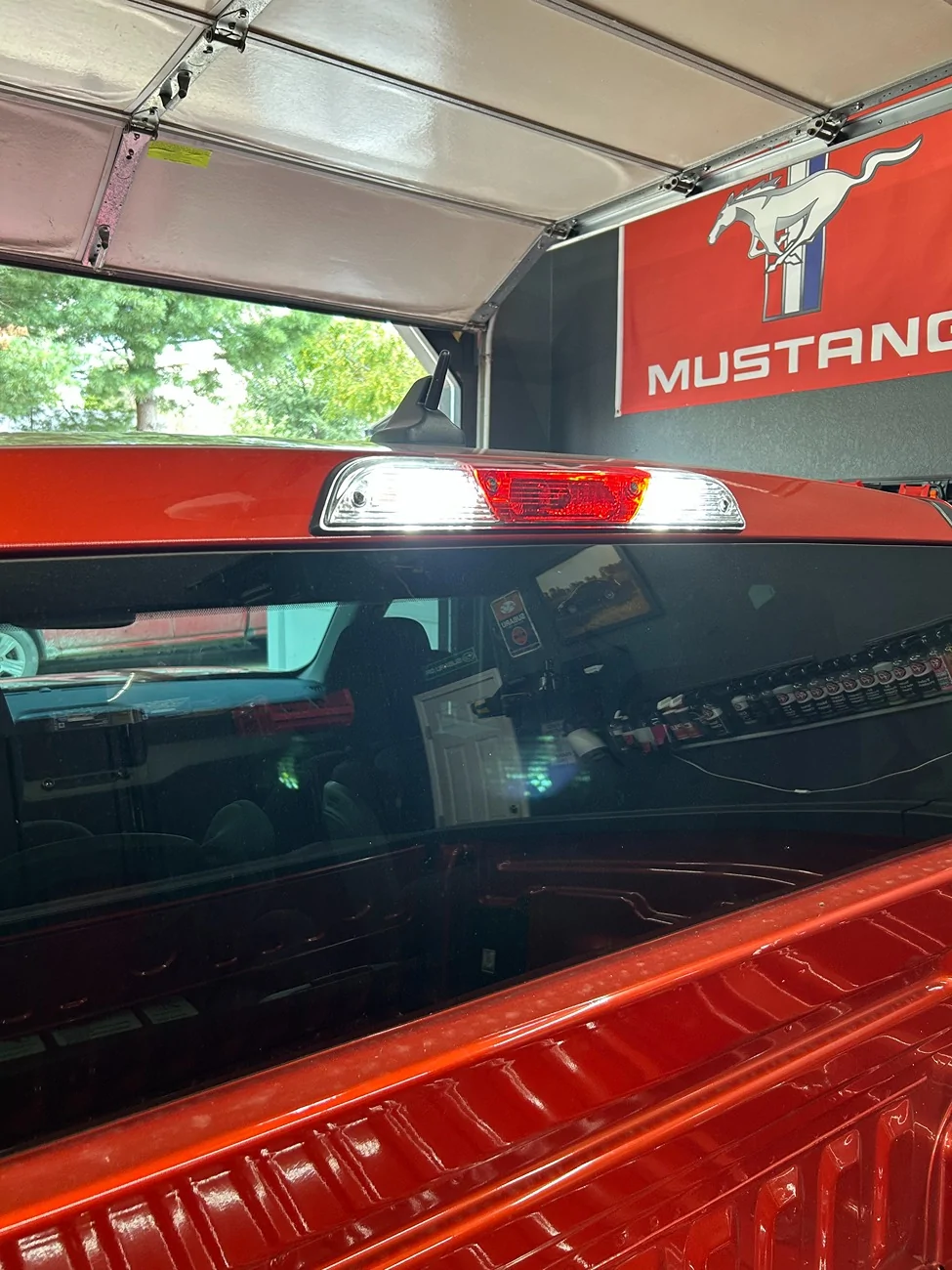

Luckily mine showed no signs of distress, but I decided to go ahead and swap the bulbs out to LED. I went with red for the center, but all the factory bulbs were the same so there is no reason you couldn't just order all in white. You will need a T20 bit, and take care because they don't give you any play in the wires! The results were worth it, the new bulbs are much brighter and whiter.

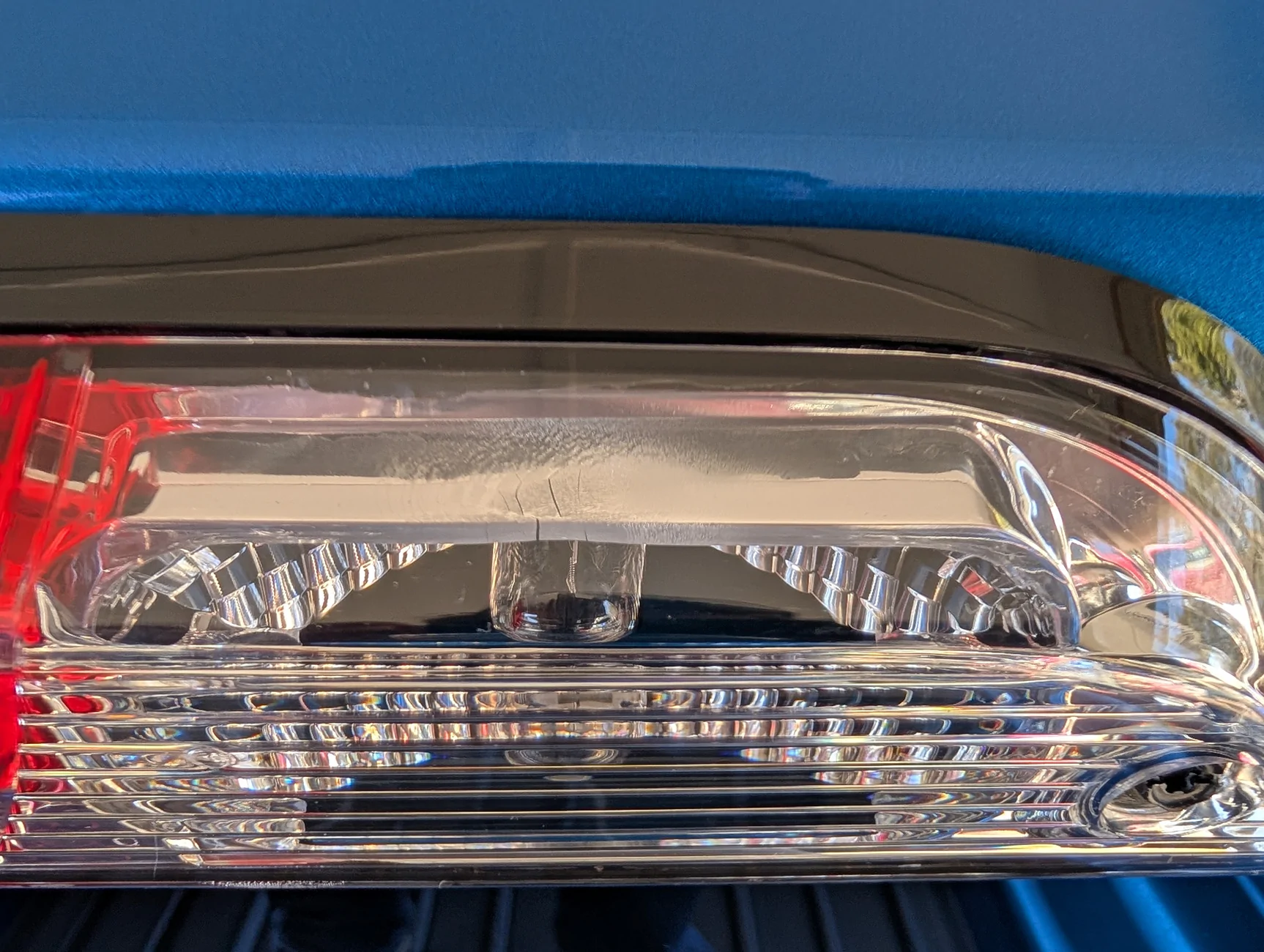

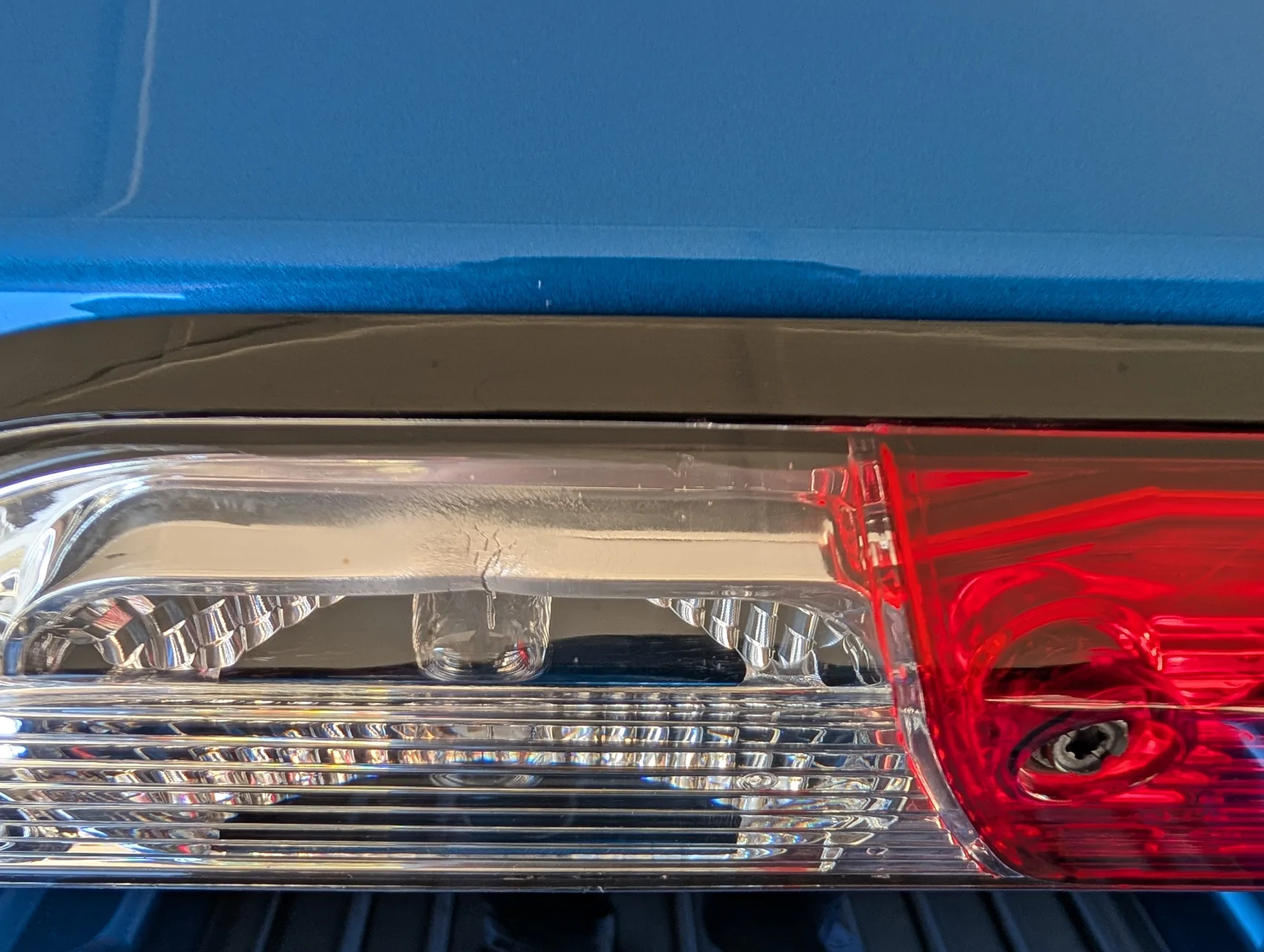

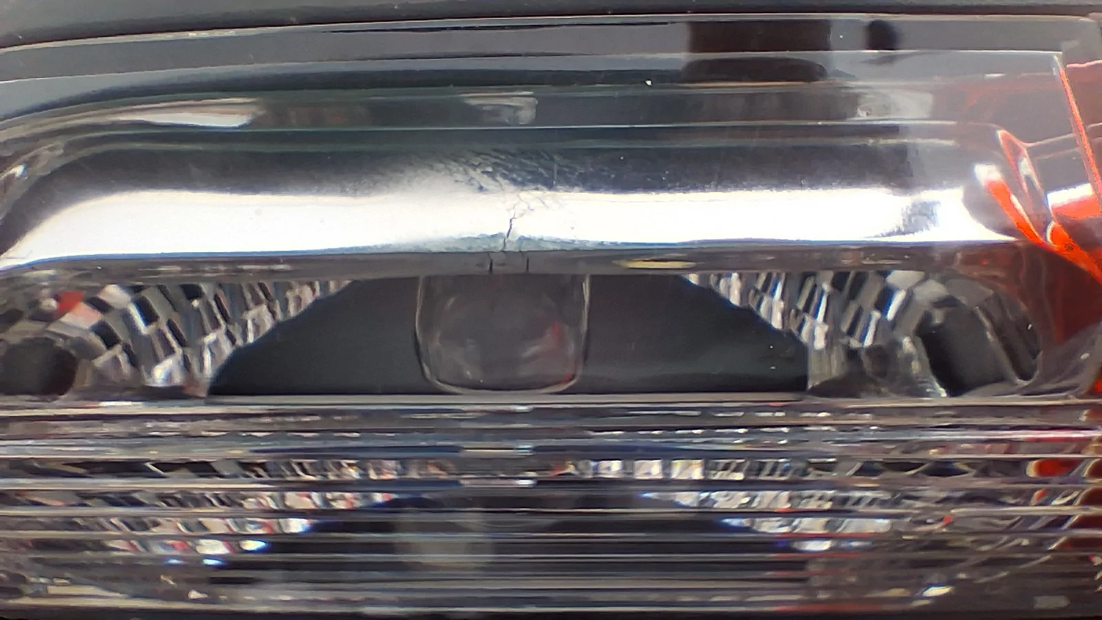

Update!
The dealer did replace the 3rd brake housing under warranty, but creased the headliner and left dirty fingerprints on it ☹
Ford Maverick Cargo light internal housing is melting/cracking PXL_20260306_130911426
And then..
The newly replaced 3rd brake is already melting again!
Ford Maverick Cargo light internal housing is melting/cracking PXL_20260516_162028507
Ford Maverick Cargo light internal housing is melting/cracking PXL_20260516_162036079
I actually already own the Lasfit LEDs, but haven't installed them in case it causes my local Ford shop to not honor the warranty repair.

Did you look at it immediately after the dealer replaced it? I'm curious if they are coming that wy from the plating process. Second question is why they needed to mess with the head liner?
ctag
ctag
Apr 29, 2025
112
288
1998 Honda Civic, 2025 Ford Maverick XL 4K
I did jump up in the bed and look at the new ones with one of the dealer techs after they replaced it, but I must not have taken any pictures because I can't find them. The tech said they had to pull down the headliner to do the swap, I expect there's a power connector hidden up there.

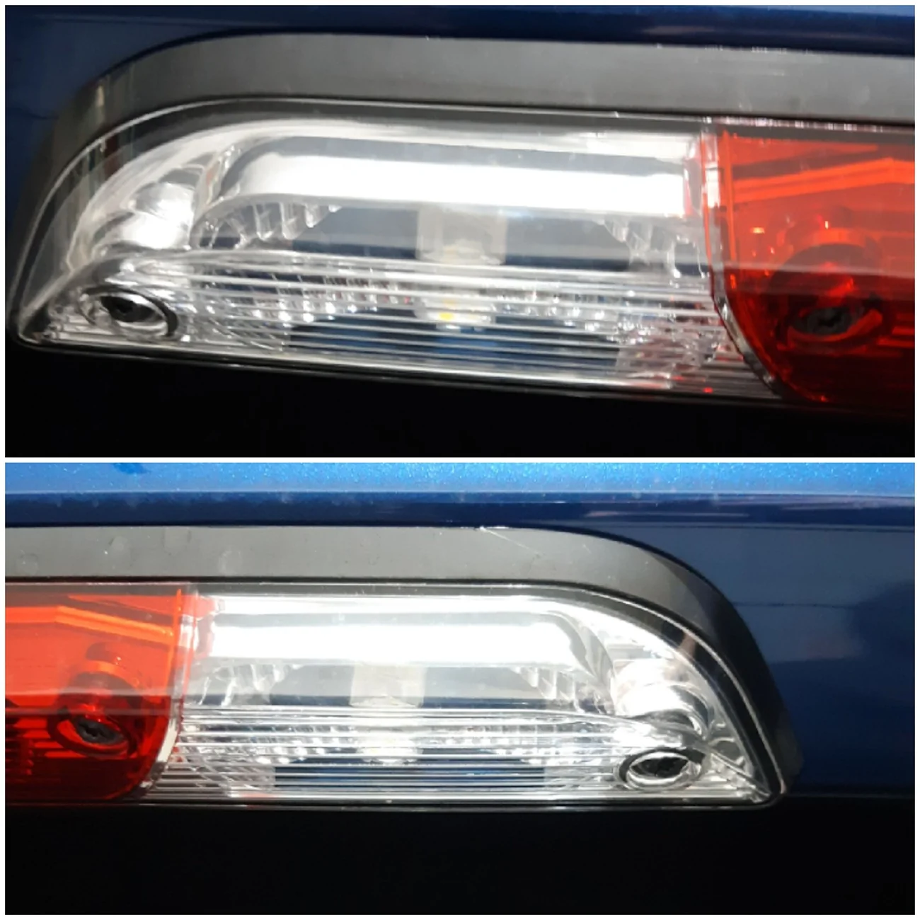

I'm replying to myself lol. I installed the Lasfits recently, and when replacing the bulbs I could see my housing was at the very beginning of melting (very slightly distortion), so I'm glad I replaced them.
