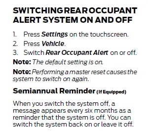

I tried the seatbelts buckled thing, but it had no effect. I'll have to dig into the menus on the steering wheel. I swear I didn't see it in the vehicle settings though, and on the touch screen settings the vehicle is dimmed out.
More on this later ....
Well as strange as this sounds: I went out to the truck again, and this time on the dash display screen I was in fact able to open vehicle settings. There it was, the off switch.
I can't explain why i wasn't able to get to this setting earlier, but it's done and I'm happy again.

I finally realized that I had to go to settings on the screen and not on the steering wheel, so I got it turned off.

I just picked up my Maverick 2 days ago and I love it. But I'm wondering if anybody else finds the notification to check the rear seats anytime you happen to open the rear doors and then you end up getting out of the car annoying like I do? If so does anybody know how you can disable that notification?
Yes, but it comes back after 6 months or weeks, can't remember. It's in vehicle settings.

It turns off for 6 months, it's in the manual.
Dealer must have turned it off during PDI, and mine started a few weeks ago just under 6 months from delivery. Dug into the manual that day to turn it back off.
