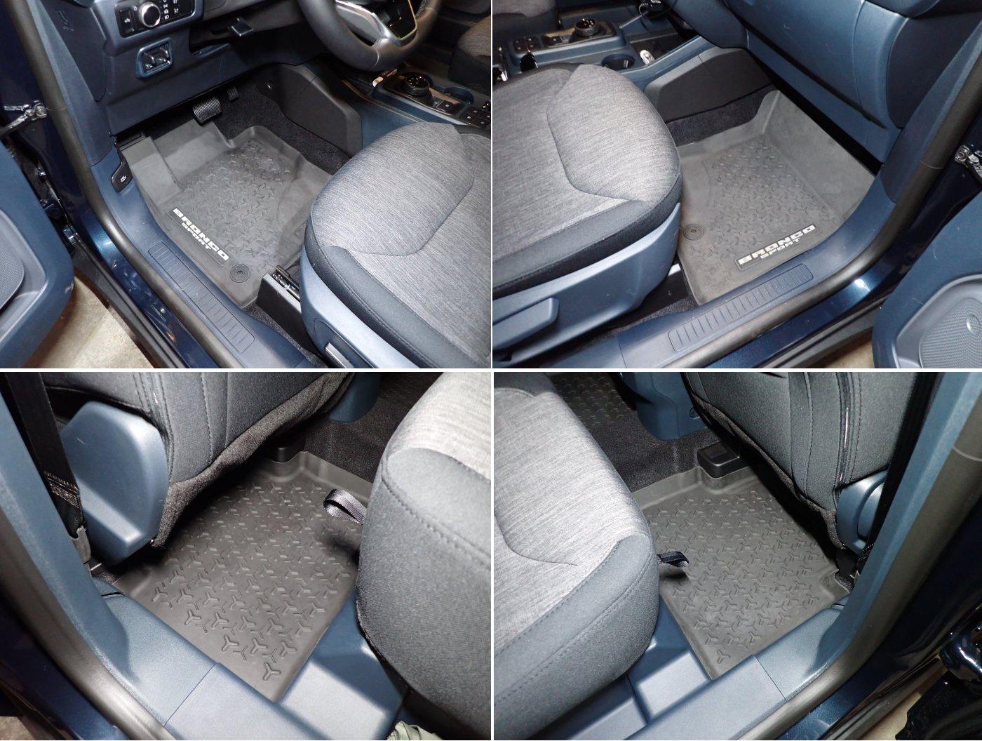

Just an FYI: My Bronco Sport all weather floor mats in my Mav XLT. Only difference is the rear hump.
