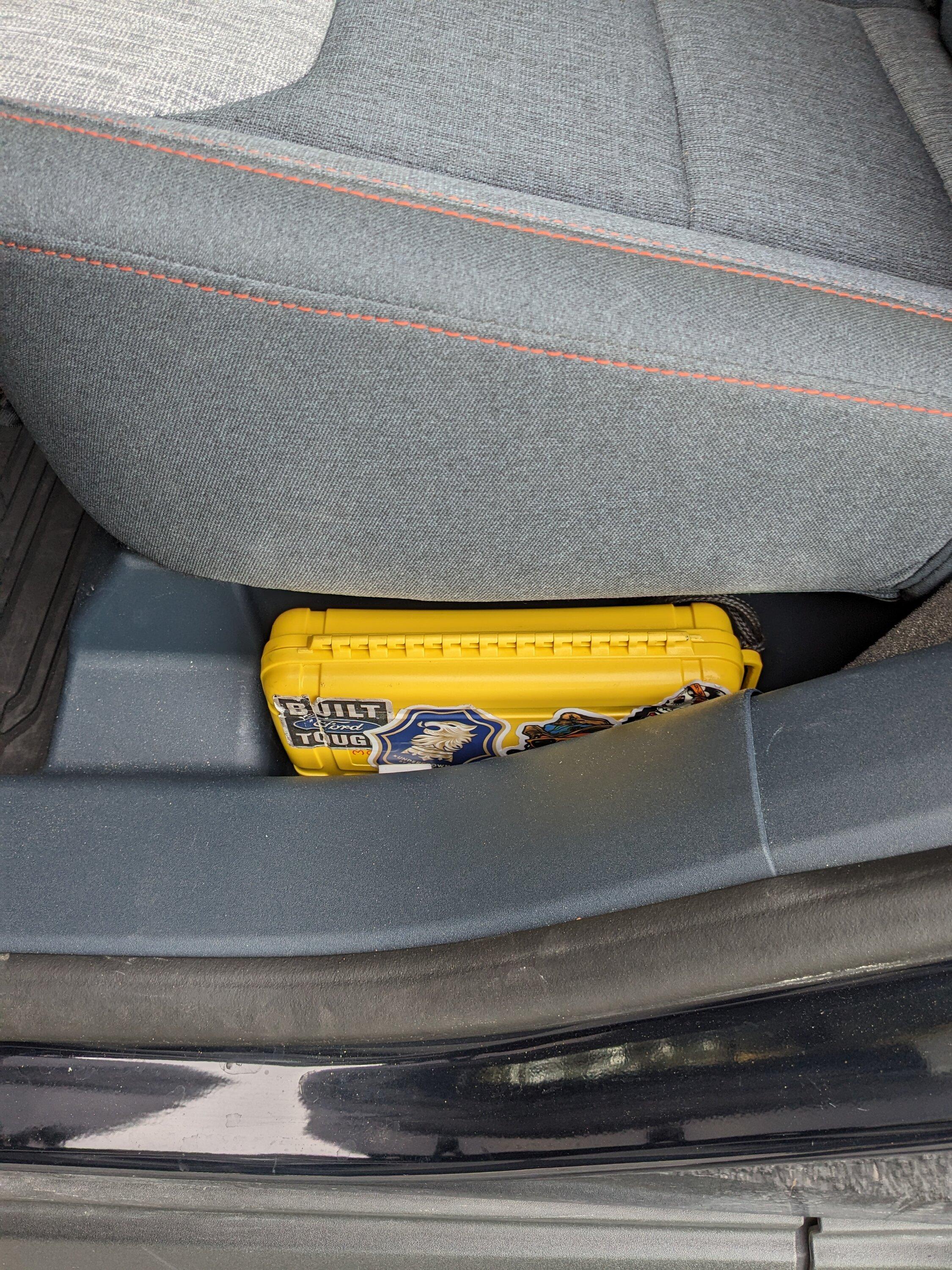

He has the 12V Negative (Black Jumper) connected directly to the Battery Terminal which is the WRONG place to connect it.
The way he has it connected you can expect to get "Deep Sleep" problems.
The proper place to connect the 12V Negative (Black Jumper) is on the Bus Bar near the Battery Negative Terminal. That way the Hybrid's BMS system can know and measure the drain when in use and properly charge the 12 Volt Battery when necessary.

Nothing fancy but it fits really well and it is a low cost solution if you need need some power outlets.
Pretty slick. I use the same little cubby on the driver's side for my travel cigar humidor. I did put a couple of stick on Pads to keep it from rattling around but a great use of space.

It fits my turtle wax ceramic spray bottle and a couple rags.
