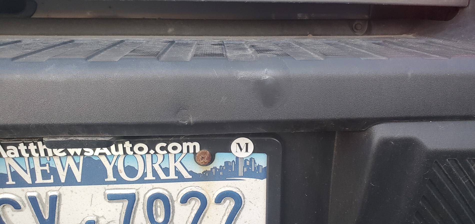

So we got rear-ended tonight. Just enough impact to make an imprint in the bumper plastic of the vehicles license plate screw head. No other damage. Bumper is straight, no scratches, ect...
So...
Has anyone tried to use heat to restore the plastic? I do know some plastics have a memory of sorts that can return the surface to original if the right temperature is reached.

Can’t speak for your bumper without a picture but my BMW 235 front right fender got a fairly bad 6” indention from me hitting the lawn mower pulling in the garage. I used a heat gun but you have to have an object to push it out from the other side. I got it probably 90% better using the gun and a couple rounded long poker object (not sharp) that could slowly push it back into original shape. Plenty of YouTube videos on it but again mine was a plastic fender not the bumper.

I don't see anyway to be able to push it out once heated. As said before you'll need to get behind it and push. If it bothers you and you don't want to file a claim against the other guy, find a bumper cover from a salvage and swap them out. Or take the cover off, heat it up and push it.

I think the screw indent is less noticeable than the outward dent directly to the right of it. It looks like your bumper skin was pushed into the impact absorber. Now you have a stretched part on your bumper skin and a questionable impact absorber as well.
