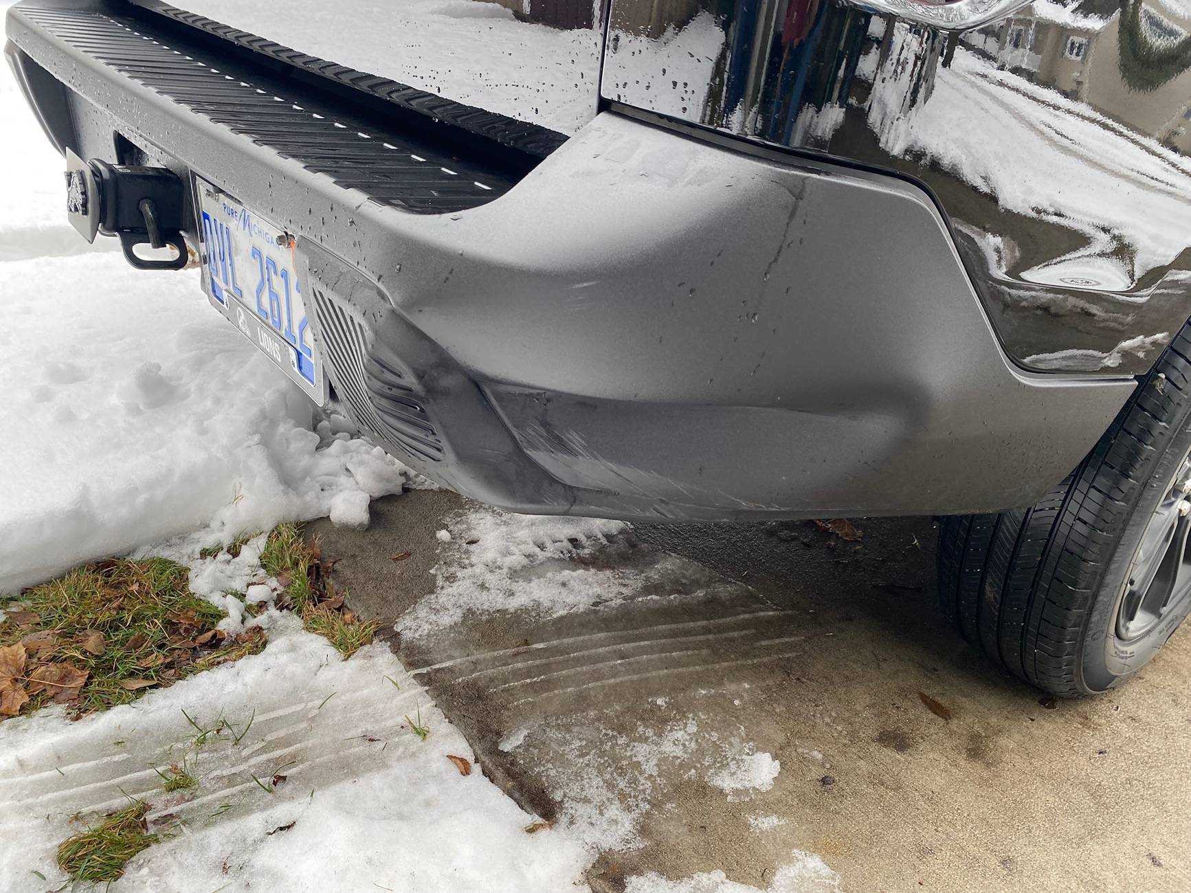

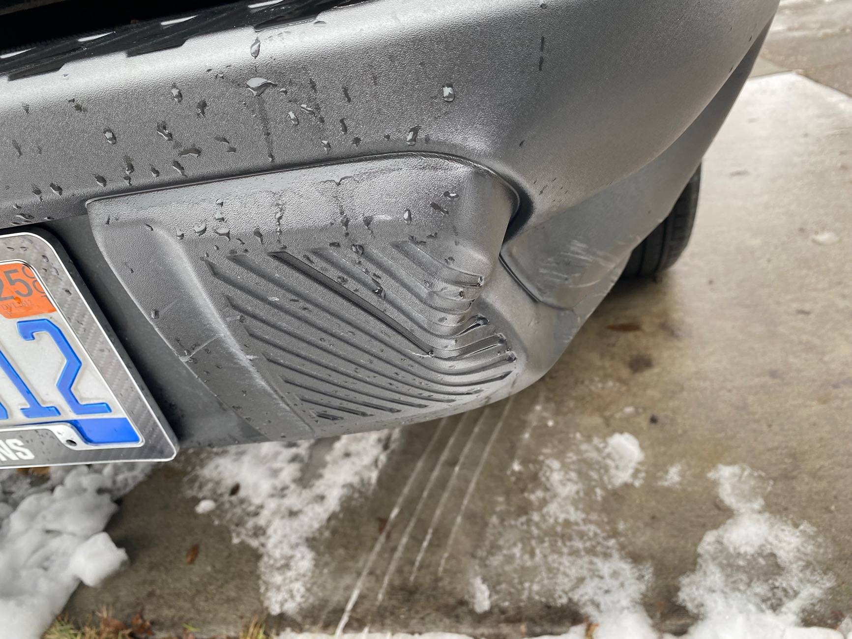

Some jerk hit & run the rear corner bumper of my 2024 Maverick XLT in a store parking lot. Any thoughts if it will be difficult to repair? Can it be pulled out?

Bumper medic would be able to take care of that if you've got one in your area.

Heat it slowly. A 1500w hairdryer or a heat gun on low.

I think that will come out just fine, my gf' worked at costco, and someone hit her car with one of those lowbed carts, and her whole corner was popped in, I just heated it up and pushed outwards, came out, did have a scuff but no more caved in. then she worked at amazon, and an amazon van in their parking lot back into her side of her vehicle and drove off/parked elsewhere. lol. theres a thousand of them vans, cant prove which one did it really after the fact.
