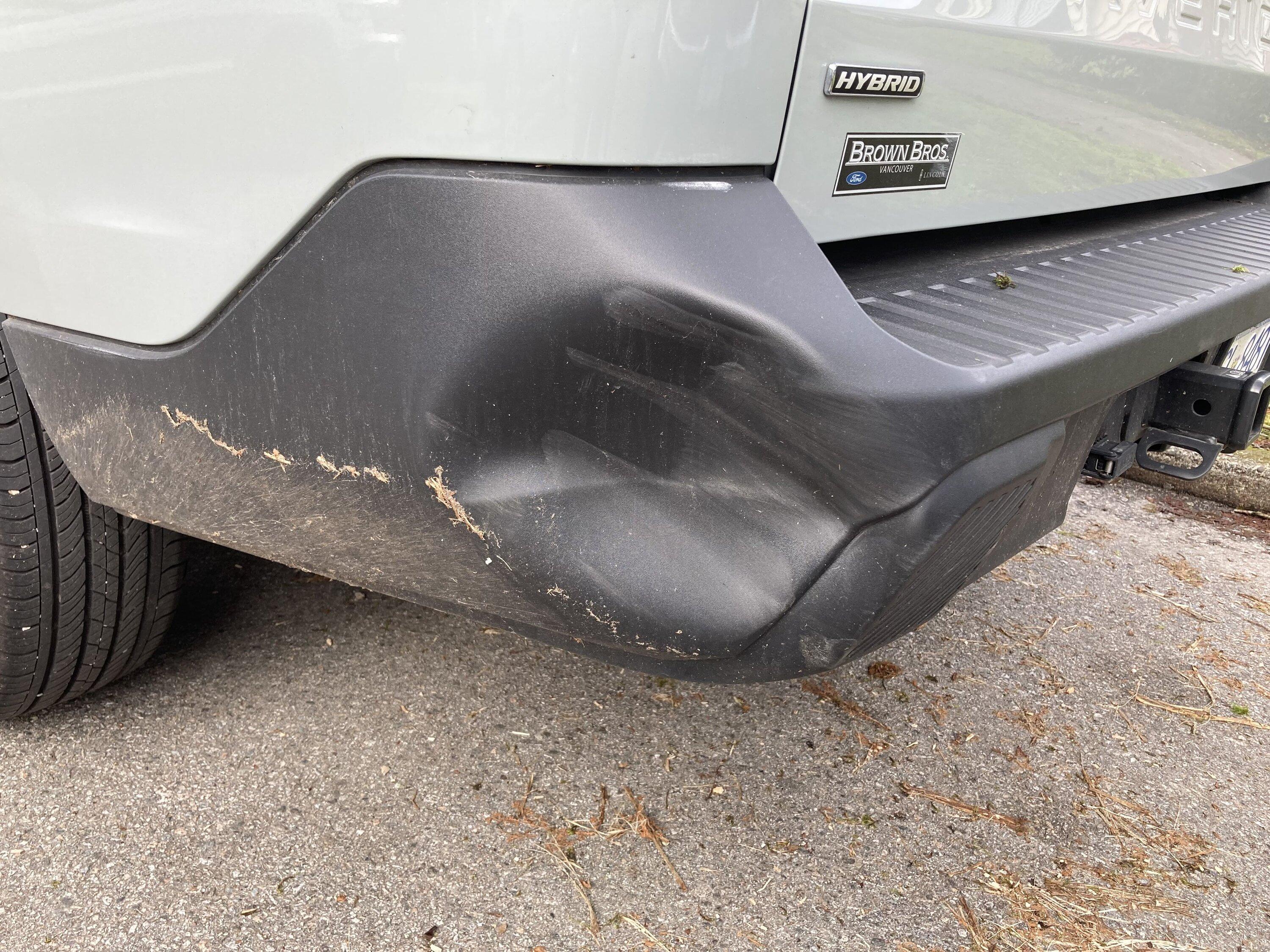

Hi, all. Anyone experienced this kind of damage? (in my case, from a parking lot hit-and-run). The bodyshop says I need a whole new bumper, but I'm thinking it could be punched out from the inside and wind up looking close to new. My 2022 Hybrid otherwise still looks brand new. Happy to receive any suggestions/feedback!
Ignorant here,are the maverick bumpers just molded plastic? (Hope not! ) Or plastic covering a metal bumper underneath...

Use a hair dryer not a heat gun. Much more forgiving. Inside out of wind. Heat slowly and press out with a gloved hand. Slowly work it out from edges to center. The plastic wants to go back to the set of the original shape. Once shape is returned you may be able to buff it with a scotch brite pad to restore the texture. Watch some YouTube videos on this first for starters.

Yep, lots of good info on YT, thanks.
VanMan120
VanMan120
May 4, 2022
Vancouver, BC
I think it's called 'blow-moulded' plastic, maybe pioneered by Jeep. You Tube has some good posts on how to fix as well. Hope I can do it without removing the bumper, but may have to.

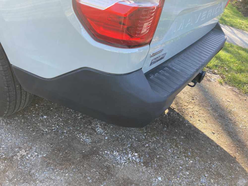

My reply:
Unfortunately the hair dryer wasn't hot enough in a Vancouver winter. Used a heat gun to (mostly) pop out the dent, then filled remaining irregularities with Bondo, sanded and painted with black automotive texture paint from a spray can. Result is pretty close to like new (see pic). Spent about $100 on tools and materials, but saved $500 on insurance deductible, so overall it was worth it. Thanks to all for the feedback. Hope this might help some of you if you get a similar dent.
