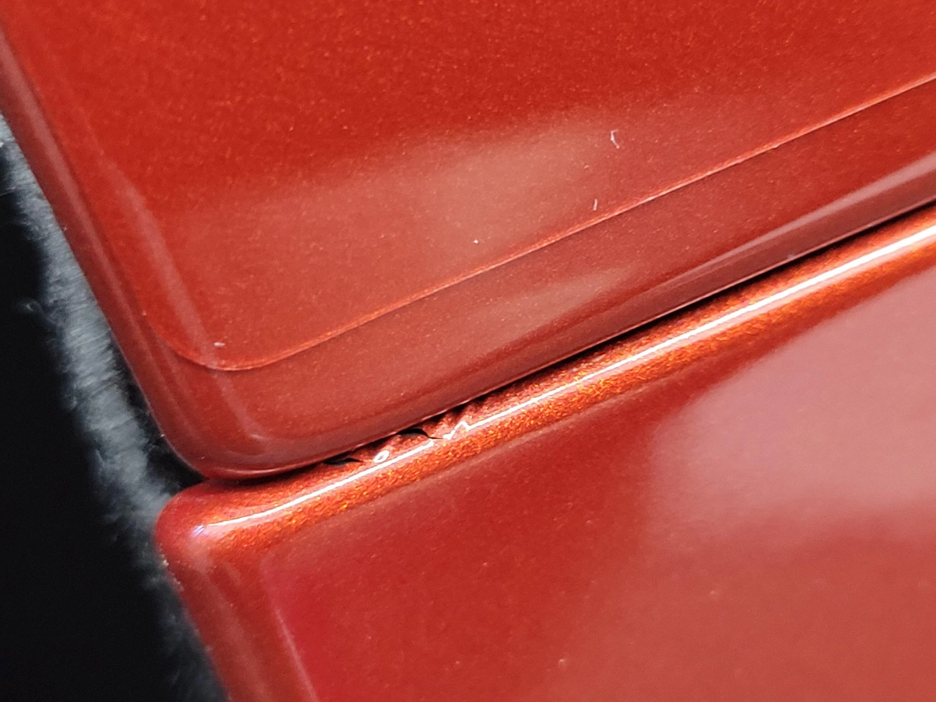

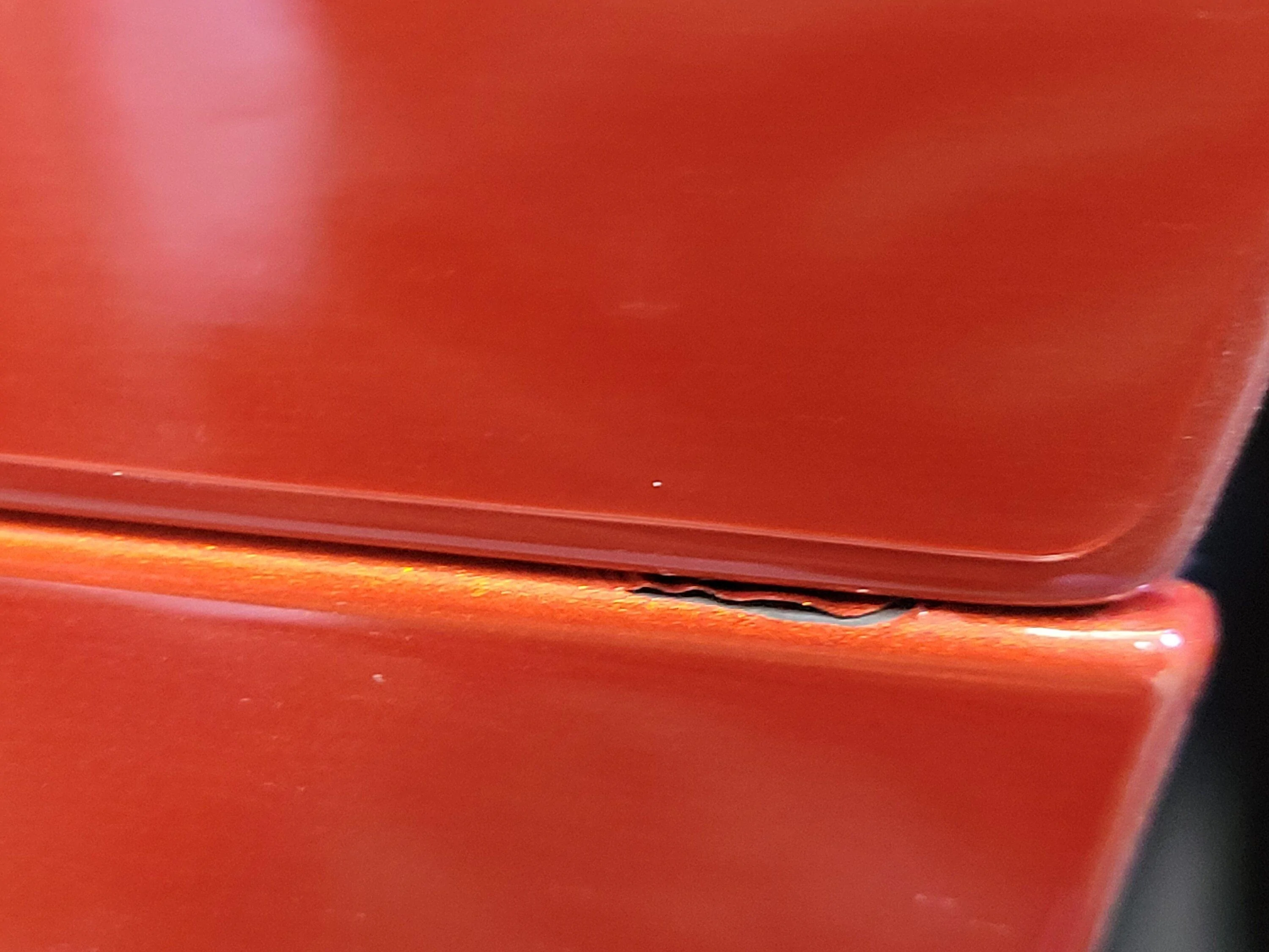

Got this lariat hybrid with lariat luxury package 2 weeks ago. Drove only 250 miles in the town only and just noticed that the paint is already coming off from rear door on driver side.
See picture.
I do not know what to do.
I have contacted the dealer but did not get any response.

No claim to paint expert here but that almost looks like damage due to movement of some kind. Hard to be sure in the pics but I would have guessed there should be a consistent yet small gap between parts to avoid vibration induced friction wear. Would be interesting to see if the gaps on your truck are the same as other folks and if any other folks see this..
Alternatively it might have been there since new with the bumper installed such that it hit and caused damage at that time.

OP, looks like one of 3 issues... First it is an adhesion failure. That much is pretty evident.
If the substrate is TPO, Thermal plastic olefin, then there is an adhesion promoter, not primer used on the plastic @ .1 mils. The paint could have lost adhesion at the adpro basecoat interface. Adpro to the plastic or in a few cases I've been involved in adpro to plastic interface. The plastic actually delaminates. If you can pull a small chip off and look on the back of it you can eliminate at least one of these. If there's black or gray on the back of the paint you can eliminate paint to adpro.
You are futunate that Ford has taken an interest. Probably because this is an actually paint failure as opposed to soft thin paint complaints.

Got this hybrid lariat model with lariat luxury package just 2weeks ago. Drove only 250 miles in the town only and just noticed that the paint is already coming off from rear door on driver side.
See picture.
I have contacted the dealer but did not get any response. I did not haul anything.
It is frustrating.
Take it to a dealership w/ a body shop and let them take a look at it and determine whether or not it is warrantable. They will take pictures and contact Ford if necessary.
