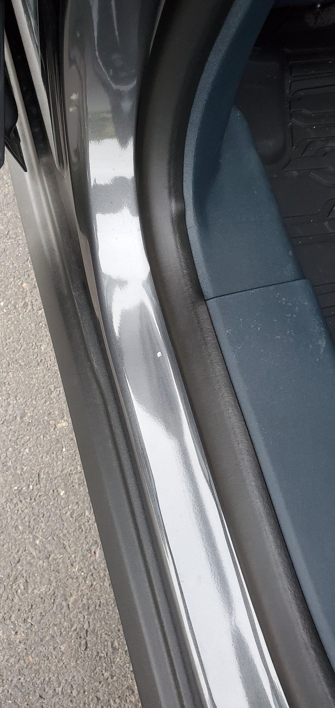

Got this lariat hybrid with lariat luxury package 2 weeks ago. Drove only 250 miles in the town only and just noticed that the paint is already coming off from rear door on driver side.
See picture.
I do not know what to do.
I have contacted the dealer but did not get any response.

Got this hybrid lariat model with lariat luxury package just 2weeks ago. Drove only 250 miles in the town only and just noticed that the paint is already coming off from rear door on driver side.
See picture.
I have contacted the dealer but did not get any response. I did not haul anything.
It is frustrating.
