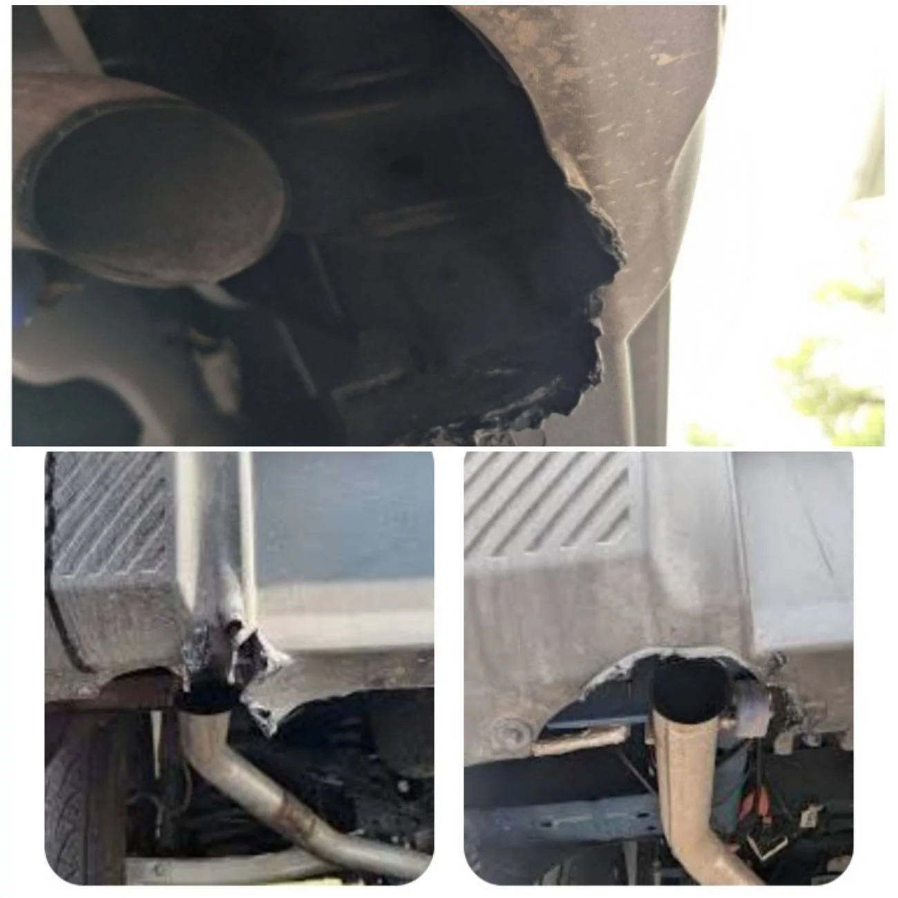

Given that we've recently seen a bunch of people with melted bumpers from the exhaust on EB Mavs, I'd be very hesitant to do this...
Glad I’m not the only one. Couldn’t figure out if I pushed the exhaust into it while off roading or if I got some low octane fuel and it ran hot. Was in the middle lane f a trip form Texas to Michigan with the enclosed trailer and noticed my bumper was melted
Sadly you are not alone.

I think these exhausts were all bent, or had a hanger failure (which also was caused by bumping into something).
and because it's concealed from the factory, a person would not have visual cues there was an issue unless they happened to look underneath *and* knew what it looked like originally.
and because it's concealed from the factory, a person would have visual cues there was an issue unless they happened to look underneath *and* knew what it looked like originally.
The Common Thread that I found when researching on other platforms, was that the owners were towing trailers and they had EcoBoost Mavericks.
I'm 99% certain none of them are bent or otherwise pushed up.
and their exhaust is pushed up, I'm 95% certain.

Makes sense I towed at least 20k miles of some very heavy loads and this never happened until I was pushing hard with less than 93 Oct fuel.
I must say mine is not nearly as bad as a few others. Mine is barely noticeable. But looking at a brand new 24 on the lot it’s not surprising. They are not bent or pushed up. The exit is blowing hot gas on the plastic. Bound to melt at some point when really pushing the engine.
