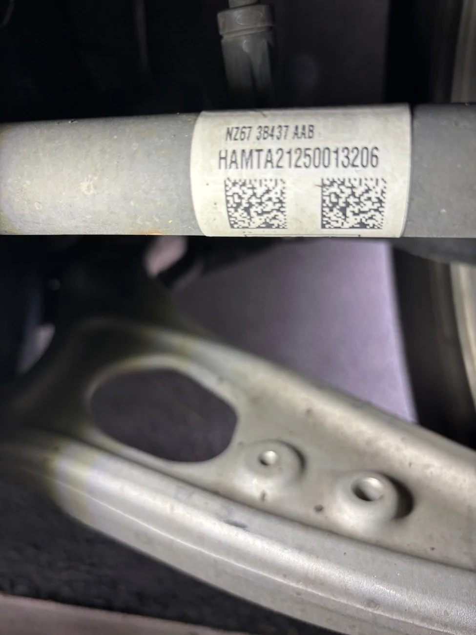

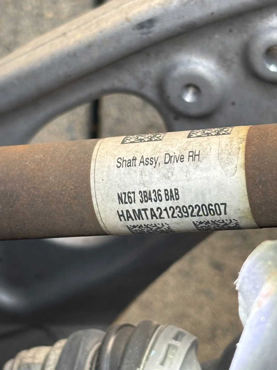

Finally got to this… I have early 22 build (Oct. 2021) which pre-dates the Dec.2021 cutoff of the recall. Here are the parts I have installed:
LH - Driver: NZ67 3B437 AAB ( HAMTA21250013206 )
RH - Pass: NZ67 3B436 BAB ( HAMTA21239220607 )
Hoping MTC sleuths can verify if these are somehow different that would validate exclusion from the recall.
Well, would need to find some original 22's in the recall range as to what they had and picture.
My searching not going so good for that. One thread.
https://www.mavericktruckclub.com/f...dard-cv-vs-tremor-cv-comparison-photos.55795/
Front axles for AWD and FX4 as of 2024 posts.
NZ6Z-3B436-B
NZ6Z-3B437-A
https://www.mavericktruckclub.com/f...ey-used-the-nz-or-sz-parts.76825/post-1265659
So even newer was same major part #. Yours made 2021 week 23 & 25 it appears.
But even a compare to a 22 in the recall range part number - may not be useful.
Ford has been known to slap the exact same part number label on a clearly different part when that part is total replacement.
Happened to the hybrid 12V battery - the early BXT-99RT4-A made in Spain or Mexico with 390 CCA was replaced with a clearly better one with 470 CCA with the same label part number on it.
The factory line box shipment of your CV axles could have been replaced with the next load - and slapped with the same labels for builds continuing until 2024 when they came back out.
Or you got even more special ones deemed too overbuilt and expensive at the time!
Perhaps someone else will find the old threads giving those part numbers/pics for them.
