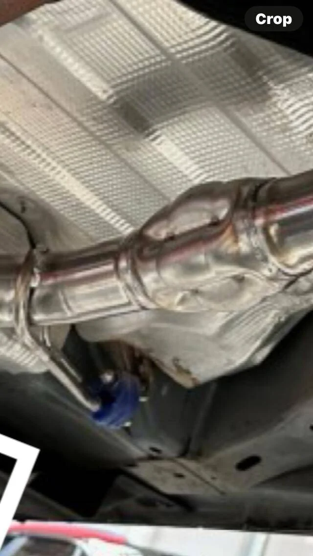

I removed about a 10.5 inch section of the Borla to fit the resonator in fyi, leaving the slotted Borla tip and Borla clamp to connect to OEM pipe…
Ford Maverick Borla S-Type Catback - Lobo/Tremor IMG_0001
Ford Maverick Borla S-Type Catback - Lobo/Tremor IMG_0002

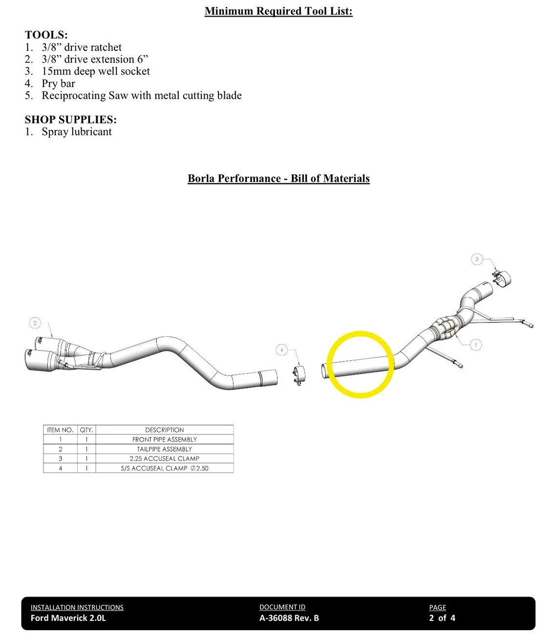

Looking at your photos, it appears you put it here, yeah? Seems a bit obvious but I only get one cut 😆

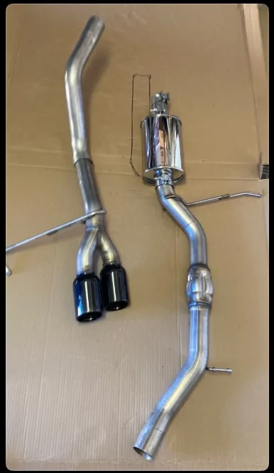

My Borla is different from the diagram you pictured. I placed the resonator at the front (see pic). Ignore the clamps (replaced - were not tight enough) and the markings on the cardboard (not lined up in pic).
Ford Maverick Borla S-Type Catback - Lobo/Tremor IMG_0005
Ford Maverick Borla S-Type Catback - Lobo/Tremor IMG_0006
My first thought was to place a magnaflow muffler in place of the Borla “muffler”…definitely the quietest route. But instead I added the “resonator” & kept the “Borla” sound - just quieter & less droney
