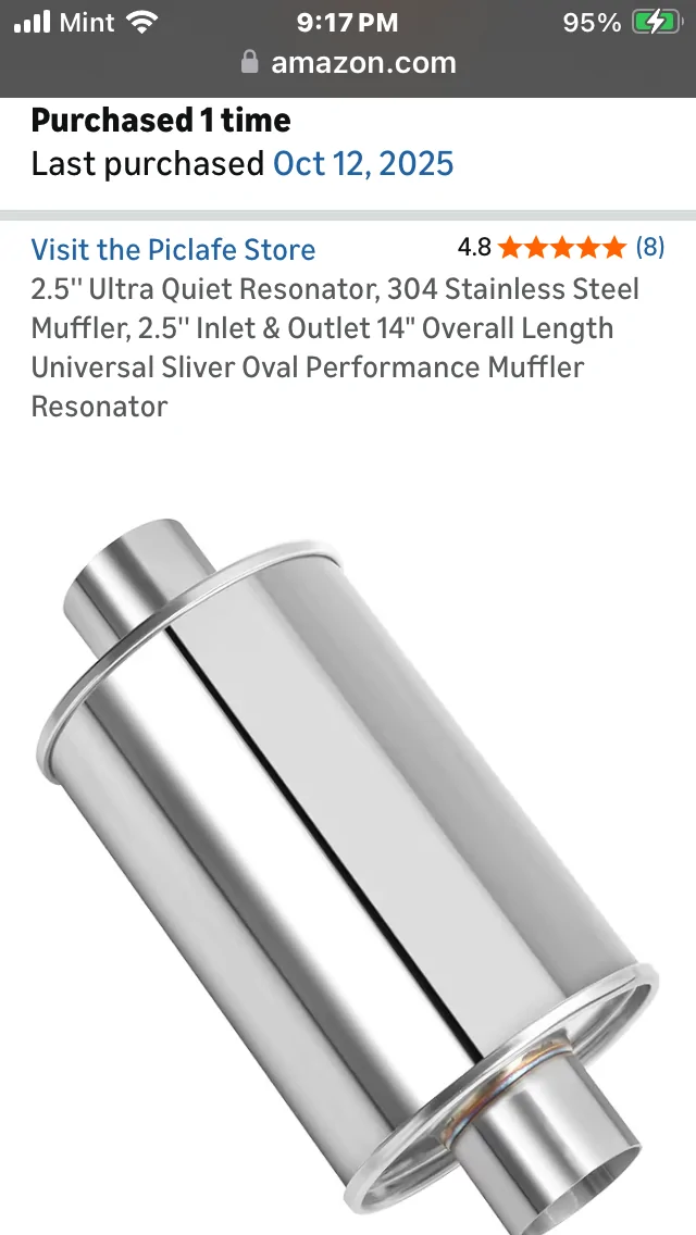

A magnaflow catback was my first choice - but were not available for my 2025.
The Ford Performance Catback was my 2nd choice. But at $1200 it was too expensive.
Ford Parts Dept recommended the $799 Borla and they ordered it for me with $15 shipping to dealer.
When it arrived I installed myself. Way to LOUD & DRONY.
I bought the magnaflow muffler you picture to add to my system - but it was a bit too long to fit in the Borla piping. Still have it, would recommend it - and you can have it for free if you meet me in Nogales:)
I'm so far away from Nogales! Haha I can always pick you up at the Cancun airport and give you a free ride to your hotel! Hahaha
I just went to FL, planning to fly to TX for spring break
So the Magnaflow 10416 suits better, it's smaller
