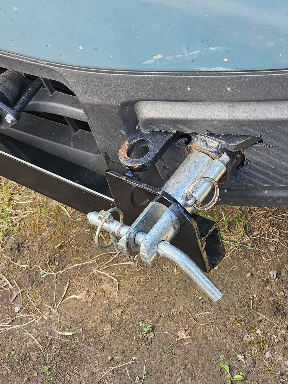

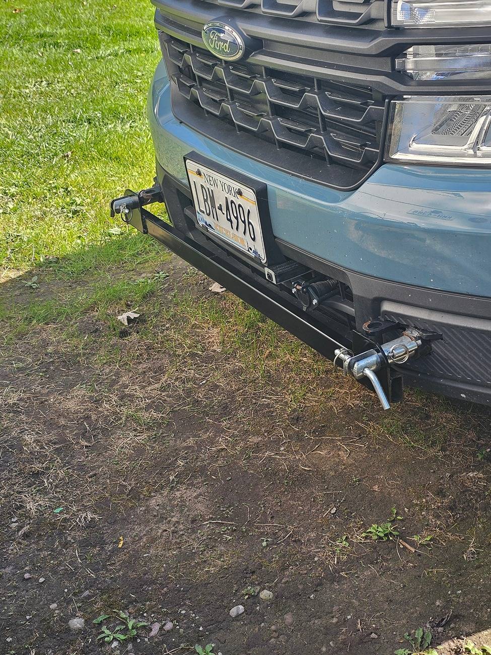

Came up with a idea, and implemented it, to brace my BluOx baseplate. Although I have a longer arm towbar, and not had an issues with it, I figured it's cheap insurance.
I ordered a 1" X 2" X 4 ft, 1/8 thick box beam and 2 - 4" X 4" X 1/4 " thick steel plates. Drilled 1-1/2" holes in the plates, rounded the corners and welded them to the box beam at the proper spacing.
I slip it over the adaptors pins and hitch up the tow bar to keep it in place.
Well done! HRG
