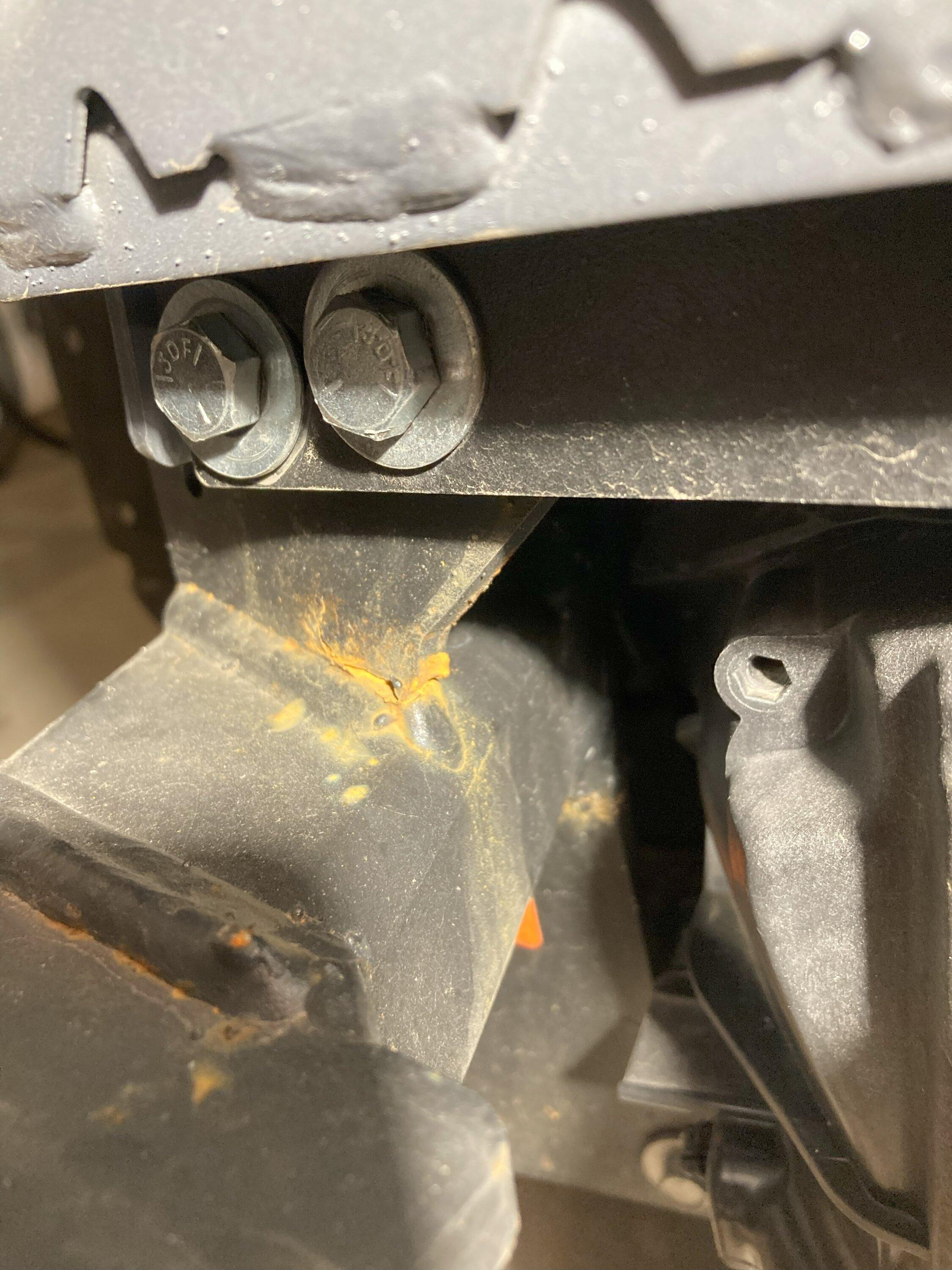

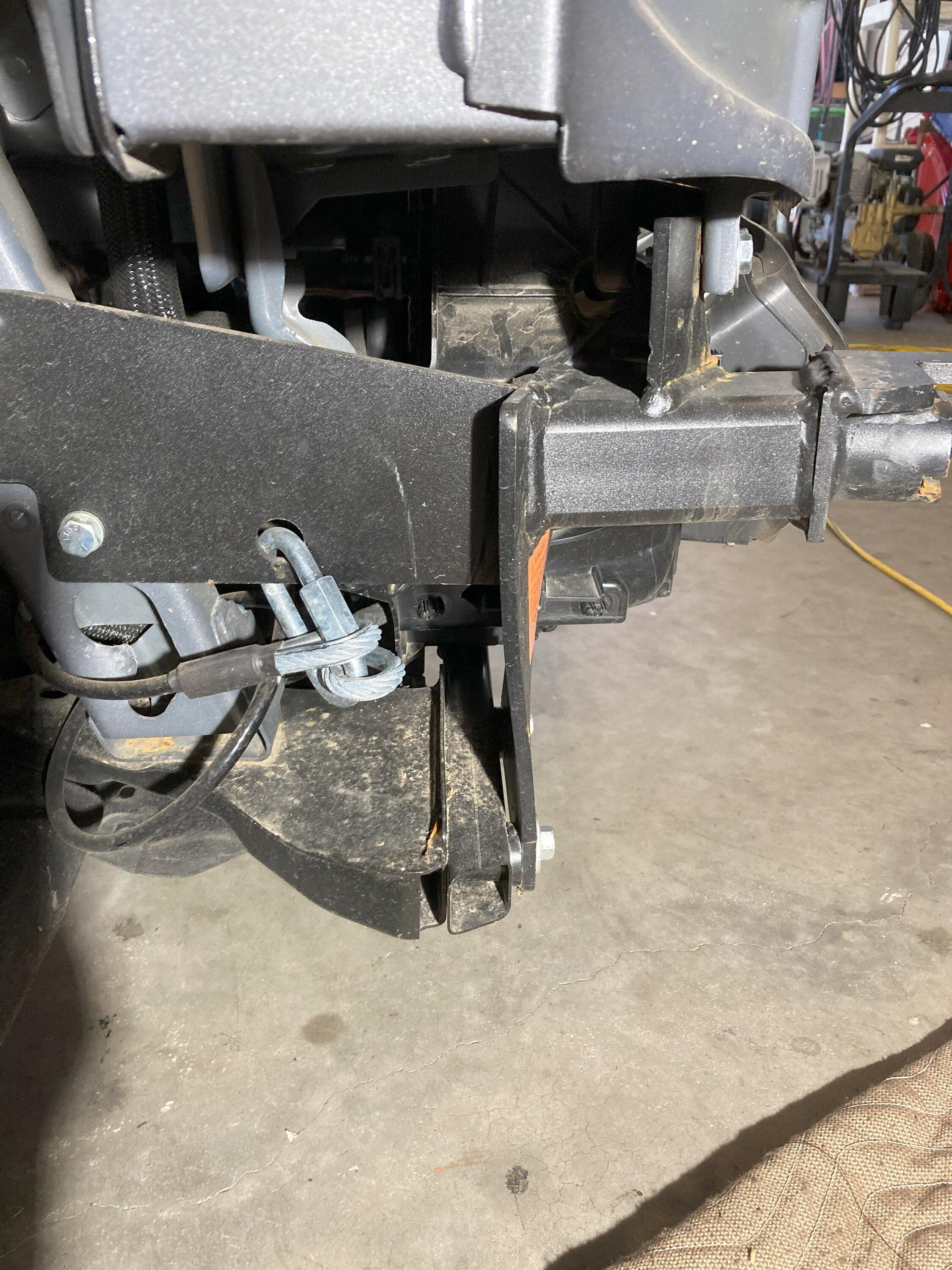

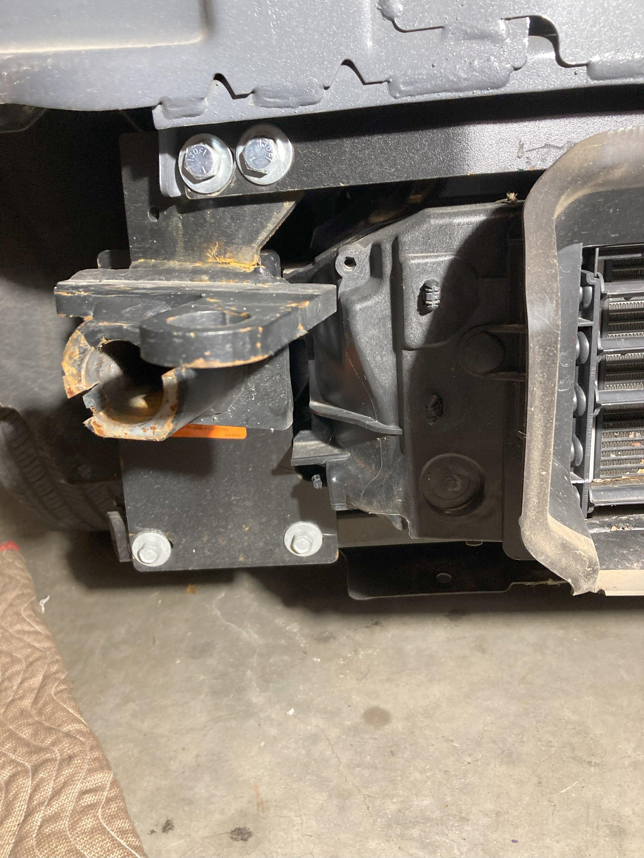

I have a similar situation with the Blue Ox Base Plates (BX2690) on my Maverick. I have towed with the Blue OX Base Plates for approximately 3000 miles. On our last trip, I had to aggressively brake the motorhome for a car entering an onramp. After stopping for lunch, I noticed the passenger side base plate attachment point had been pushed roughly 1.5 inches to the outside. We stopped towing at that point. We are now home and I have removed the fascia to observe what damage has been done.
My tow bar is also a NSA Ready Brute Elite 2. I have removed the surge brake and installed the NSA solid bar where the surge brake mechanism was located. I use an RVI Brake 3 in the Maverick.

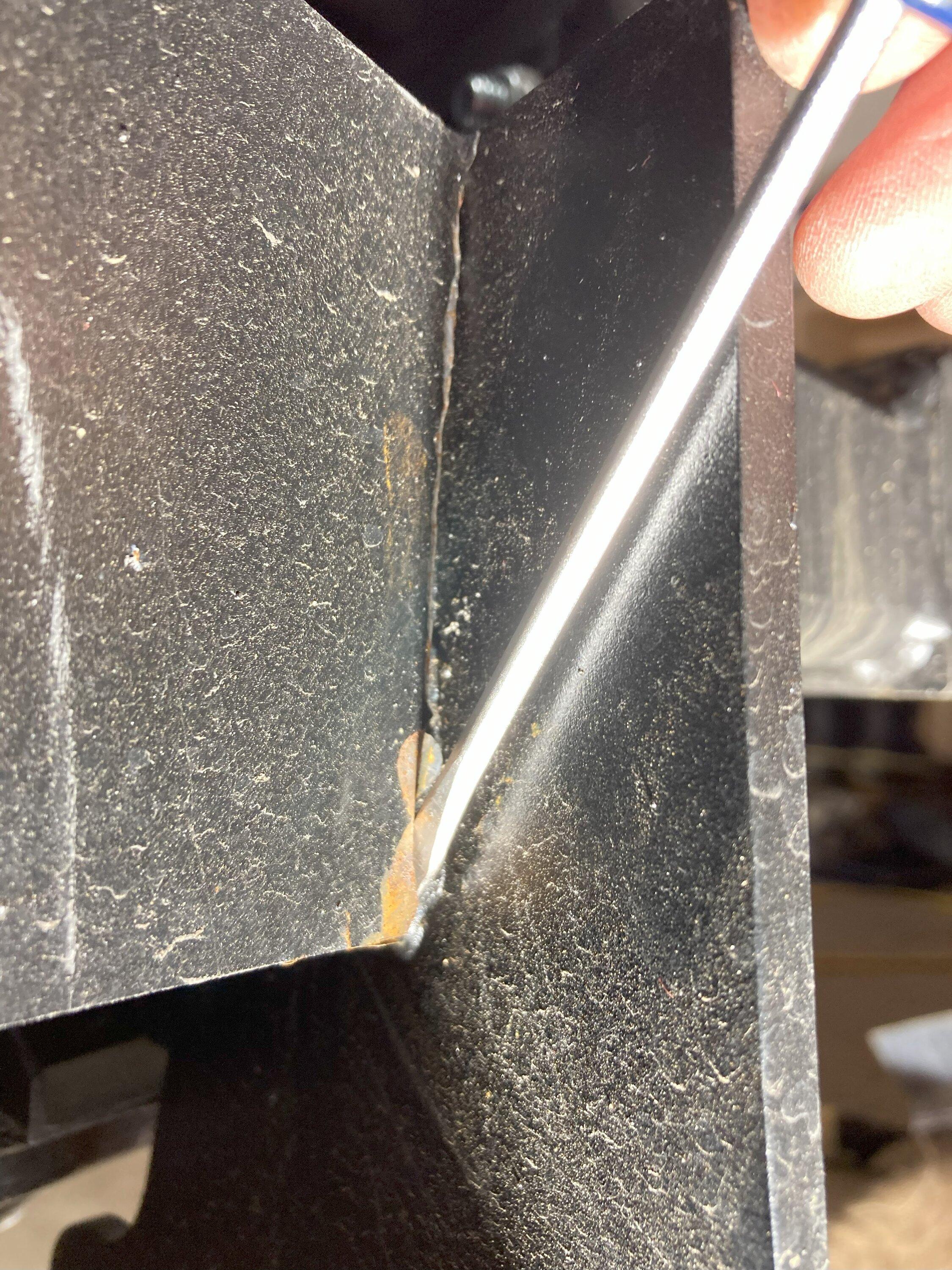

After removing the Maverick Fascia, I was relieved to find that the damage was limited to the base plate and not the Maverick. The base plate is still attached securely but has twisted, bent, cracked and has failed weld joints.
I agree with realshelby in that the Blue Ox attachment points are to far apart and when a force is applied, the force is directed laterally instead of straight back as would be the case with closer attachment points.
I will be contacting Blue Ox tomorrow to inform them of my situation. I will update this post with their response.
UPDATE: After contacting Blue Ox, they requested that I send the broken base plate back to them for inspection. After they received the baseplate, I was informed that my warranty claim was denied. The reason given was that I used the incorrect towbar. I explained to them that nowhere on the Blue Ox website, the website of the retailer I bought the baseplate from or in the BX2690 installation manual was ever any mention of any towbars that could not be used or an specific towbars that was required to be used. If they had, I wouldn't have bought the Blue Ox baseplate.
After 2 known baseplate failures, Blue Ox has updated the BX2690 instruction manual (405-0775 REV C) with a note stating "Please insure tow bar being used is compatible with the baseplate tab width".

Well, now I know for sure this is going to be a problem for Blue Ox base plate owners. Not an isolated incident! This is EXACTLY how my parts looked after the failure. There was no frame/Maverick damage that I could be certain of, but I had "pulled" the parts back into alignment before I took the fascia off.
Did you install this yourself, or was it Dealer installed?
I ask because once again this is going to come down Blue Ox claiming the towbar is too short.
We may need to band together on this......
