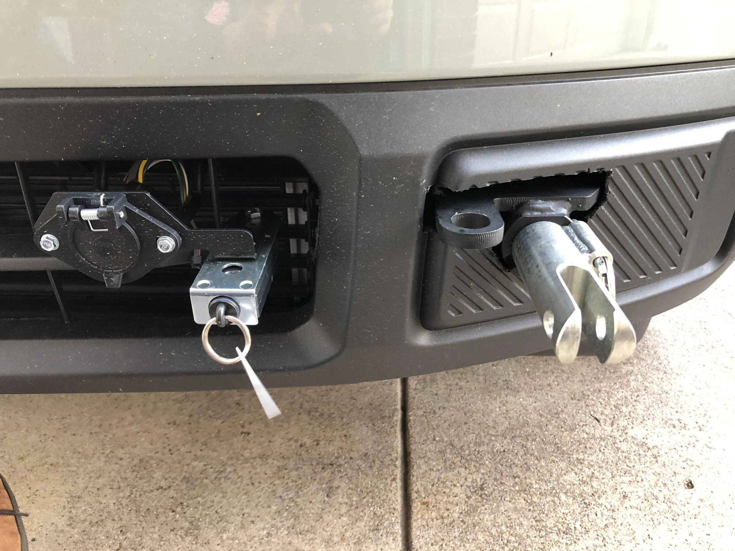

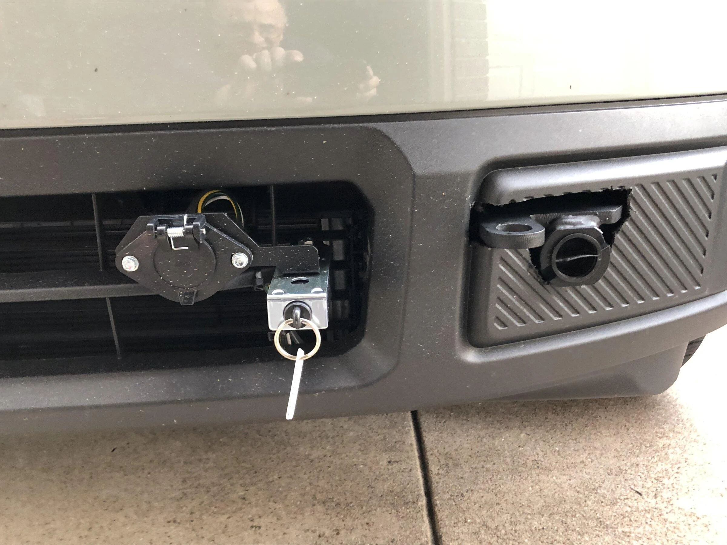

Pictures please- does it look like the Roadmaster base plate.

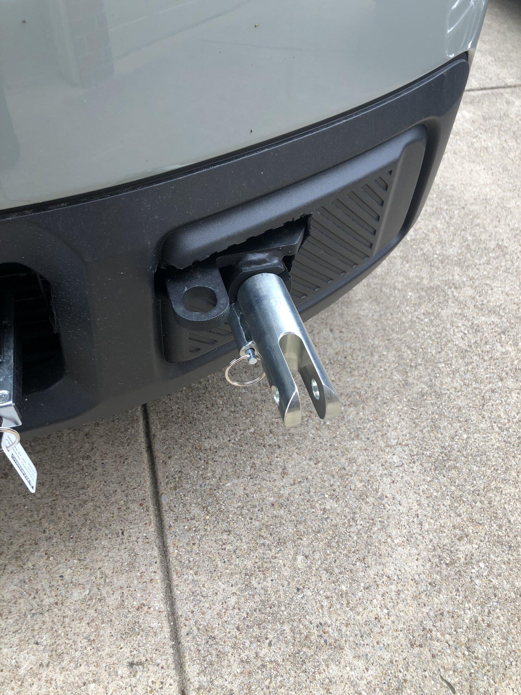

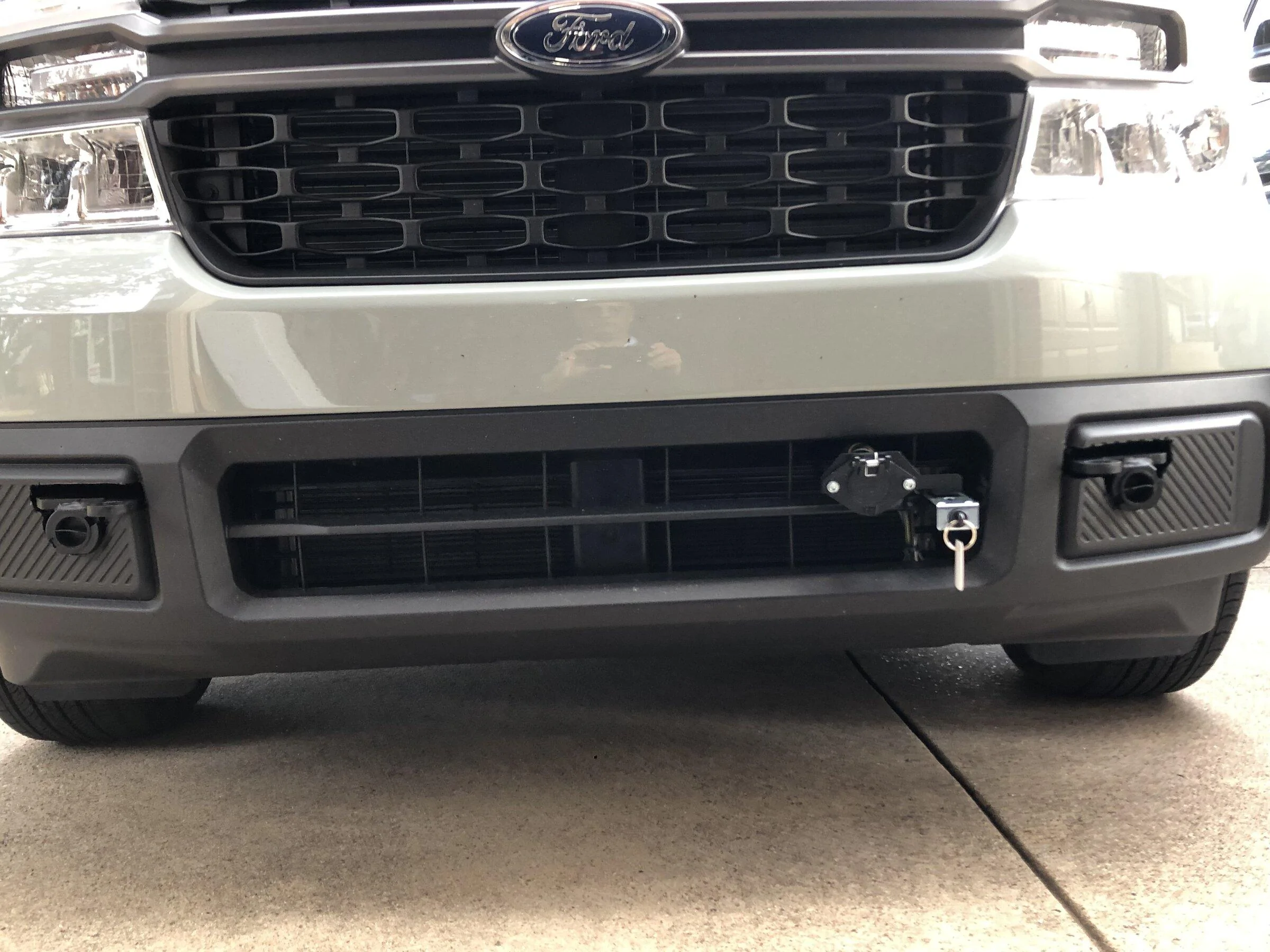

Here are the pictures. Let me know if another angle is needed. I have an XLT. It also works with XL and Lariat but the Ford tow kit may have to be removed.

The biggest difference I see between the Roadmaster and Blue Ox baseplates besides the Blue Ox cuts out the tow hook covers. The Roadmaster removes the shutter system and the Blue Ox does not. That is what I can tell from the pictures and instructions I could be in error on that. I feel the Roadmaster is a less invasive install and easier to put back to OEM.

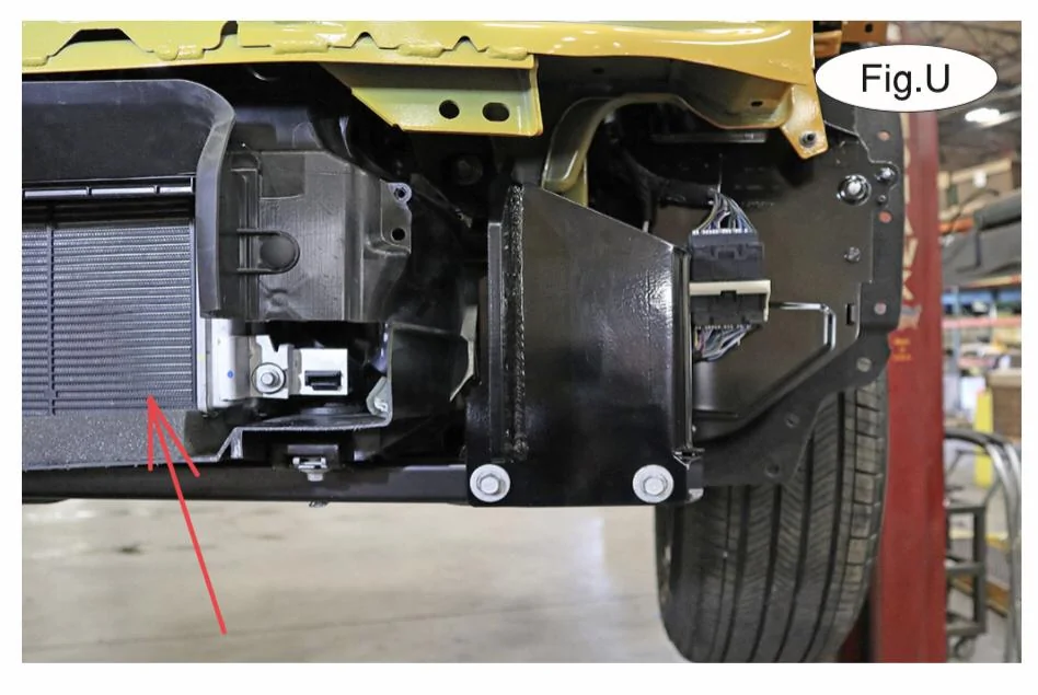

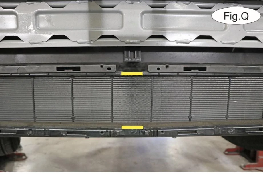

The Roadmaster instructions show a trimming of the active shutters (just the area in yellow), not a full delete.

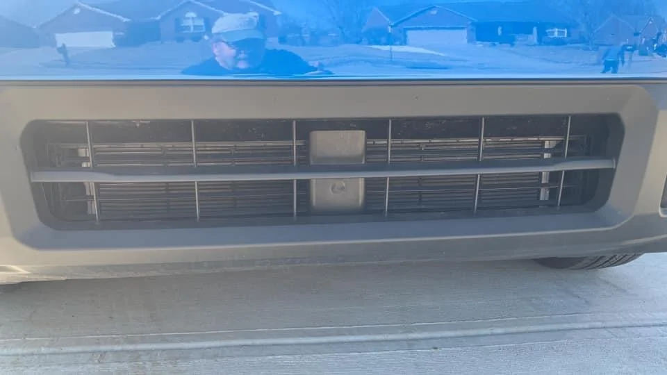

I could be wrong but it looks as if your shutters are gone on your truck. I never saw in the instructions where the shutters are replaced after the removal.

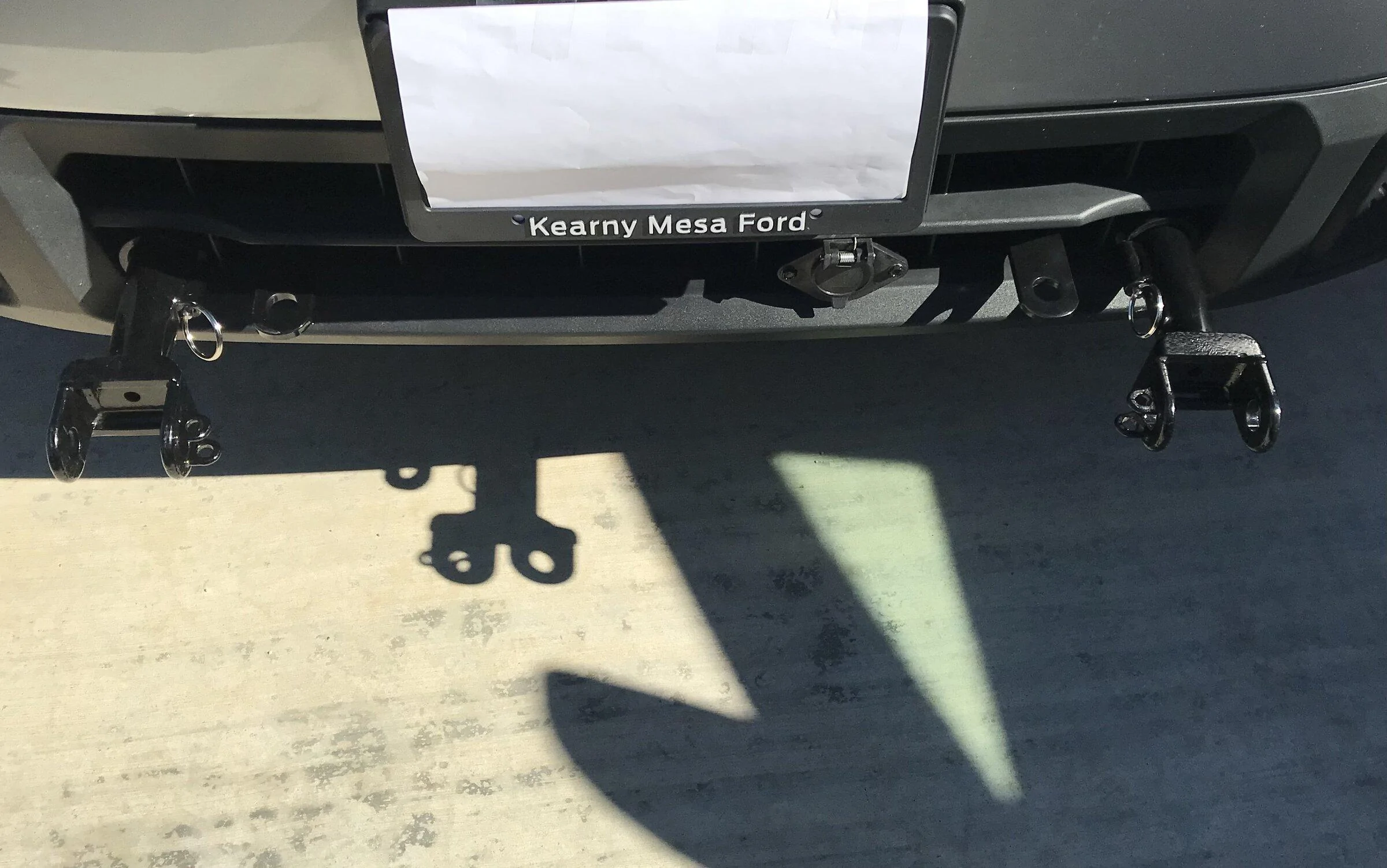

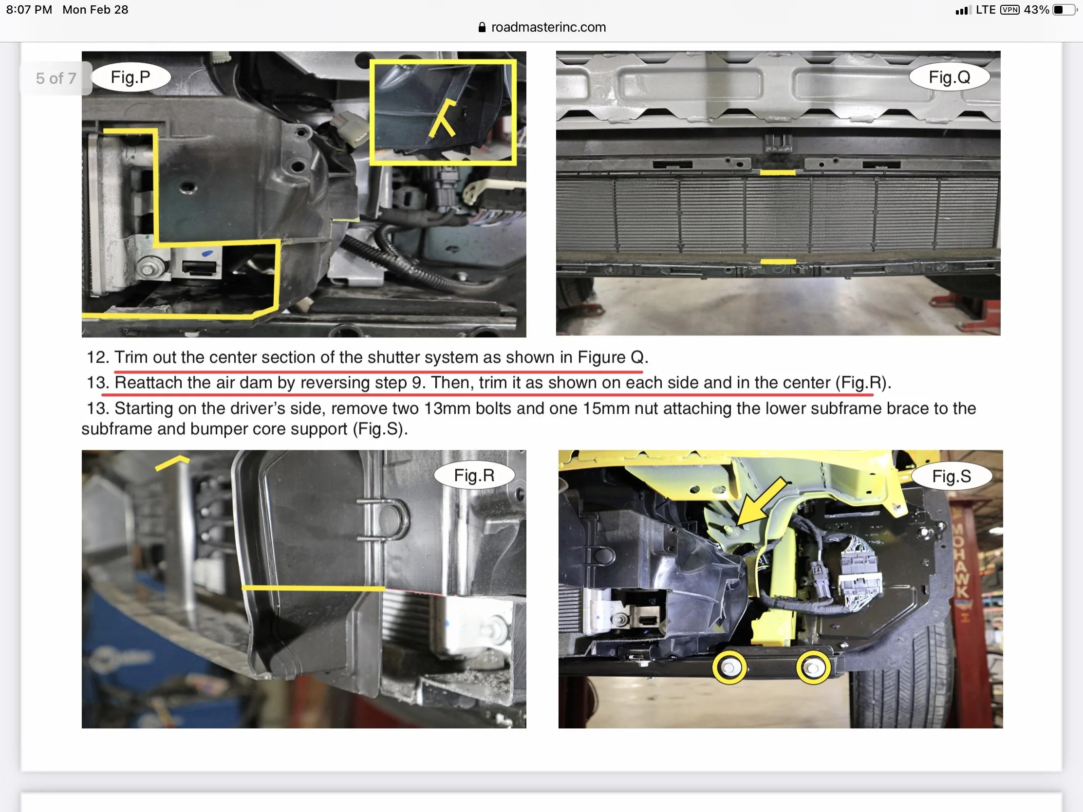

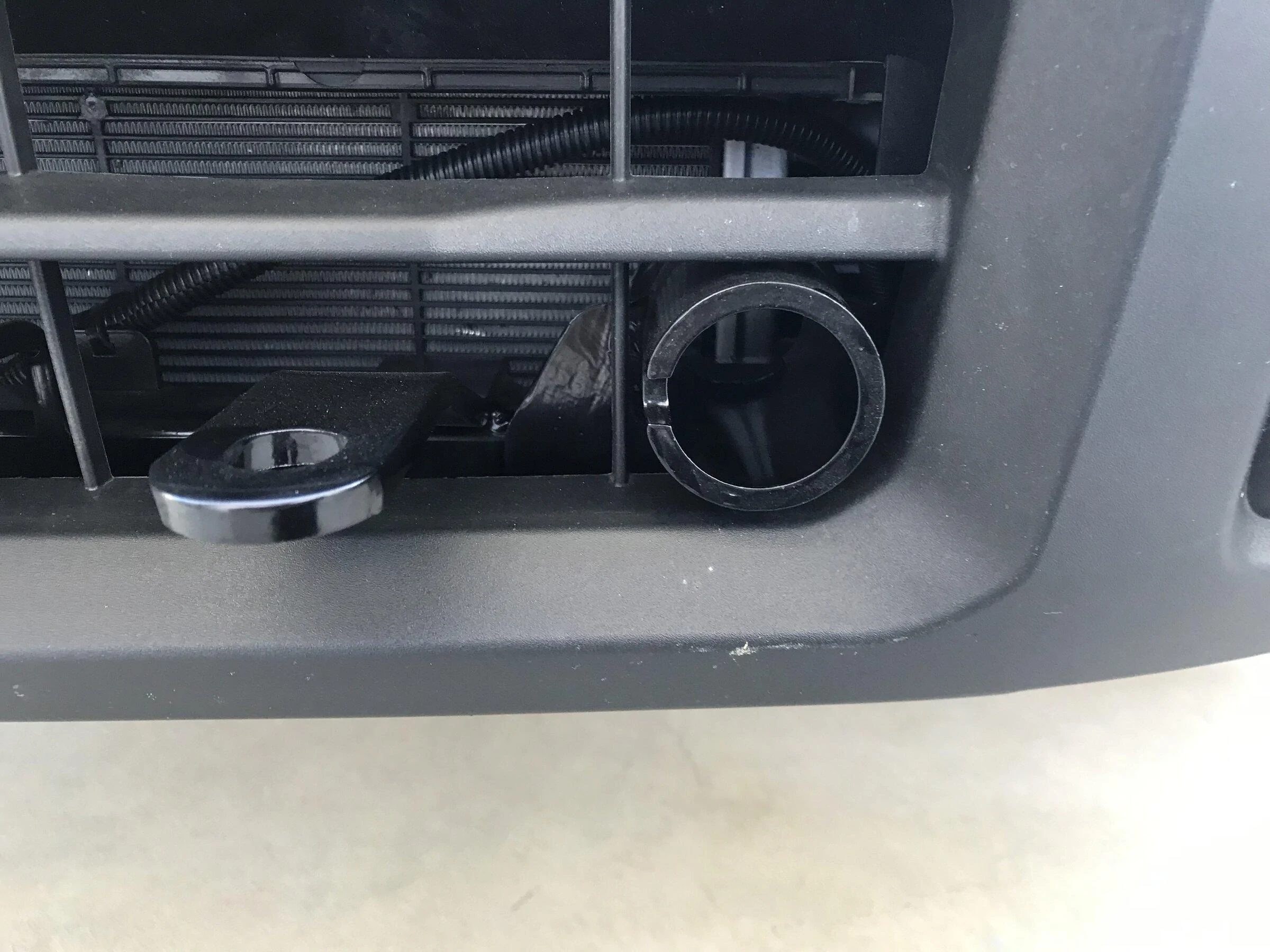

Specific about trimmiming the reinstalling the auto dam. You can see in Fig. U the active shutters are reinstalled. Honestly as crude as the Blue Ox install looks, I would never do that to my truck. Interesting to see both released so close together that one didn’t have time to view the other,

Agreed the air dam is cut and replaced. I honestly don’t see the shutters. I really really hope I am wrong. But I’m not.

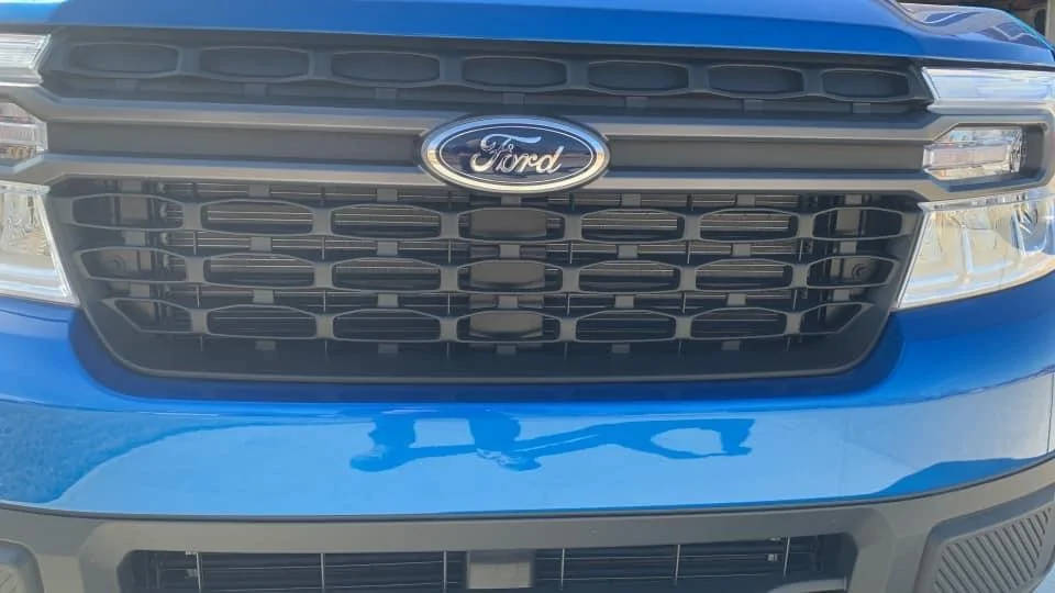

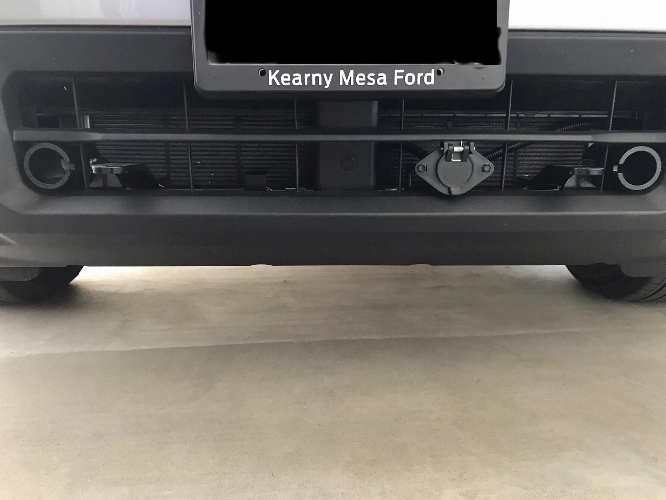

Mine is an XLT unlike your Lariat Lux so I had a friend without a tow bar installation or any other mods send me a pic of their XLT. It looks just mine after installation. Honestly, it made me feel better.
