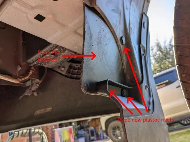

I liked your idea and since I finally get a set of Mabetts, I followed your example. I'm can be a bit of a packrat, so I didn't throw away the rectangles I had to cut out of the bedliner when I added the side cubbies a few months ago. I remember setting the cutout piece aside thinking I might find a use for it someday. :) I also had a box of the plastic rivets that I had purchased after a new teenage driver in our house checked a curb and removed some of the plastic undercarriage on another car (nice to have by the way - https://www.amazon.com/gp/product/B07L6FJGR4/)
I like the Mabetts, especially at their price. I know they are trying to stay "no drill", but I felt much better adding some additional plastic rivets toward the inside of the wheel well. Luckily, each area has a nice place to attached it to existing plastic (except for the "Ford hole" on the drivers rear). That one has the additional panel from the bedliner. The others just had one rivet added. Hopefully my picture make sense. In the rear, they sit in the box like recess mud flap. I'm happy with the result.
Nice job 👍

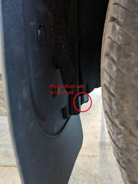

I added a pan head screw on the fronts in the same place you added the plastic rivet.

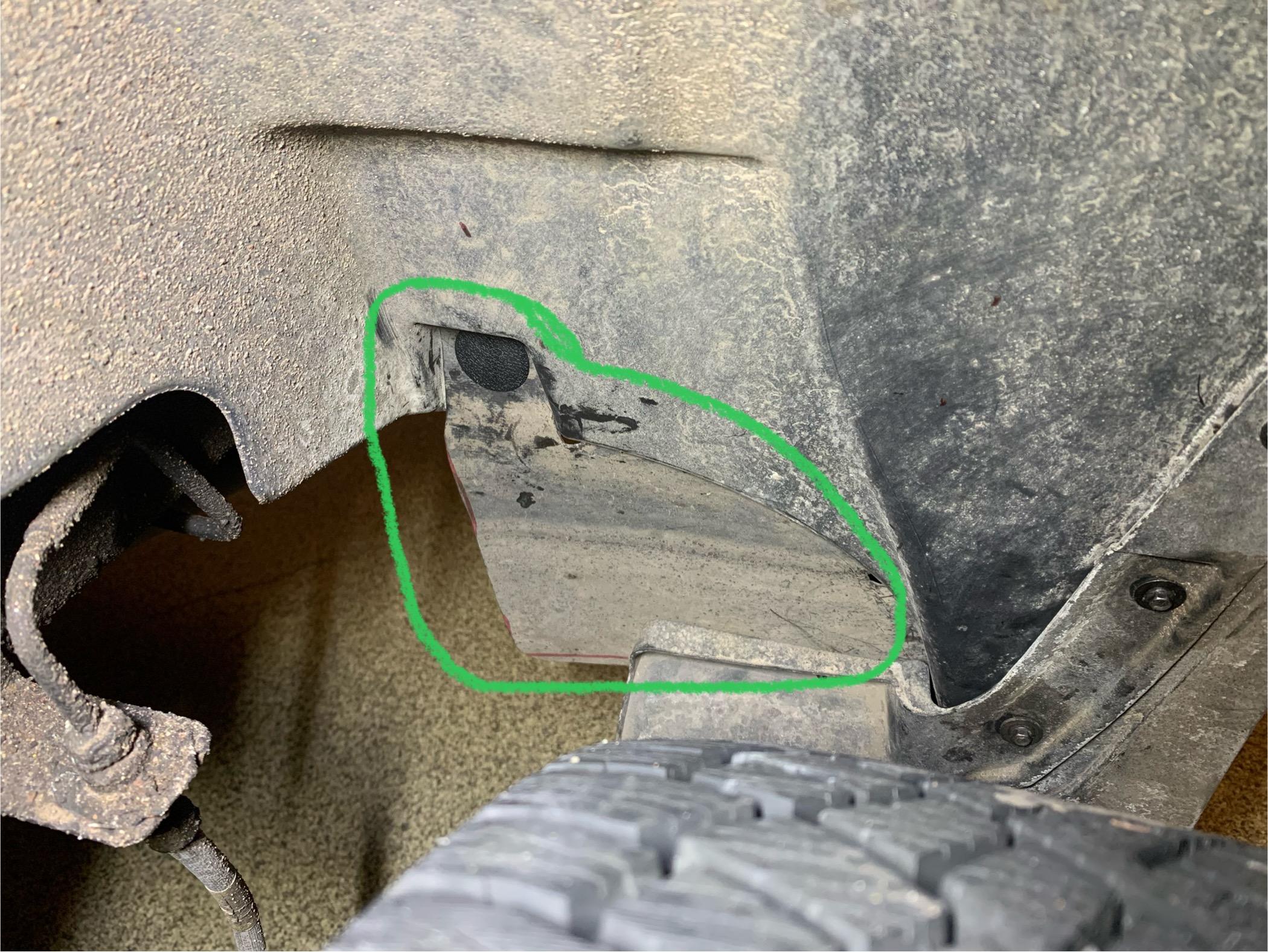

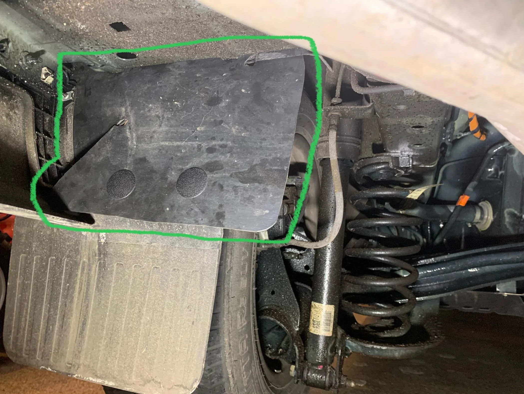

I just made and added a wheel well “extension” that I fashioned from an old wheel well liner from a completely different unrelated vehicle. I cut and attached it to 3 “factory” holes with existing fasteners, plus added two more holes into the top lip of the Mabett to lock the new piece in place. The green lines are around the new piece. It’s already dirty and otherwise hard to tell (Minnesota winters and all). It’s held in place via 2 of the metal 7mm mud flap bolts, and by 3 push-in style plastic fasteners. Two of these push pins are what I added via drilling 2 holes into the top of the Mabett (seen in 1st photo).
And I’ll be the first to admit, it’s a challenging area to take a photo of. In the first photo, the camera is under the exhaust tip looking forward. Second photo, the camera is on top the tire looking backwards and down.

It would have been nice if Ford had just made a matching plastic cover for the driver’s side, as compared to the passenger side cover. You have to lay under the truck to see it, but the hard cover attaches to the rear of the passenger rear wheel well and goes all the way back to the bottom lip of the back bumper. Once you see that, you’ll undoubtably have a WTF moment like me and a lot of others too!

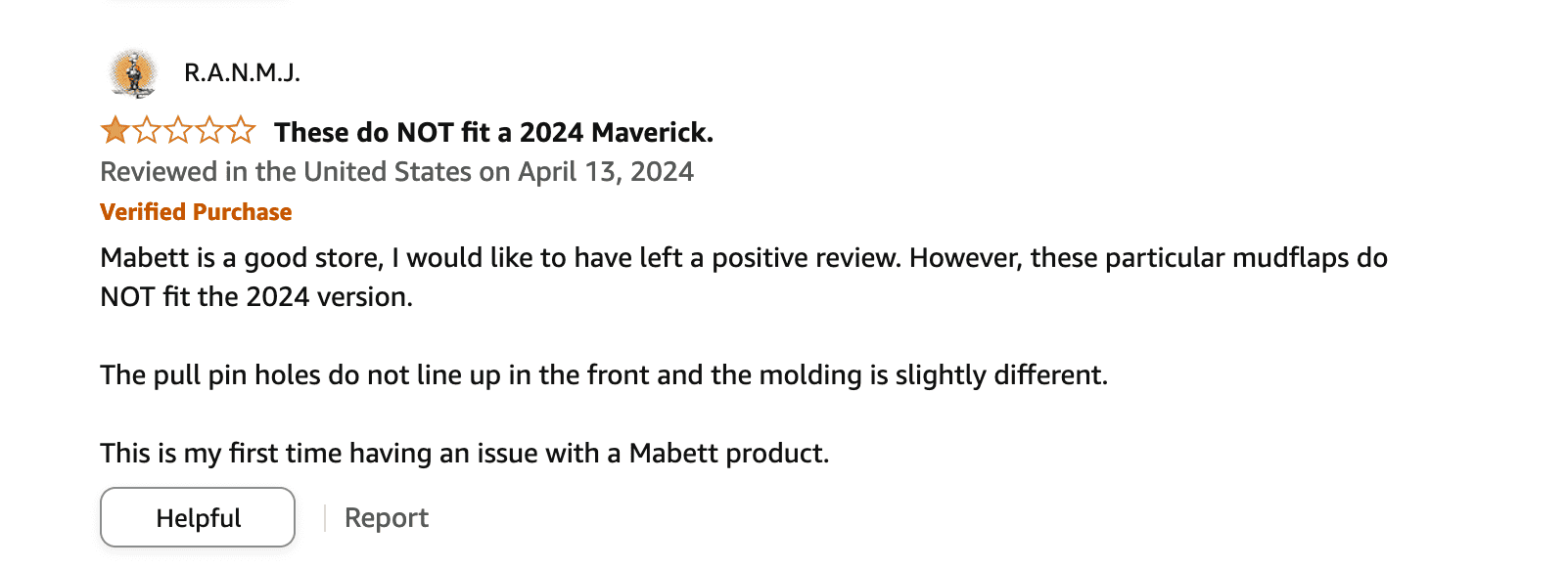

Just tried to install Mabetts on my 2024 XL. The holes in the front flaps did not align with the factory fastener locations. Didn't bother trying the rears. Too late I see that another Amazon reviewer had the same issue with his '24. Given the many recommendations here I assume that this was not a problem for '22 or '23 models.

Sorry, no pictures. The upper two holes matched the factory location - the lower hole was several inches off. Same problem each side so I assume that Ford make a change in the '24.

I also figured it out quickly - they didn't fit. Here's another recent Amazon reviewer (a confessed Mabett fan) saying the same thing. Perhaps your Lariat differs from my XL hybrid and this reviewer's (unspecified) '24 model.
