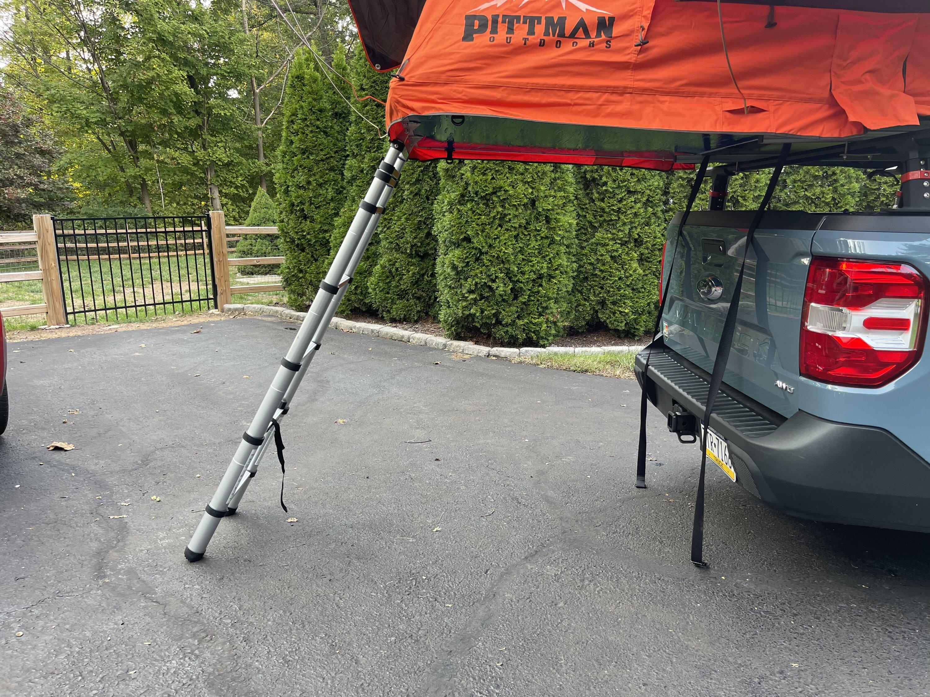

Is it full time living on your truck bed or do you take it down?
How about the weight limit on the cross bars and the rails? How did you install the rails?
Leave the cross bars on but tent is easily removed. The ts rails are installed like a bed cover, clamp method, super easy install.

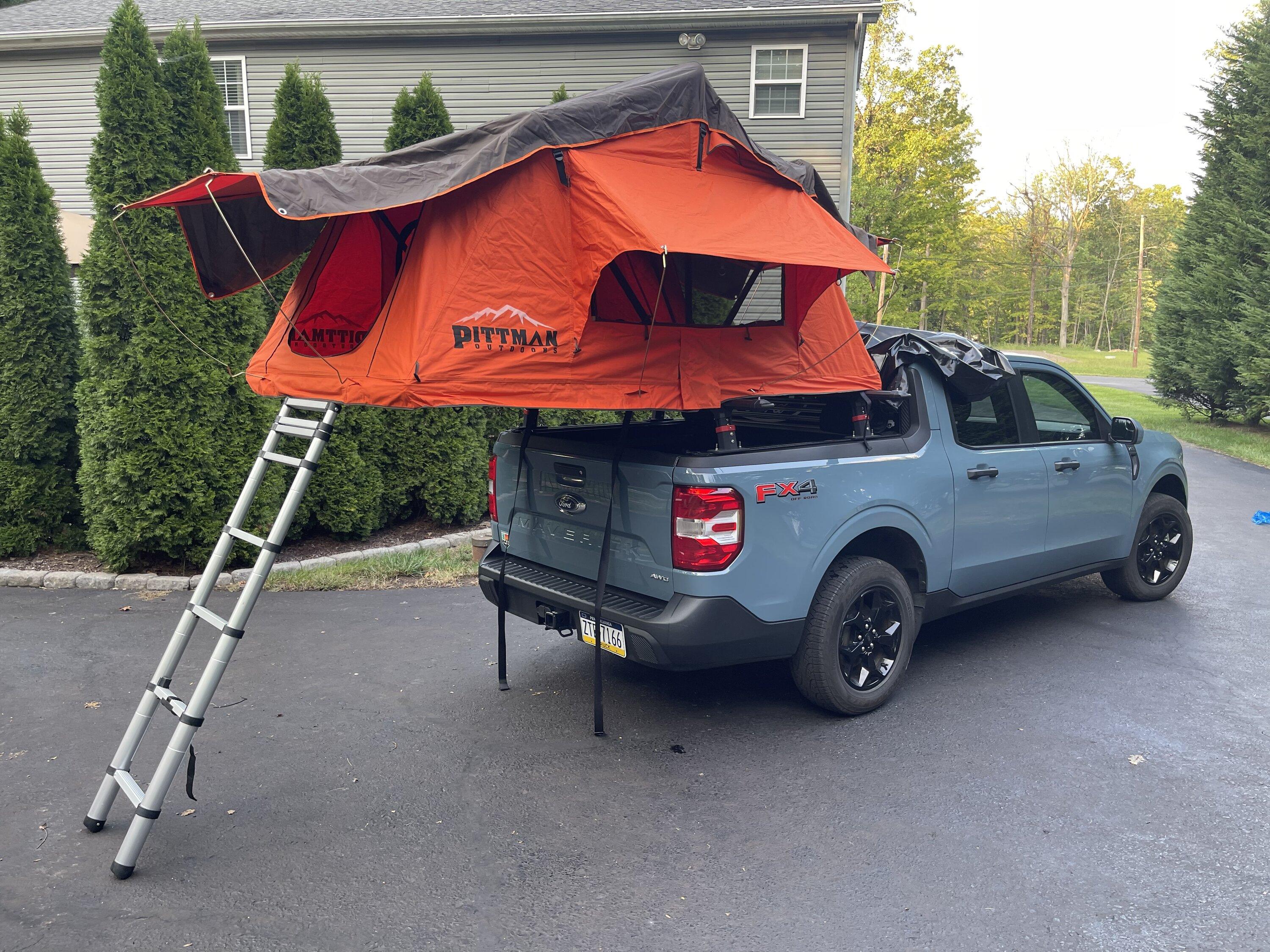

Great Job, would love 2 c more pictures of the rail set up before tent and specifics of make and model of tent. Again Great Job...

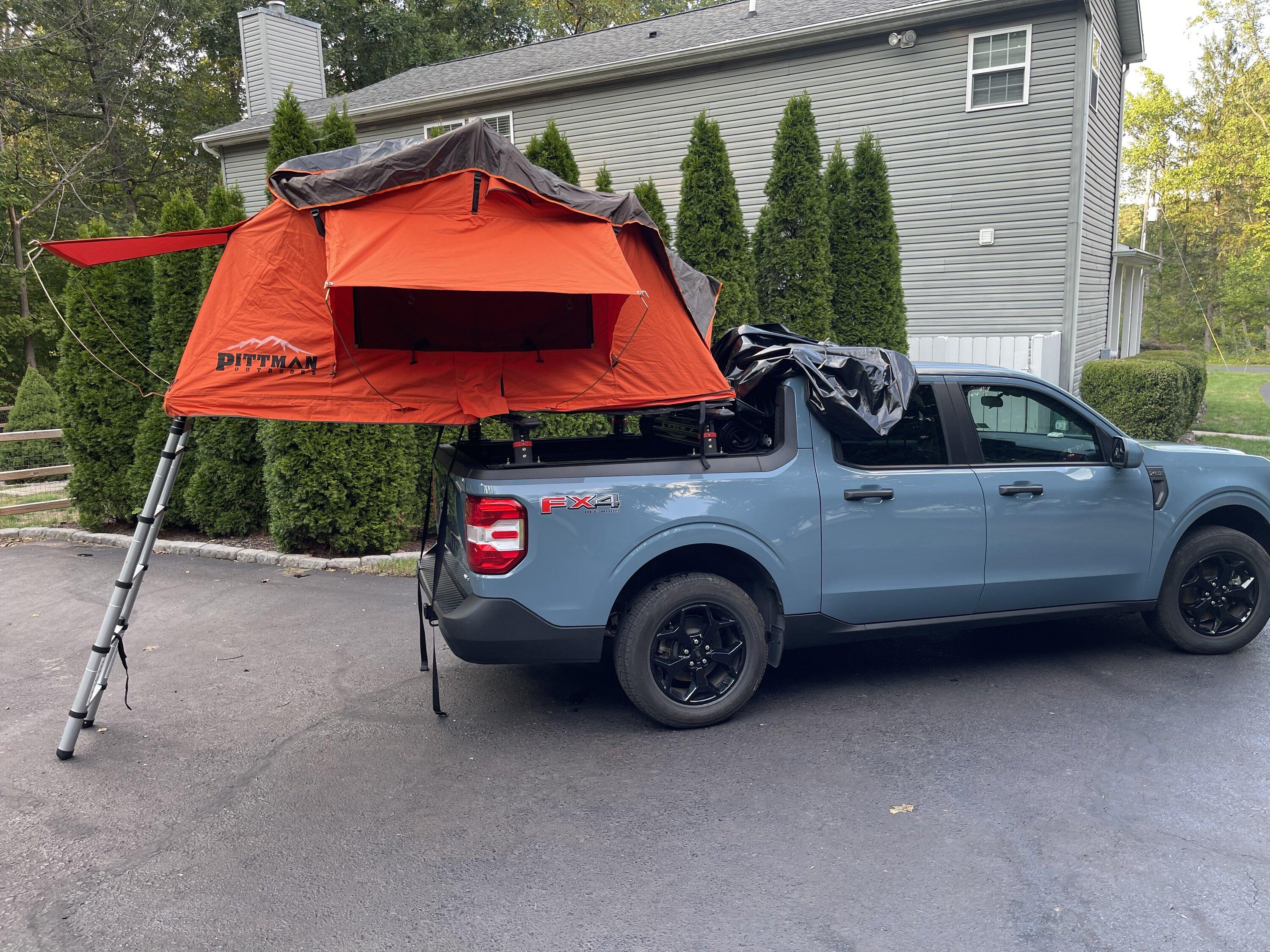

thought you guys might like these photos of my tent setup. Hard rollup cover still has enough room to roll under the cross bars.
Sweet, critter proof too.

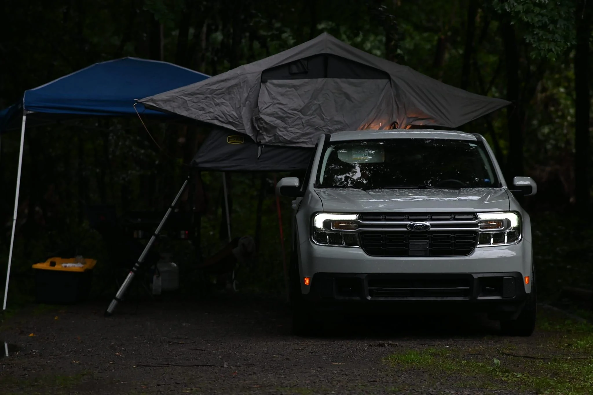

also nice not to have tent sitting in dirt. The campground I go to is nicely maintained but still just dirt where set up the tent. I was really thinking about getting one of these. that’s a nice set up right there. Thanks for posting the pics. Is it easy/fast to open and close?

Is the tent light enough for one person to be able to lift it up onto the rails as-needed and take it off when it's no longer needed?

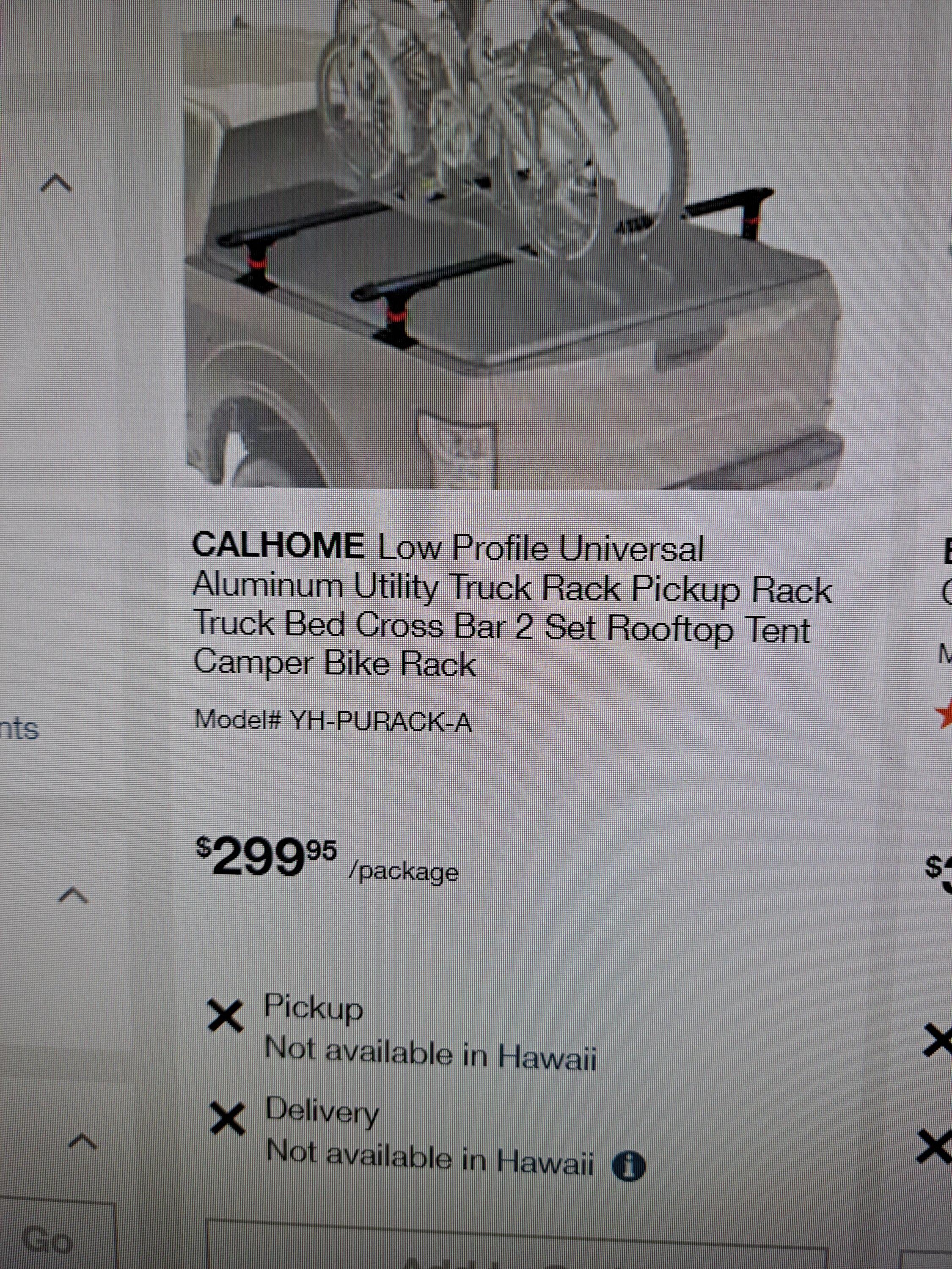

What Cross Bars are you running? Love the Look.
Somebody posted pictures Of cross bars from home depot for around $300.00 That looked like they would work perfect for this tent set up
