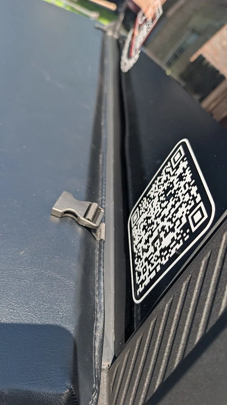

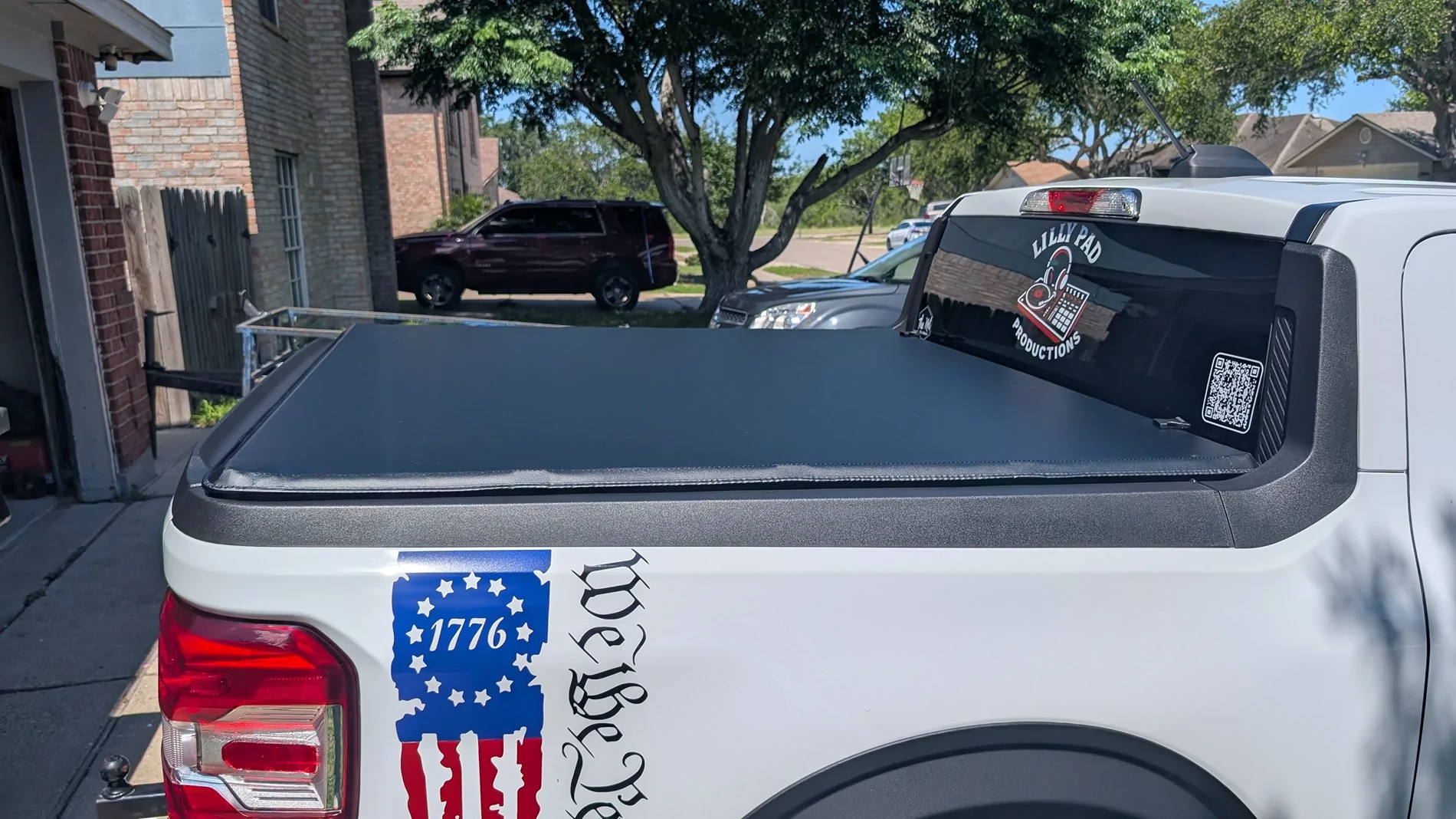

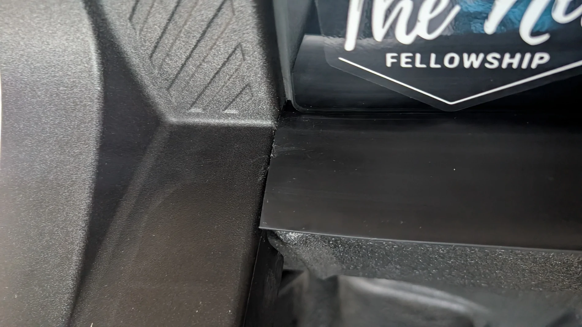

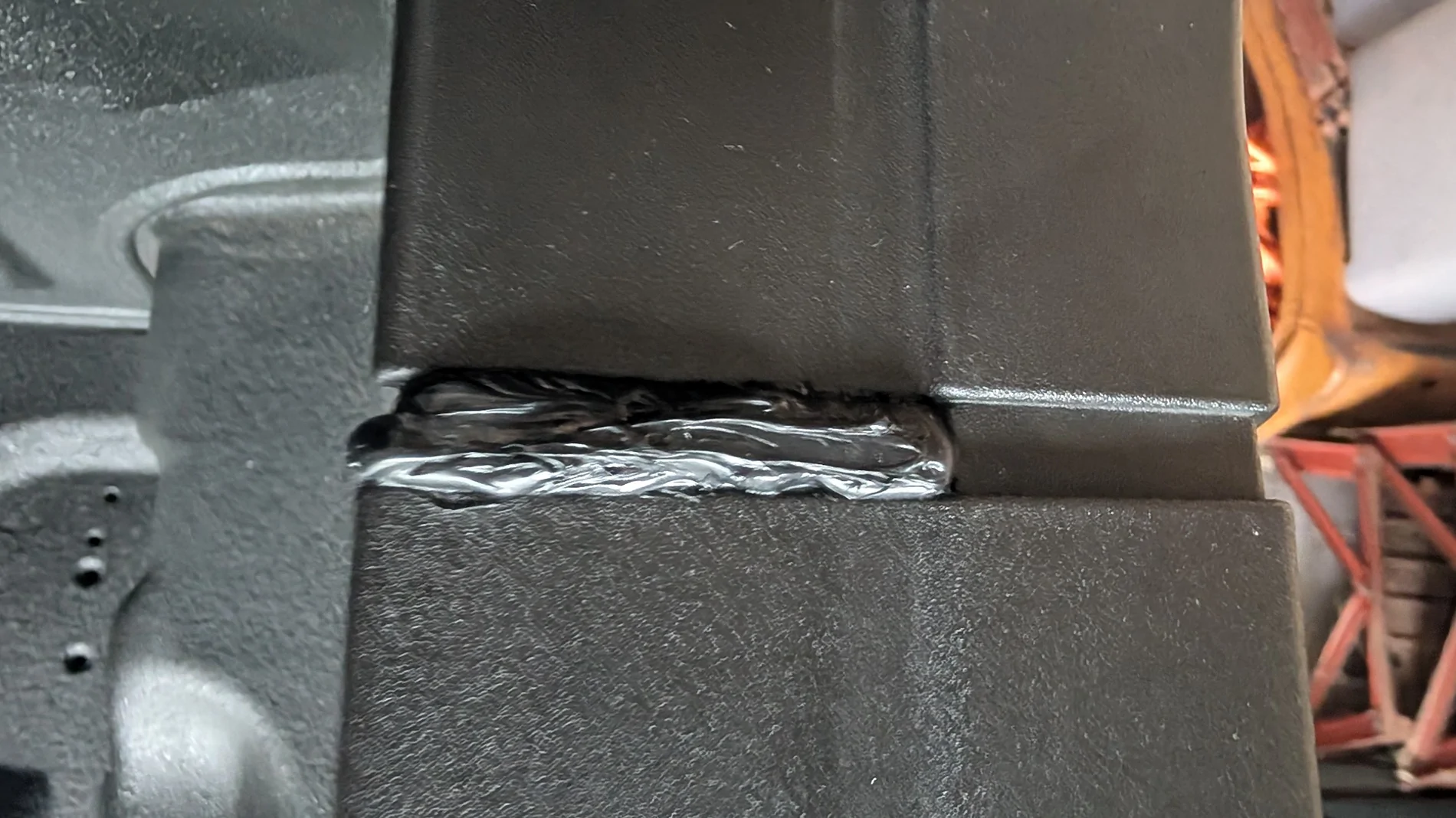

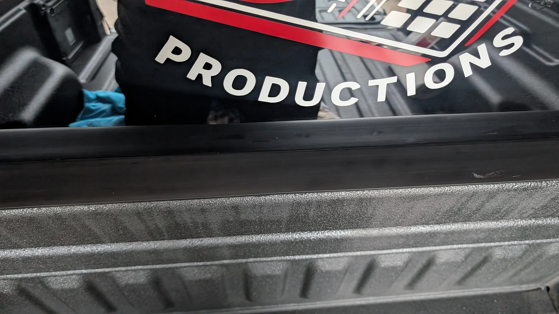

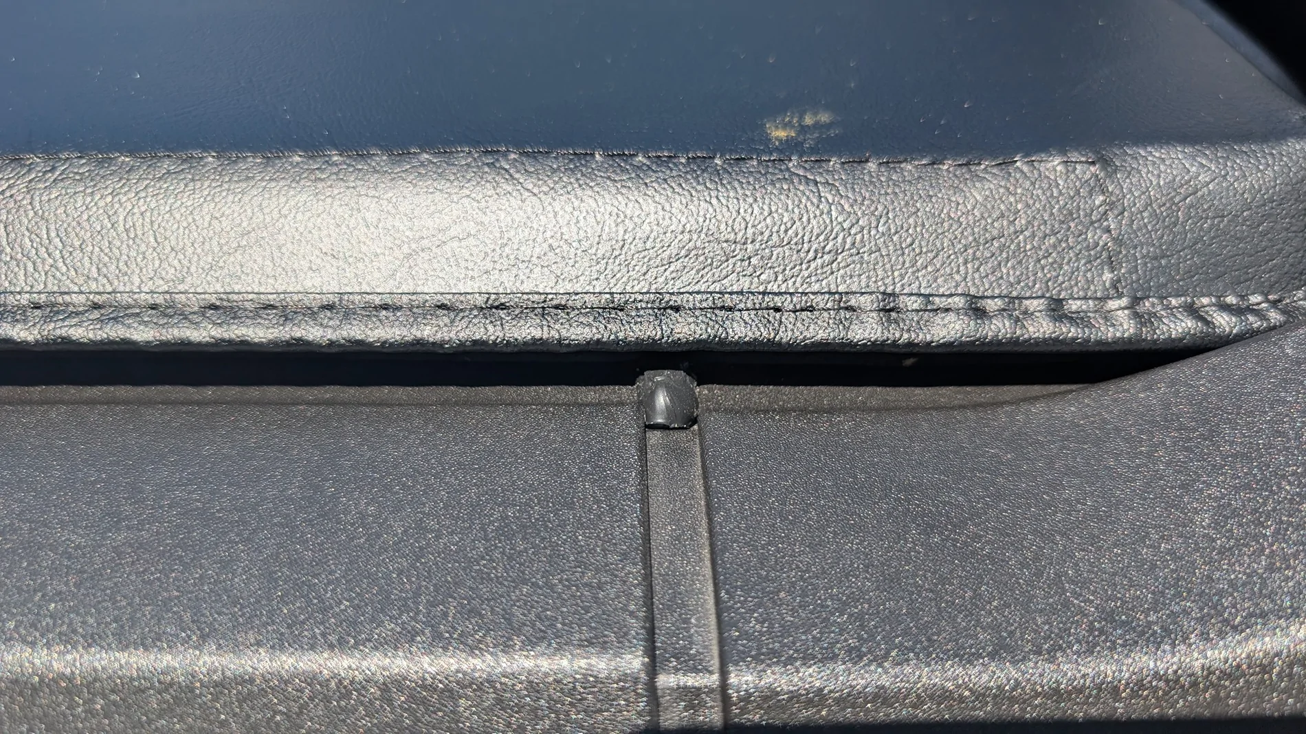

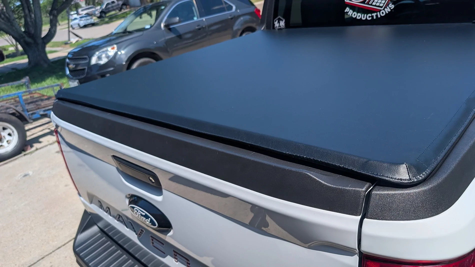

So I spent $165 on Amazon for this bed cover after trying 2 others. #1 this cover fits and seals better. #2 this cover isn't the most expensive soft roll up but not the cheapest either. #3 this cover has 3 bows and 6 clamps, very few do (most are 2 bows and 4 clamps). #4 I used rubber weather stripping on the rail at the back glass #5 I used black silicone at the joint of the plastic caps (this is removable easily, see pics, and other covers provide foam for this area) #6 other covers looked a little better honestly, but this one performs better #7 the buckles are sewn in a way they don't flop and hit the glass
I took it through the car wash this morning, no leaks at all! I'm debating a tailgate seal now to actually waterproof the bed. Once the cover settles I'll 3m tape the bows to the vinyl, and tighten the cover. Even like it is it doesn't vibrate much and we had gail force winds yesterday
Ford Maverick Tip Top Soft Roll Up Bed Cover installed PXL_20260503_200206768
