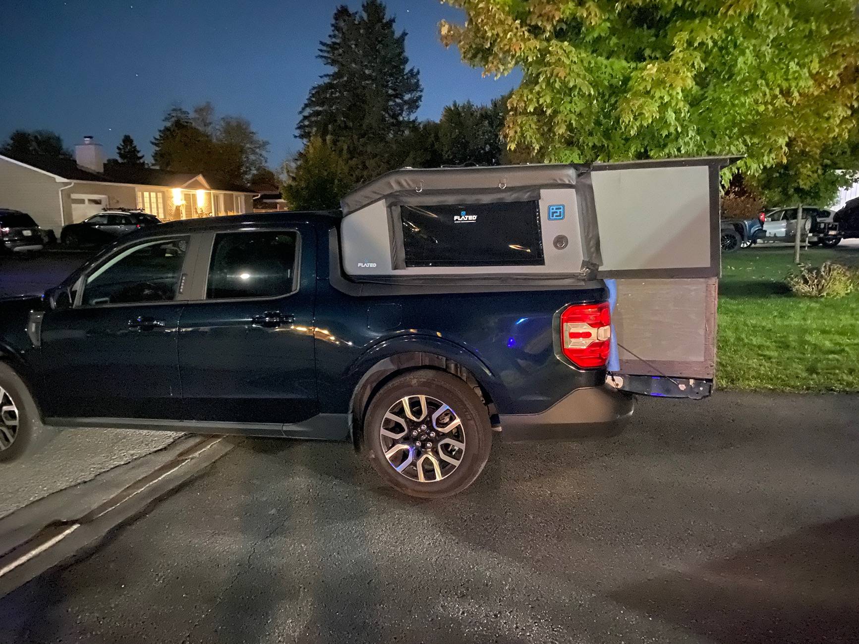

Thanks for the suggestions!!For water proofing the front hinges you could try long strips of rubber mat like you can get at HD. Sandwich it like a full length gasket but leave enough slack for the swing of the hinge. Then maybe a diversions strip of wood trim a few inches up the slope from the hinge. Some ideas there
I have some leftover pond liner material and Im thinking of attaching it permanently to one side of the hinge but using a solid strip of velcro on the other side. I want to be able to remove it in two separate pieces.
