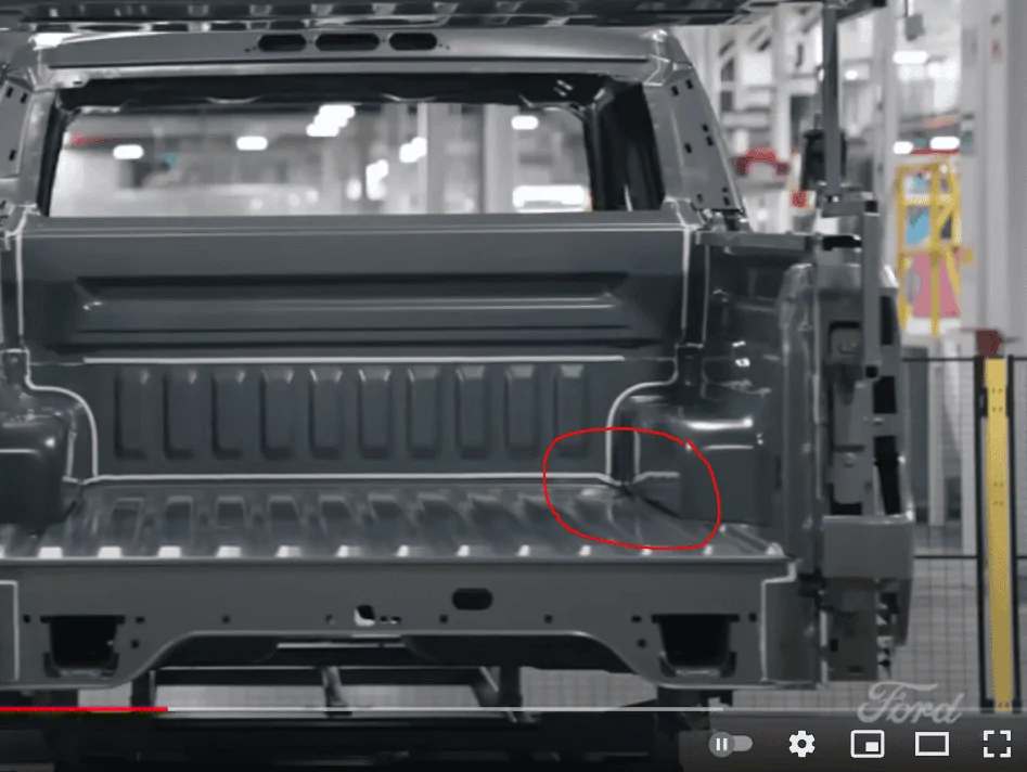

This should help:
at 3:27 min in the video where Ford is building a Maverick you will see the gap in the 2 panels -
it appears they don't fill that with calk. Don't know why but it seems normal production design element.
Ford Maverick Bed floor separation / gap from side of bed - normal or issue? Ford Production video - ga
