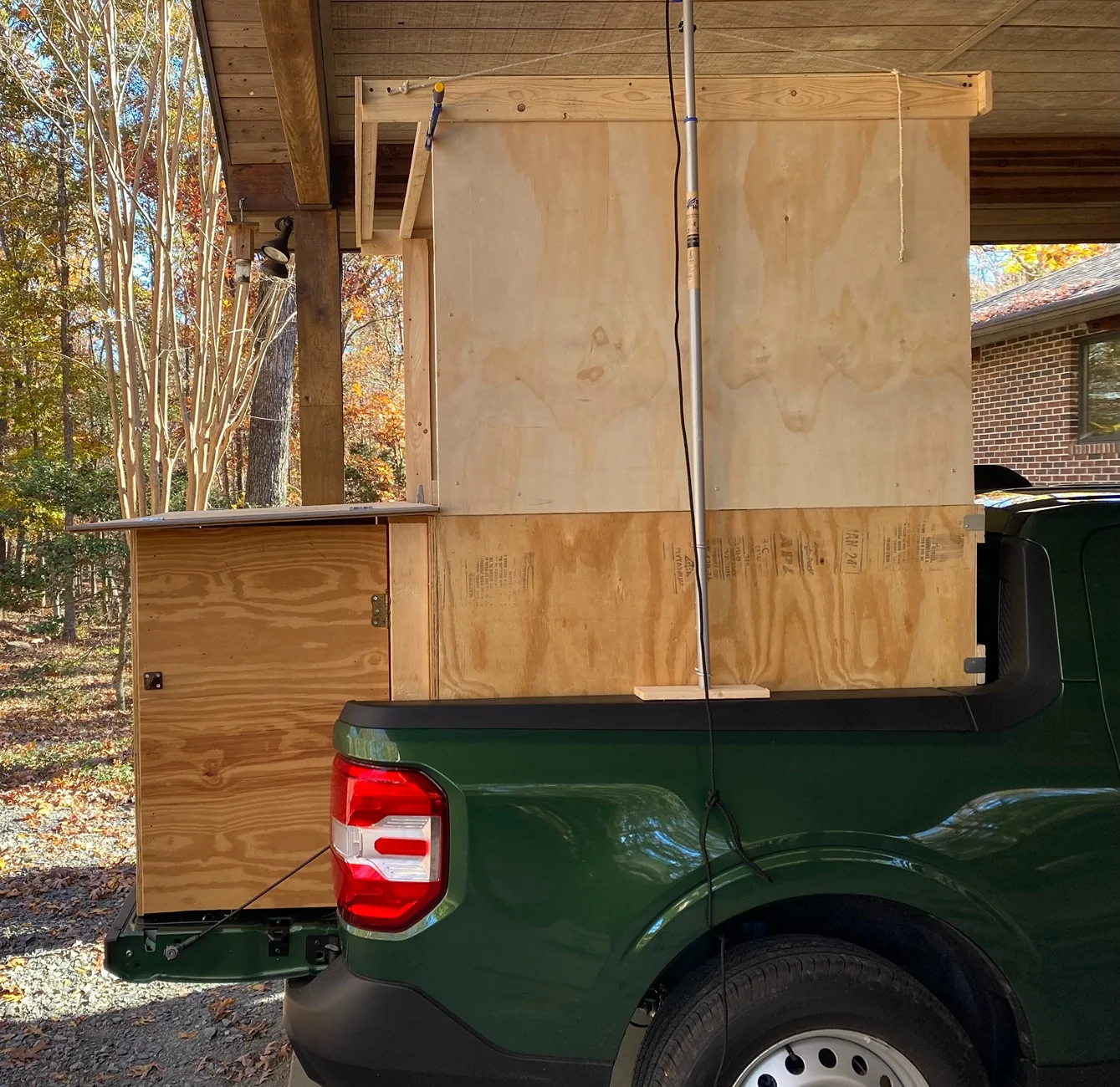

Coming from a guy that managed to make a roof top tent work inside the bed, I like what you have done. I like how it stays very close to the roof line and you can close the tail gate, and once it is set up, it seems very roomy. What I also like is that you seem to have plenty of space in it for camping gear while you are going down the road. That's the biggest drawback to my set-up, that there is not a lot of room remaining back there because the folded up roof top tent takes up so much room.
Thanks. The overall structure seems to work. Its the finishing details and the waterproofing that I have to figure out.

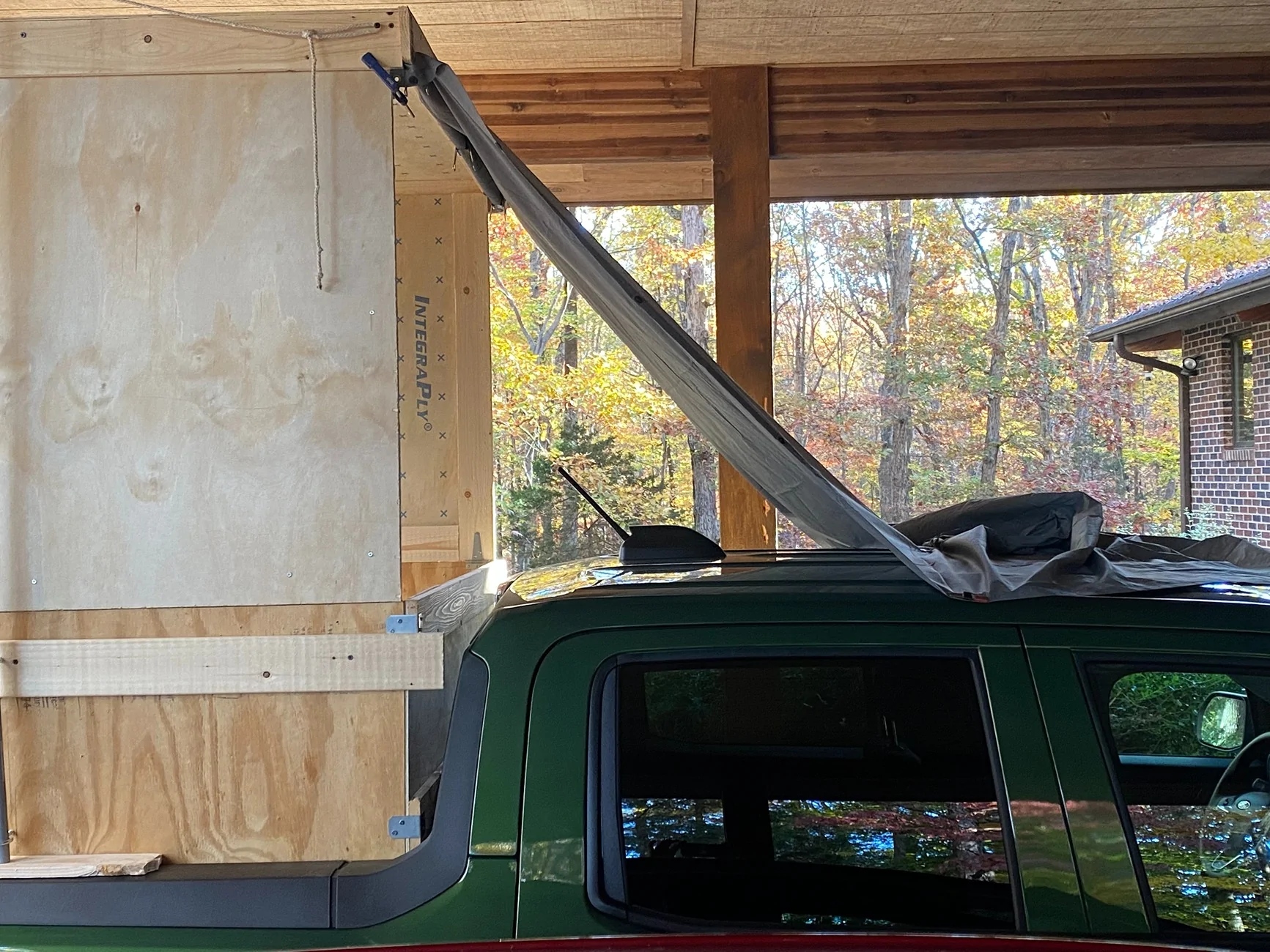

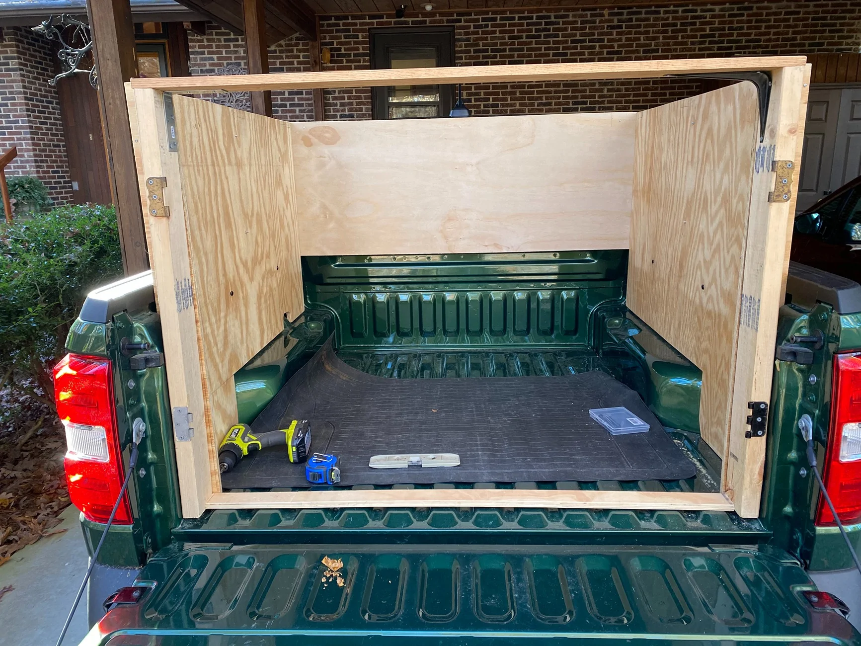

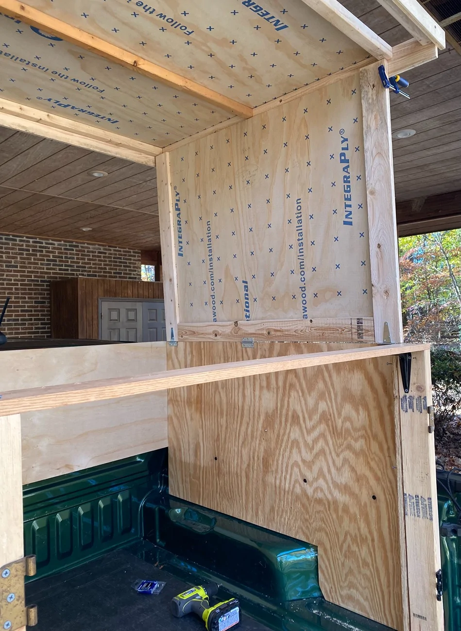

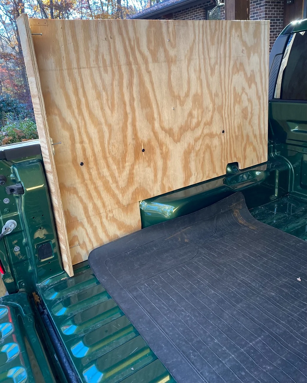

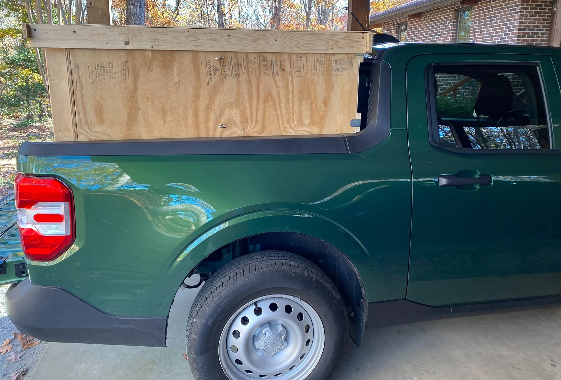

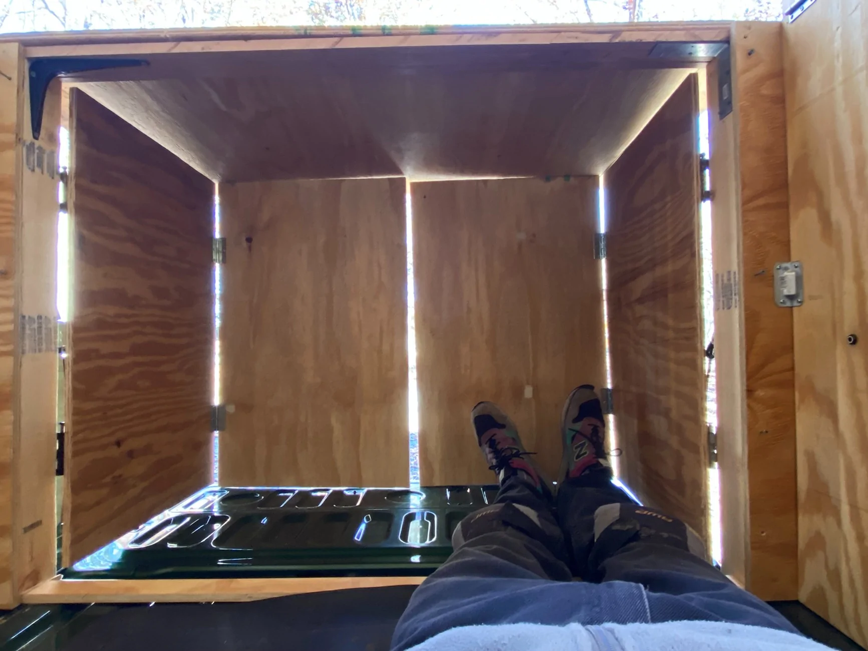

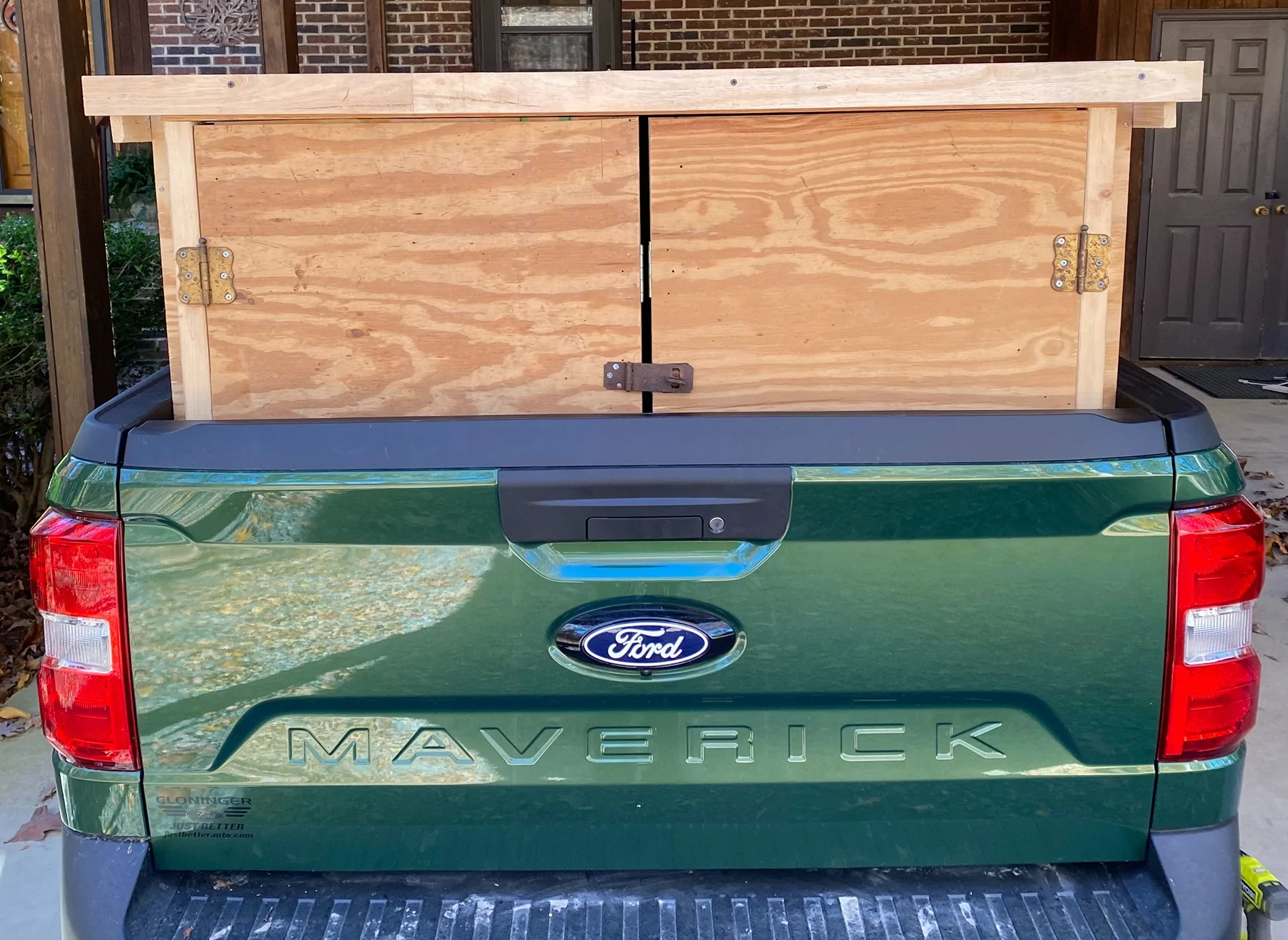

I’m posting a very rough prototype of a DIY camper. I hope others may find the ideas useful and, selfishly, hope some wise members will point out flaws or suggest improvements before I get too far in the build.

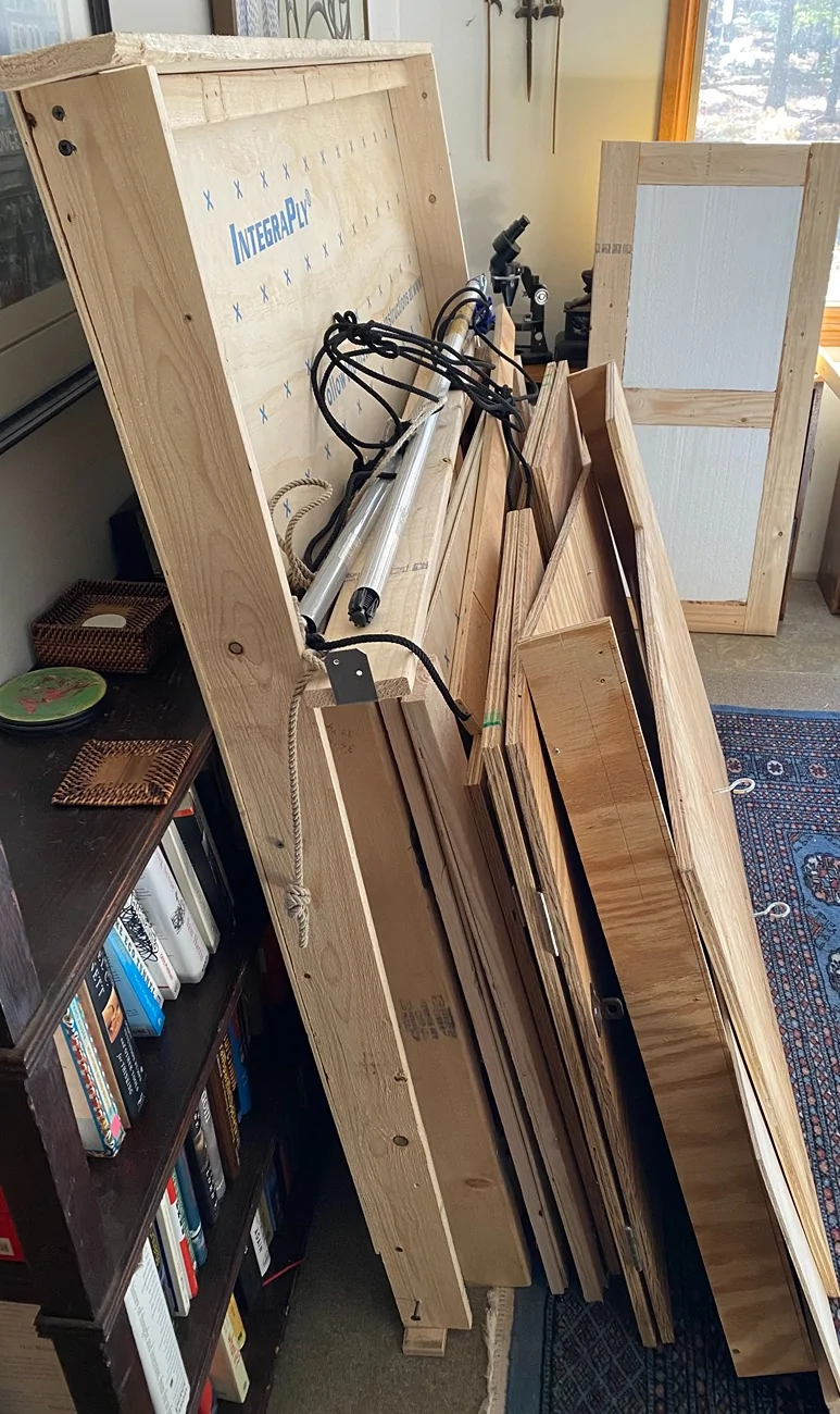

My main criteria are minimal mpg hit, able to stand up, sleep 2 snugly, and to disassemble for easy removal and storage. Since we are used to tent camping and usually perform most functions outside we do not need built in cooking or bathroom facilities. I plan to add windows to the upper side walls and fabric awnings above the cab and tail gate extension that will attach with magnets and Velcro.
The base of the build is two 5/8 plywood side pieces bolted to the very convenient holes in the bed rails. Everything else is hinged or screwed to these. I use double folding doors and a separate top for the tailgate sleeping extension. Currently I’m using locking pulleys mounted on poles to raise and lower the top. I may add gas struts but this system is pretty simple, if not elegant.
My major concern is the ability to handle rain. I plan to add a fabic tent like bathtub floor that attaches to the inner walls allowing rain to drain down the outsides and through the bed holes. Will also add weatherstripping and drip edges at joints.
Thanks for your thoughts.

If I decide to go forward much closer cuts, weatherstripping and possibly insulation are in order.
You are so right - I am incredibly fortunate to have the time and resources to put into something so frivolous. I have to work to keep the project in perspective and not have it crowd out more important if less “fun” things. Thanks for the encouragement and reminder.

Thanks. I think I will seal all cut edges with epoxy as well as the top and then paint everything with an exterior latex or acrylic paint. PMF would be better but sounds time consuming. Since this thing will live most of its life in a pile in my basement and likely be used outside on the truck infrequently I doubt I have to worry too much about durability or rot.
