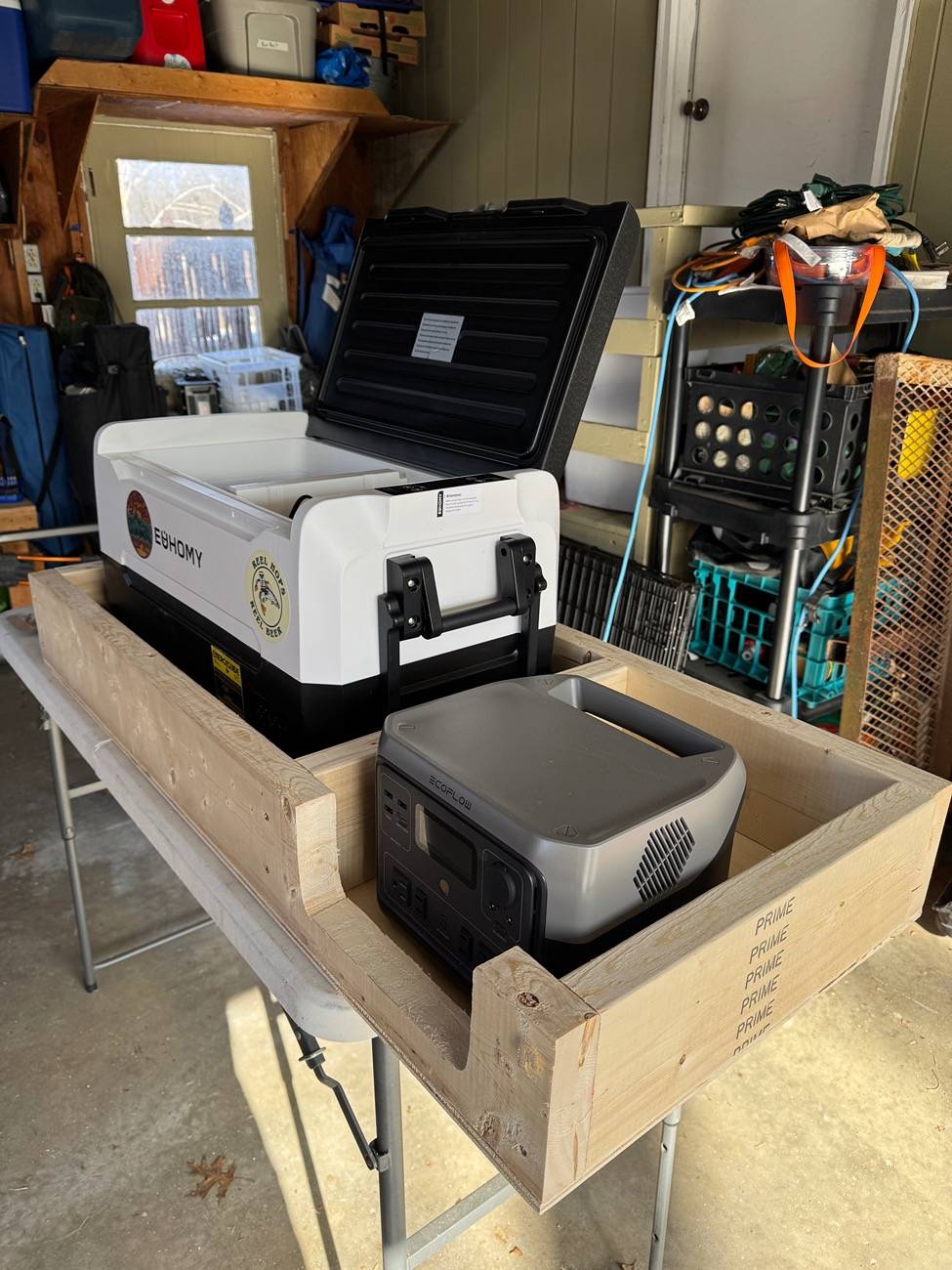

I took some time of this last weekend to build out a simple tray system for my 12v fridge and power station for when I take my Mav out for some road trips or camping. In short, I wanted a basic tray that would keep the fridge and power station together in the bed since they will be connected by power cords and allow me to easily slide it in and out for access. I didn't want to permanently mount anything yet as I am not sure I want to keep this exact configuration and I also plan to occasionally use the bed for other things so this will need to easily be removed when it is not needed.

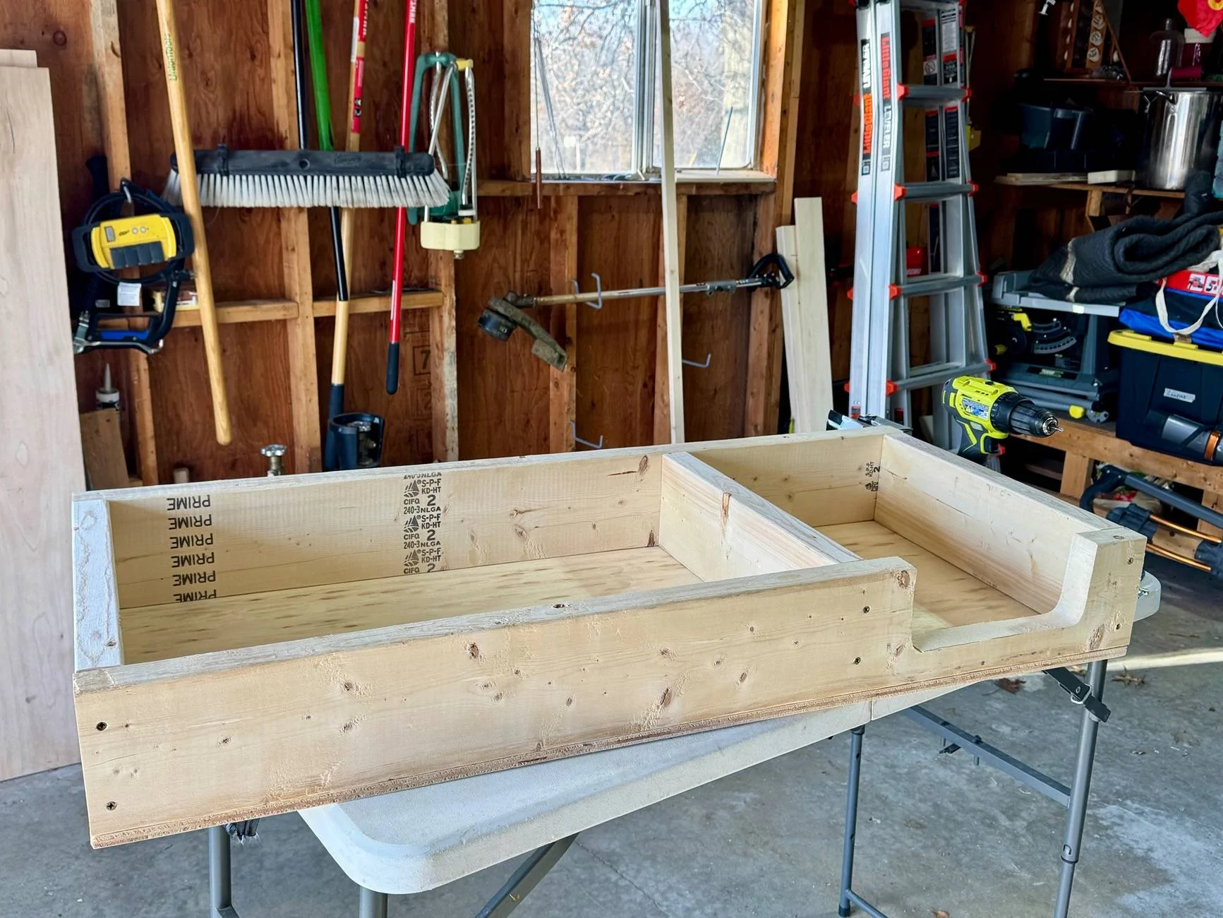

I used some 1/2" plywood as the bottom and 2x6 board as the sides. I opted for 2x6 to have extra height when I might use the tray to carry other things, such as my water jugs for homebrewing but otherwise, 2x4 probably would have gotten the job done just as well with less overall weight. I did have to cut a notch in the 2x6 so that I could easily access the front of the power station which is where the power button and various power ports are. I used a folding handle on the front as my pull/push handle and two screen door handles as tie-down points to secure the fridge while in transit.

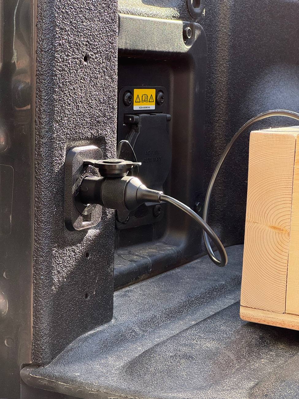

The basic power flow on this setup is: 12v Power Port from the Flex Bed -> Power Station -> 12v Fridge. This allows the fridge to run even while the truck is off while parked and I can recharge the power station while driving. Big thanks to @Maverick_Innovation_Designs for the Plug-andPlay 12v adapter which made that part of the project super simple!
It's super cold here in the Midwest right now and my only workspace is in the garage so I am still waiting to paint and seal the tray but I will update this thread once that is done!

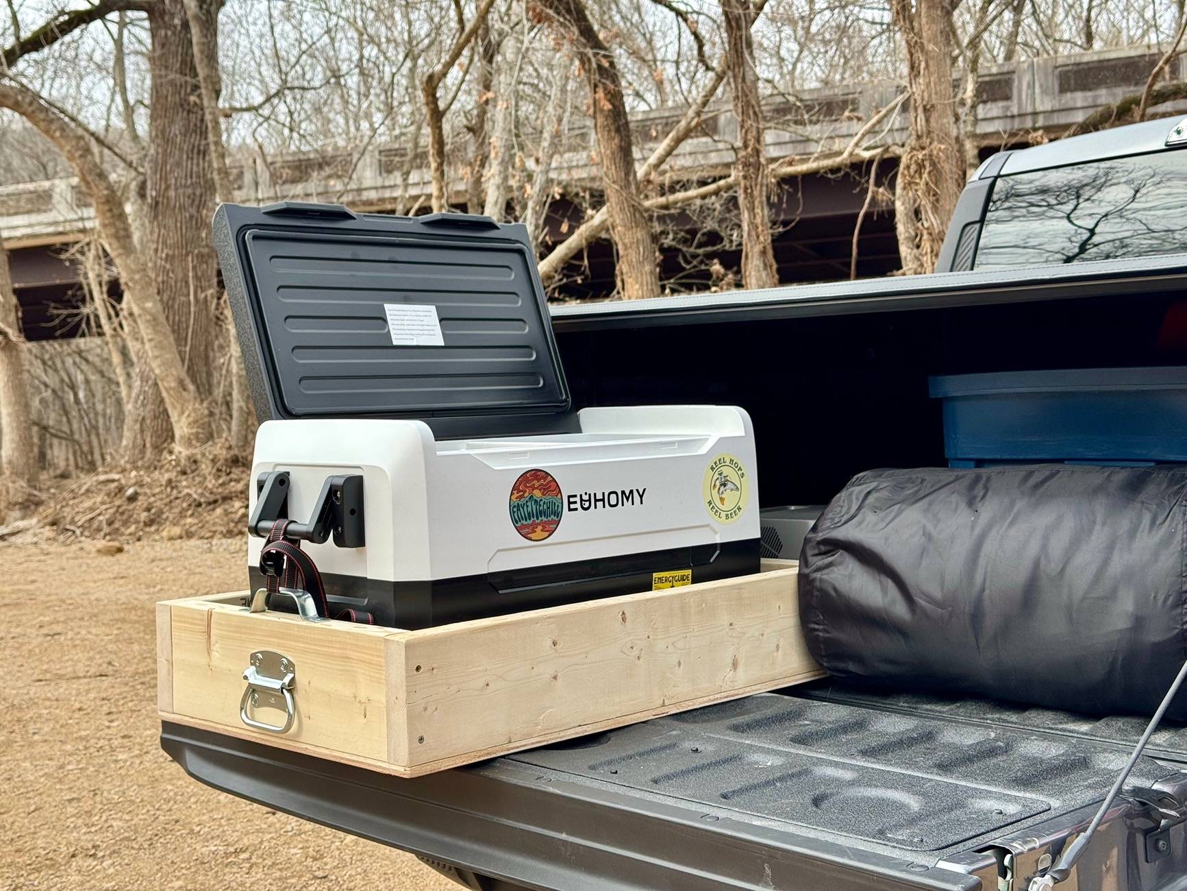

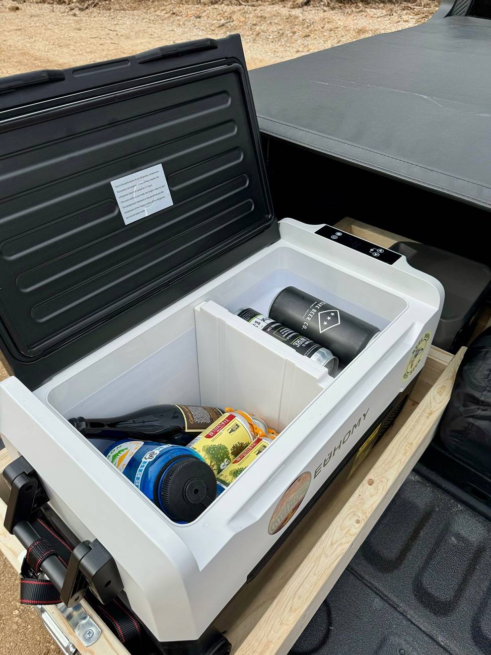

Took my tray set up for an initial shakedown trip this last weekend! A friend and I did some cold weather camping in Northwest Arkansas and while we didn’t utilize the fridge to its full potential we did use it to keep water and sodas cold on the way down and keep our souvenir beer chilled on the way back home!
Obviously in cold weather, the fridge didn’t have much of a challenge. It held temps just fine and the battery rarely dipped below 60% and was charged up quickly by the FlexBed 12v power.
Good Notes:
  • The tray did not slide around in the bed while driving. Had concerns of this for tight cornering and accelerating but it stayed put!
  • It was easy enough to pull out if the bed when needed and push back in for storage. Mission accomplished! Still might consider adding pads or something to the base to make it a bit less effort to slide in and out.

  • The 12v plug for the power station isn’t super secure and it sticks out like a sore thumb so I worry about it getting damaged at some point. I may have to reach out to @Maverick_Innovation_Designs and see if I could get a version of the Plug and Play adapter with an XT60 plug and try to find a XT60 cord with a 90 degree connected to make that power connection more low profile. USB-C may also be a decent option but I’d want to doublecheck wattage.

One of the main things I wanted to do was recessed/sub-flush connectors. It's difficult to do with the cigarette sockets since they are the same size or just slightly larger than the actual cutout. XT60 should definitely be doable, I'll order some of the panel mounts and see what I can do.
